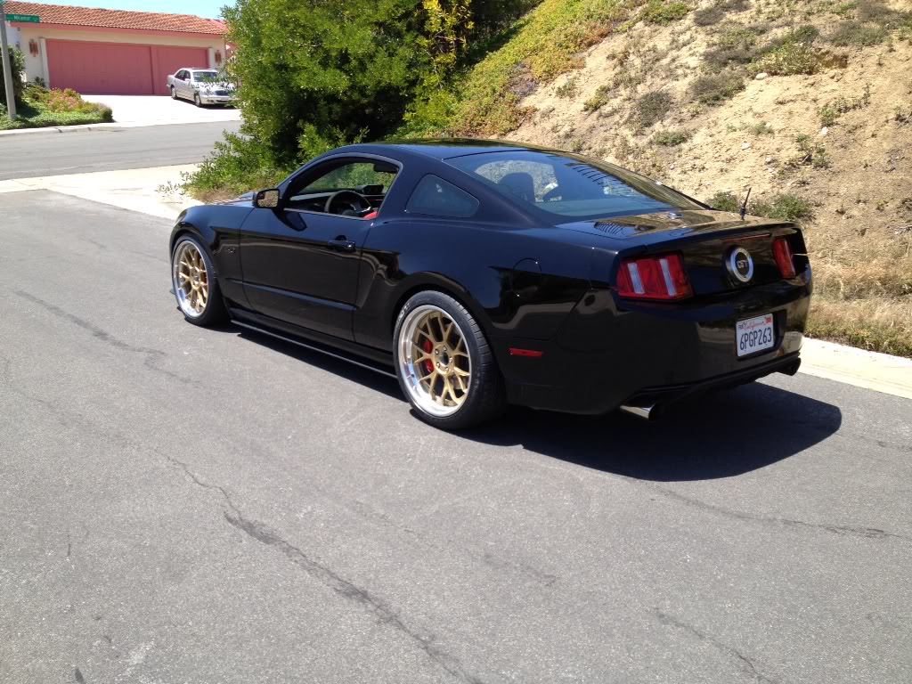

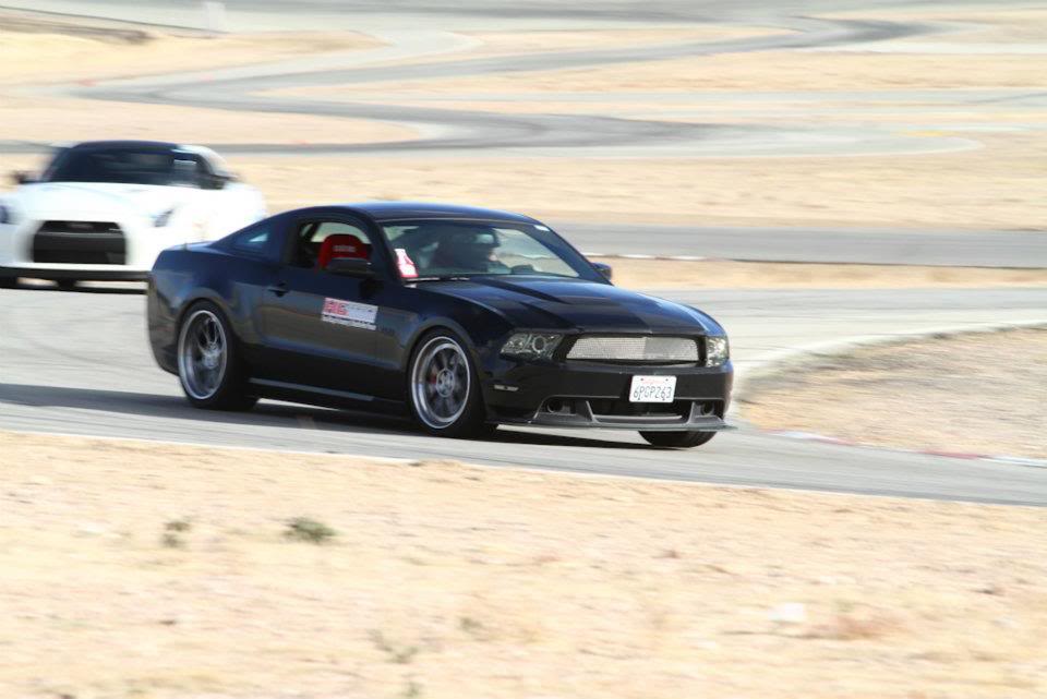

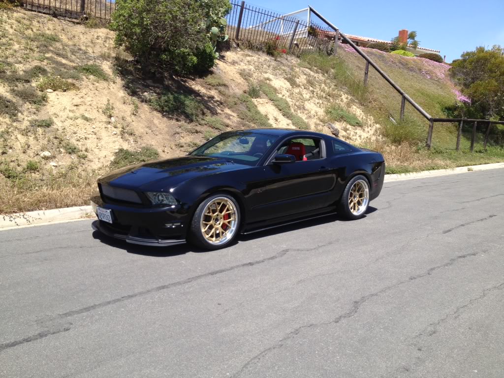

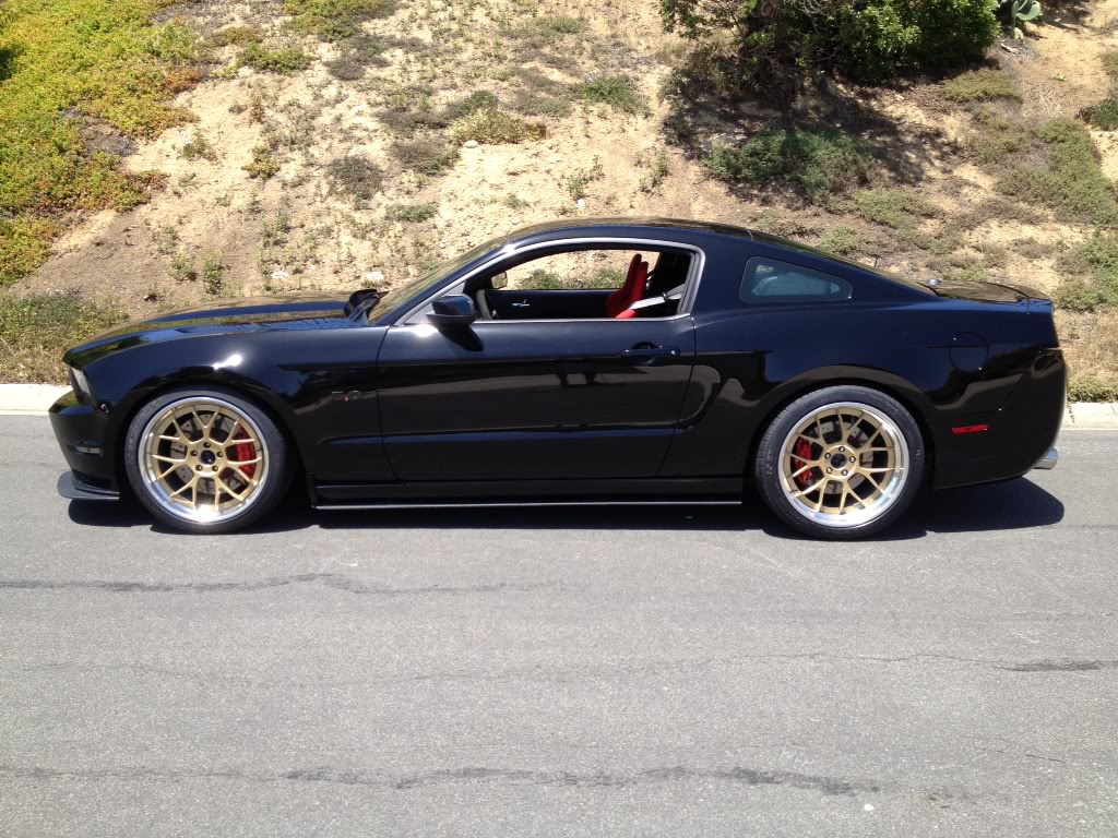

Hi PorscheAudi,
I have a 2011 Mustang GT with about every suspension part you can get for the car and I just wanted to give you my input. My car is setup perfect right now and it handles amazing. Here is a list of my suspension mods'
Suspension:
KW Varient 3 Coilovers
Maximum Motorsports Camber Plates
Maximum Motorsports Heavy Duty Rear Lower Control Arms
Steeda Adj. Competition Upper 3rd Link (pinion angle set at -2)
Fays2 Watts Link ( roll center set to lowest setting due to new front control arms)
Kenny Brown "GT 4" Front Control Arms
Strano Front and Rear Swaybars w/ Heavy Duty adj. Endlinks
Corner balanced and cross weight set
Brakes:
AP Racing 6 Pot 14.25" Front Brake Kit
AP Racing 4 Pot 13.5" Rear Brake Kit
Stainless Steel Brake Lines
Carbotech XP8 pads
Ford Racing brake duct kit
Drivetrain:
Stock 3.73 gears
Boss 302 Torsen LSD
DSS 1 piece aluminum driveshaft
MGW Shifter (a must have!)
And Maximum Motorsport 4 point roll bar.
Here is my car as it is set up now. Sorry for the iPhone pics.

I think the those Eibach R2's are a good choice. I have heard great things about them in the Evo community. If I were to do it again, I would try the new AST 4150 or 4250 offered from Vorshlag and their new camber plates. Check out their blog:
Vorshlag Blog | BMW, Misubishi, Subaru Racing Events, Tech Talk, Parts Specials and more!
As far as other suspension pieces, I would go all Kenny Brown:
Sport/Comp AGS 4.0 GT-4 Suspension for 2010-2012 Shelby GT500 and Boss 302 Mustang | Shop Kenny Brown
And of course i would stick with the Fays2 Watts Link instead of the Panhard bar. Let me know if you have any questions and I would be happy to help.

Originally Posted by Tay
wow...that`s a great setup!!
well done man!
