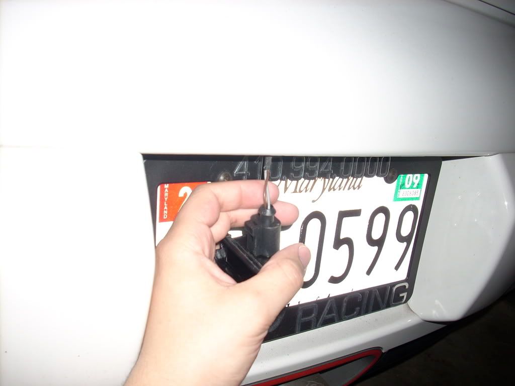

First remove the license plate housing screws...

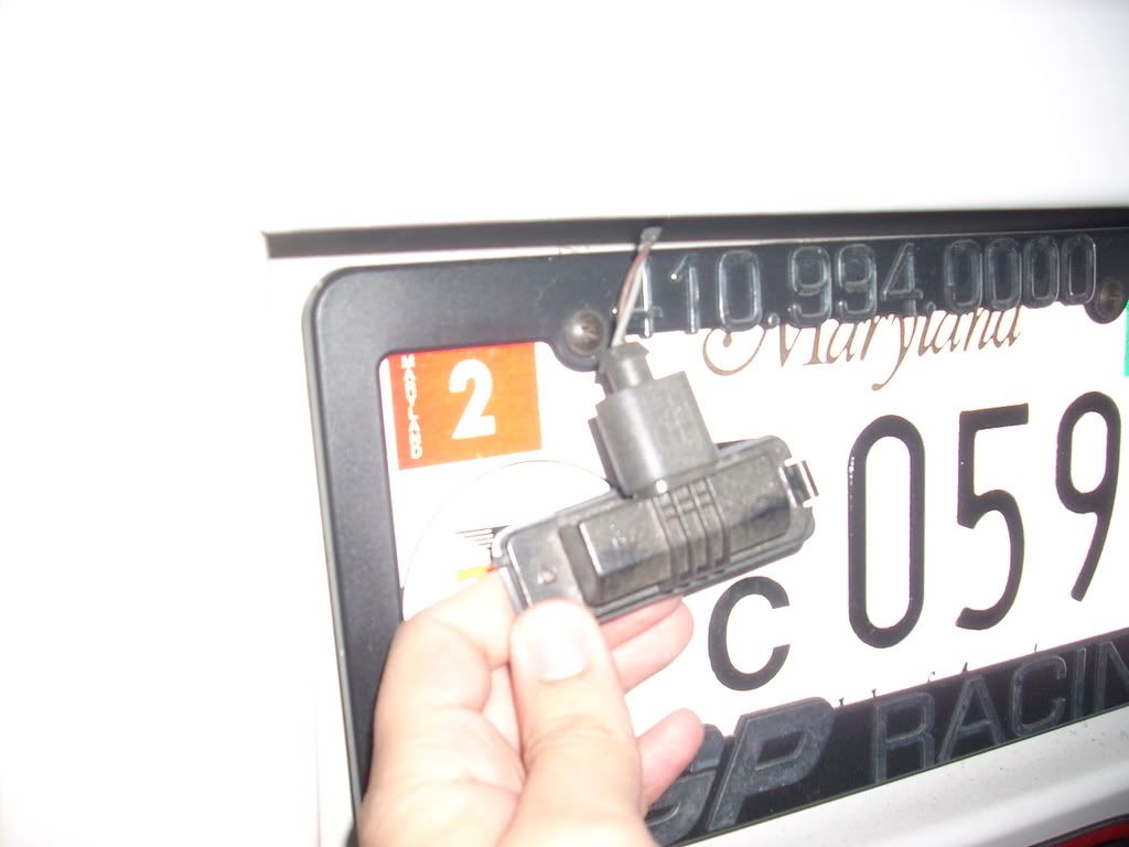

take out the housing part which holds the bulb, this should pop off easily...

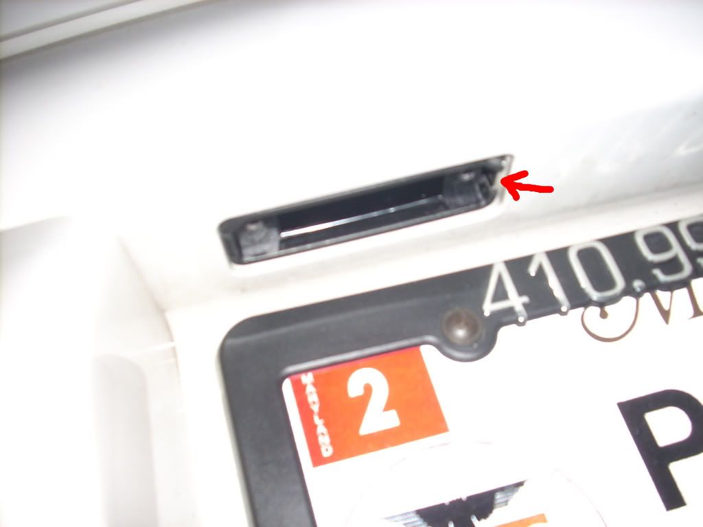

now using a small flat head screwdriver, carefully push the tab to the left while pulling it down with the flathead screwdriver...

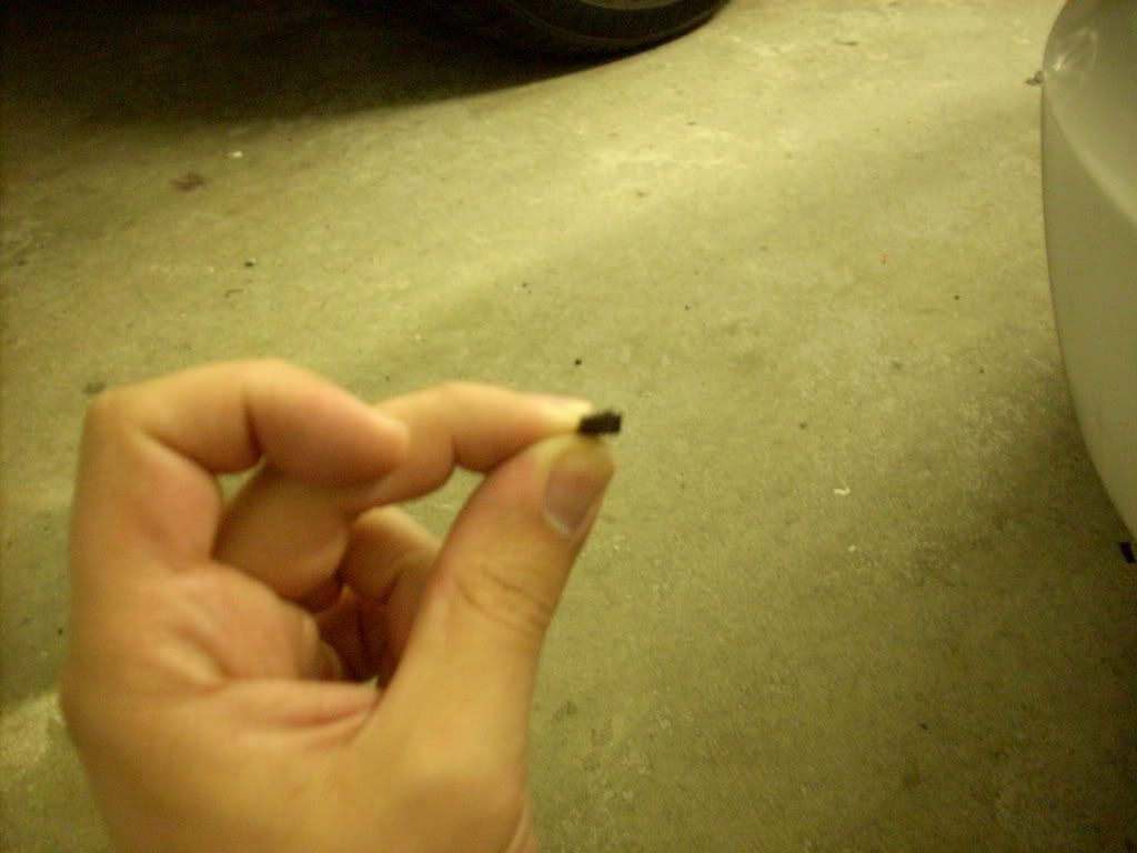

be careful, I broke the tab this is a very hard plastic and is not very flexible...
now that you have pulled it out you have exposed the wires...
