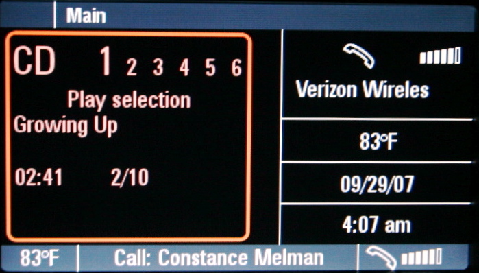

NAV-TV Bluetooth Adapter for 997
From JFR in Texas:
I have just had a "Release Candidate" prototype Bluetooth adapter from NAV-TV installed in my 07 C2S. It connects into the MOST ring just as do the NAV-TV iPod adapter and Sirius satellite radio adapter that I previously had installed. The Bluetooth adapter allows control of a Bluetooth cell phone via the PCM's buttons and knobs, including initiating and answering calls using the "lift handset" button at the upper left of the PCM, hanging up via the "end call" button just to the right of that, dialing calls via the PCM numeric keypad, syncing the cell phone's phonebook such that it is accessible through the PCM, making calls from the synced phonebook, displaying incoming caller information on the PCM screen, muting the radio or CD during calls, etc. Call quality is excellent, as is the sound through the car's main speaker system.
The only flaw I have found with my adapter's software version is that it doesn't sync the cell phone's entire phonebook, just the first 60 or so entries. NAV-TV has just shipped me an updated adapter based on my feedback which should correct this one issue. I have paired both an iPhone and a Blackberry 8700 with the NAV-TV adapter with no other issues than the partial phonebook transfer. When I get the new adapter installed next week, I'll post whether or not it has cured this problem.
NAV-TV tells me the final version of the adapter should be ready for formal release through retail channels within the next month.
I had my Bluetooth adapter, as well as my satellite radio adapter and iPod adapter, installed by Custom Car Stereo in Houston, who did their usual excellent job. The Bluetooth adapter installation took well less than an hour.
