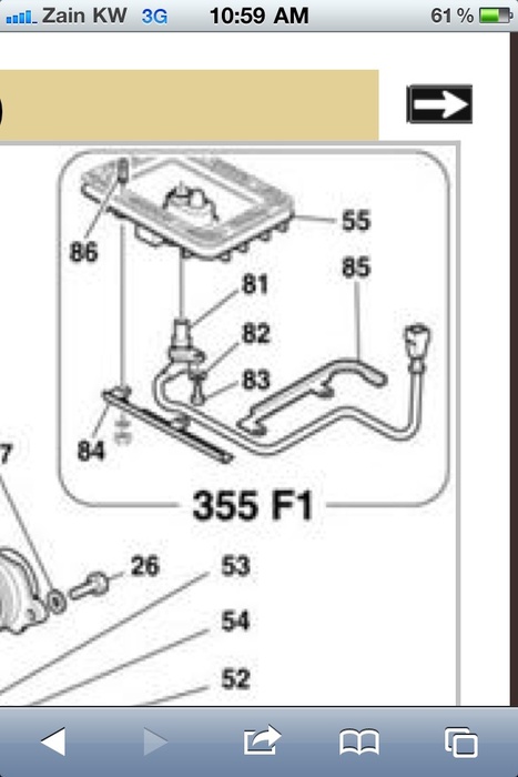

at the AD shop now
needs: tranny oil change + gearbox rpm sensor (electromagnetic sensor)
$243 part at ricambi
dealer quoted me $1.55k (inc tranny oil change) inc labour obviously
lol <- all i can say
waiting for the mechanic to come back from a road test and see what this will do.. sure, this will get the car to engage 1st on the new pump, but what then? about the flashing when car heats up?
we shall wait and see. no option but to go with AD at this point. approve the 1.5k and hope for the best.
if it does the deed, i will have no regrets
updates to come
Old Aug 25, 2011 | 04:10 AM
  #45
boursachi's Avatar
Posts: 2,770
part referred to is no. 81 on attached pic
