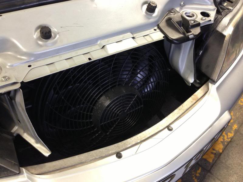

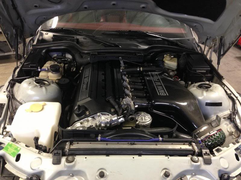

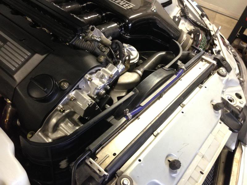

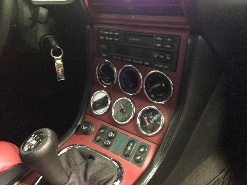

After a a long break, here's a little update,
Replacing the valves cured the noise problem but the idle was still problematic so we calibrated the individual throttle bodies. As it turns out while we dismantled it to clean throughly we over tighten some of the springs so they were not opening evenly hence the rough idle. After a little fine tuning she ran like a champ.
Here is a short video of the first start -up,
Then we started reassembling some of the new parts like water bottle, radiator heat shields, o2 sensors, additional fan, bits of interior (center console etc.)

airbox in all its glory

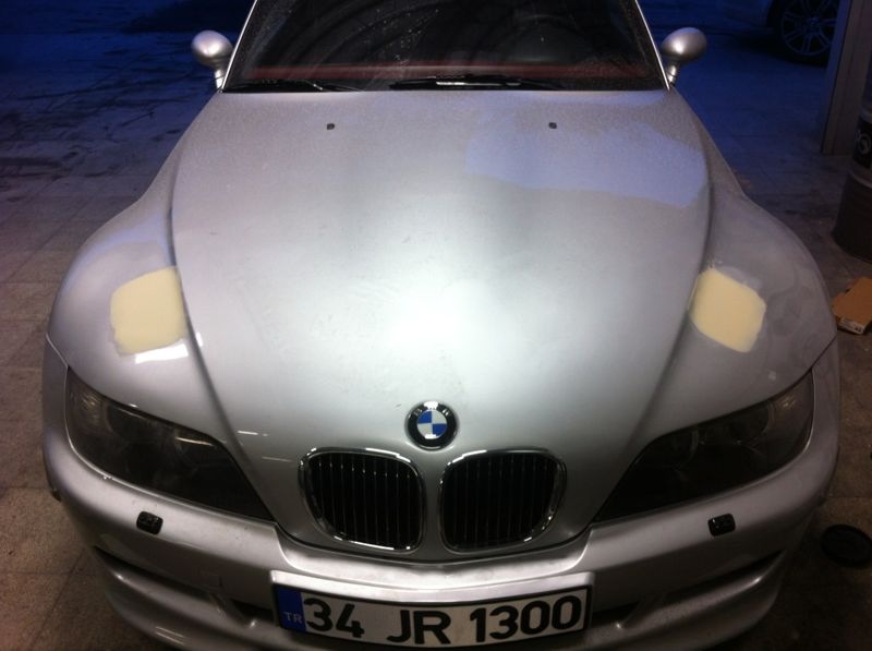

Later on, we moved on to closing of the disastrous holes of the hood pins. The holes are filled before paint.
,Name:  foto11F0raf_zps202810ea.jpg
