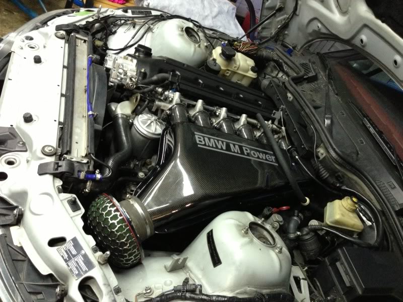

A small update. We went with HKS type solution for the air filter until we come up with something neater and more effective.
Here's are recent shots of the engine with the airbox and custom lettering applied. (Disregard the blue piping. They will be replaced before we finish things off.)

Tomorrow, we'll do the ECU tuning for the airbox and try our first start up.Fingers crossed !

That airbox looks fantastic! I would think that AFE or similar might have a small cone filter that would fit - how much room do you have in that spot?
I could hardly fit the HKS filter but will look into AFE now that you mentioned it. I really don't like how the green hks gives the engine a boy racer look

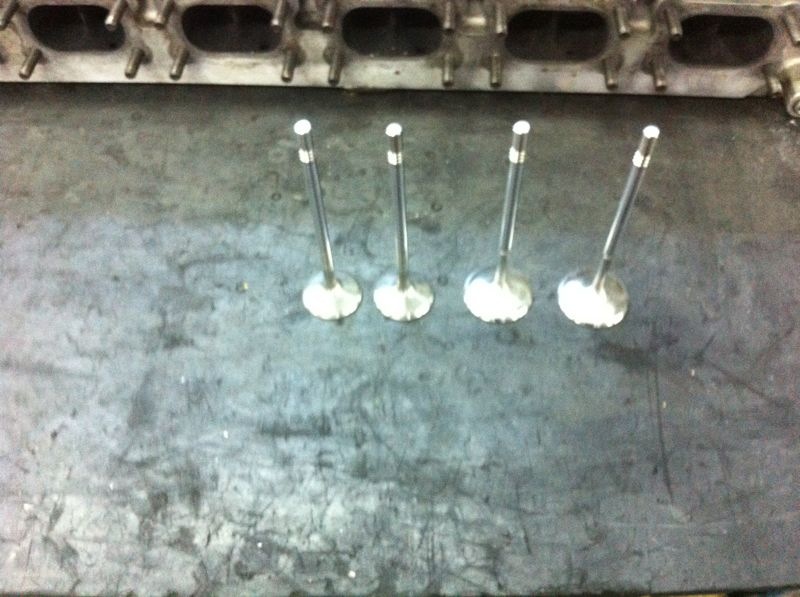

Here are some of the new cylinder valves,

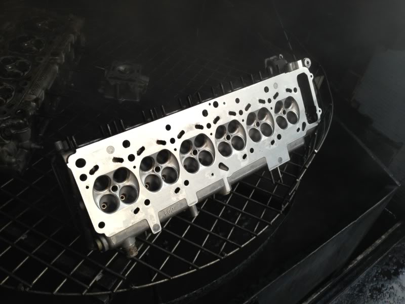

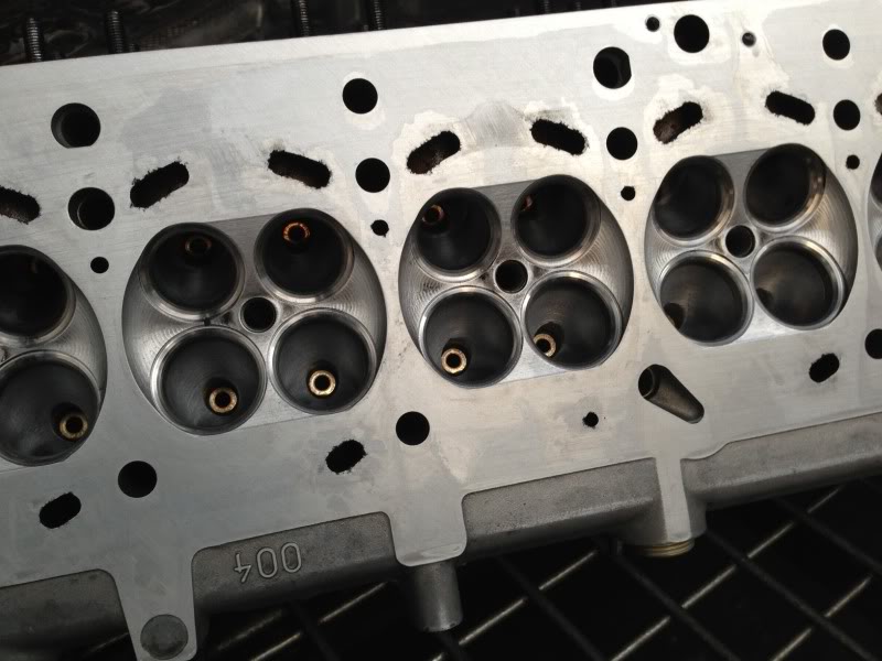

And the cylinder head polished, blueprinted and cleaned,
New valve sleeves mounted,
