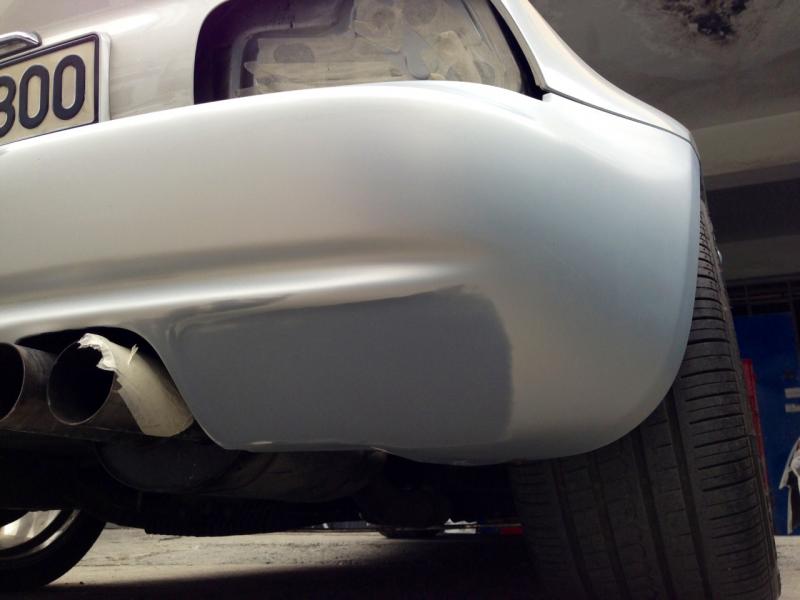

Now that most of the engine and mechanical stuff out of the way, we switched back to cosmetic part. The bonnet and bumpers are getting ready for clean-up paint.
Holes from the hood clips filled and primed,
The holes for the hamann aero parts on the rear bumper filled and primed,
Licence plate holes filled and bumper fully primed,

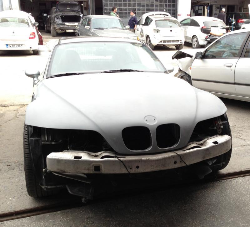

Today the car got out of paint shop, the paint is flawless and the hood looks 10x better without ricer hood pins. Smooth front bumper without licence plate also adds to the clean look. I am very happy with the results. Before paint shots, we took care of tiny details again

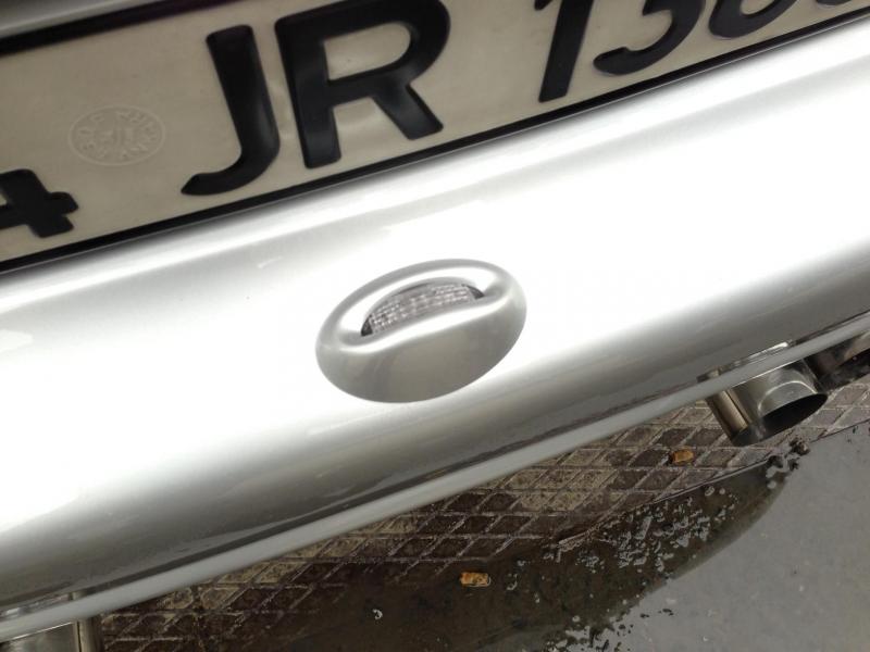

Finally replaced the number plate light as it was also pretty discolored and dirty,
Old vs. new,
New one put in, much better,

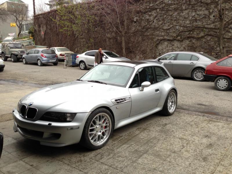

After these little youth touches, she looked much younger
Now that majority of the work is done (engine rebuild, paint, mechanics etc.), it is time for the interior. Tomorrow, I'll drop it to my upholstery guy for a little freshen up and some personal touches We're almost there. Keep watching ...

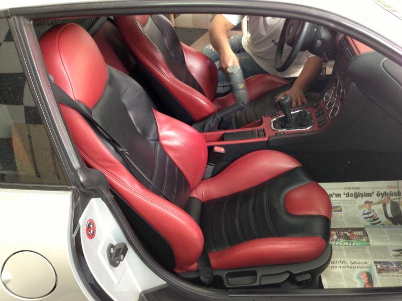

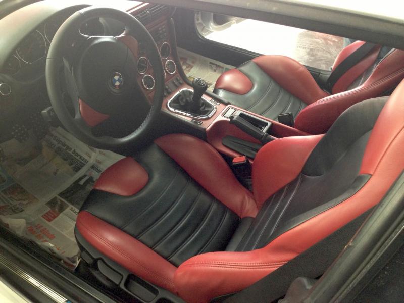

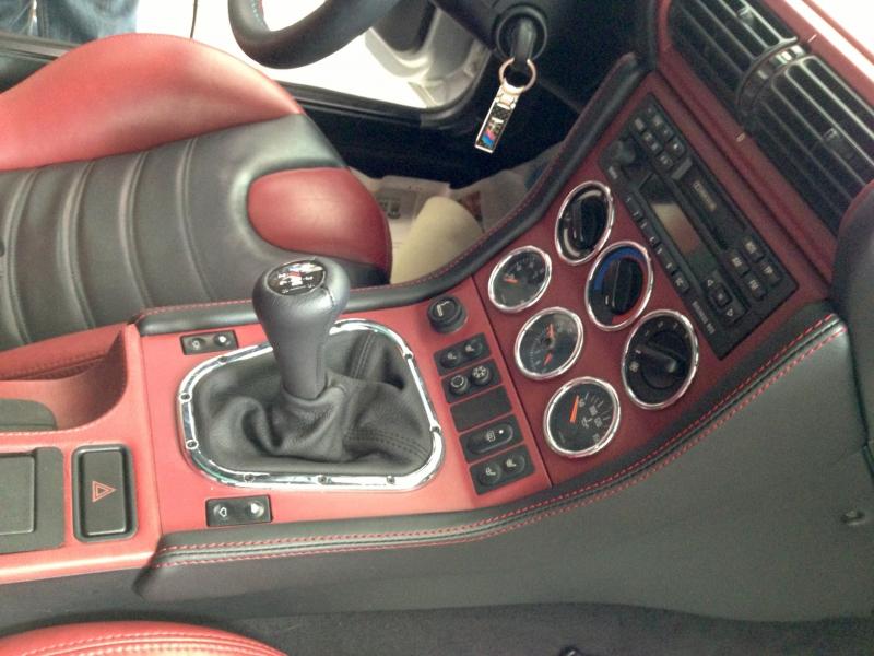

Just got the car back from my upholstery guy. He used his usual tricks and skills to liven up the interior. Instead of retrimming in the interior with new leather and such, we went for restoration route.
First, the seats were switched (left to right) so that the entrance bolster were hidden on the other side, then the worn padding got renewed with firm, fresh ones to give extra bit of tight look. Then they were warmed up and weted back to back for a few times. This makes the loose leather stretch back to its original form. Lastly they were washed. Here are the results,
During washing,
Finished look,

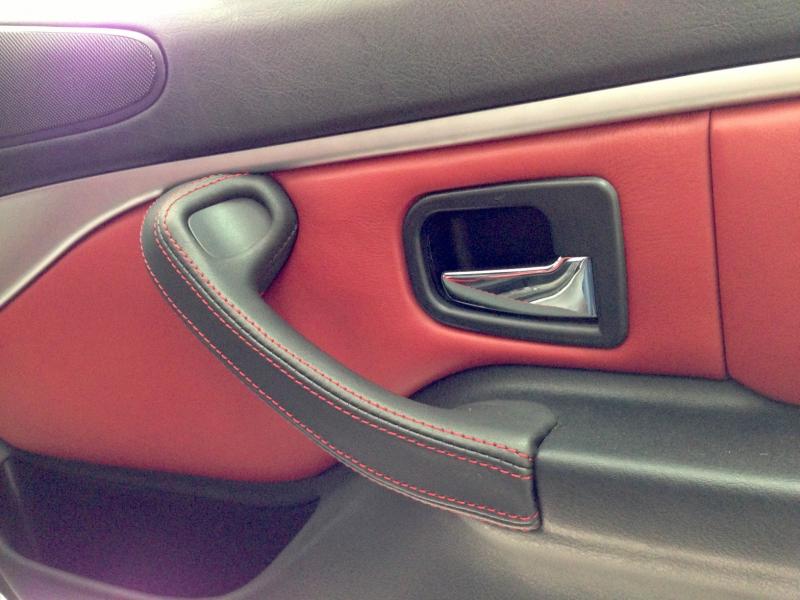

Once the rest finished, then came turn for my little personal touches. To keep the black and red theme, I contrast stitched the door grab and center console sides.
Door Grabs,
and the center console sides,
Finally matt painted the airbag, as it was very shiny. Not very clear in this picture but the result is very good.
Overall I am very happy with interior works. Tomorrow will be wheel alignment, quick detail and hopefully final delivery
