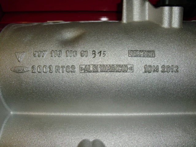

Please post the part numbers for the update. If you are just paying to put the same part number you may get one with a defect while now you have a good one. They fail early just a few thousand miles on the track will do it. Mine still fine

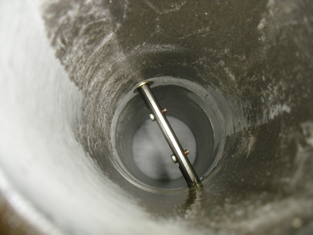

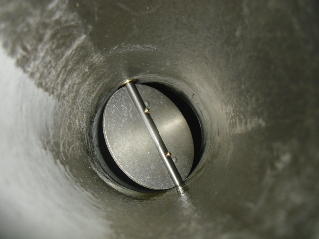

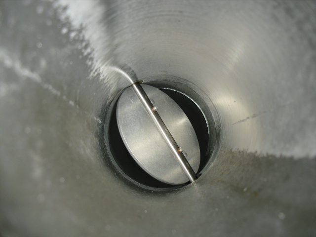

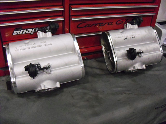

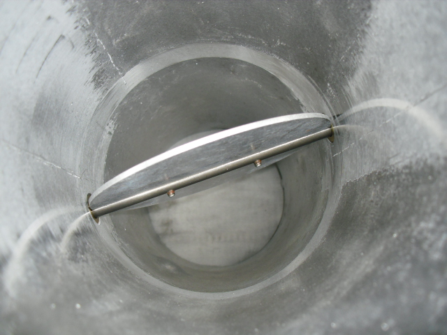

I believe the updates part is essentially a modified version of the original. I have posted an image of the replacement unit that was fitted to my car which appears to have some additional identification numbers. I have also provided some images of the internal differences to the spindle bush which now appears to be flush.
