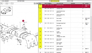

"The faulty part number appears to be .90 which is common to MY07 thru MY10. It was replaced with .91 in MY11. Cars that saw recall got a .94 package which opens up to reveal a .91 actual part.
Technically, the .91 has been "superseded" by the .94 in the system which only means one will have to order using the new part #. The contents of the package is still a .91.
I learned this from seeing a local GT3 non-RS getting its .90 replaced with a .91 (albeit with three handwritten digits after the part number--just like what we've seen on the TS thread and this ebay link).
Now, all 4.0s are manufactured with .91. If you hear of any 4.0 getting recalled that will refute my understanding above."
My 4.0 according to the VIN# is a .91 for sure. But the above failed and replaced cars were 4.0's right? I also know first hand 2 4.0's and at least one 3.8RS that got the part sucked in.
What actual part number was in your cars?
Are there signs that 91's are failing/getting recalled?
I will look at the part number myself when I get it taken apart and maybe replace it just to be safe.
