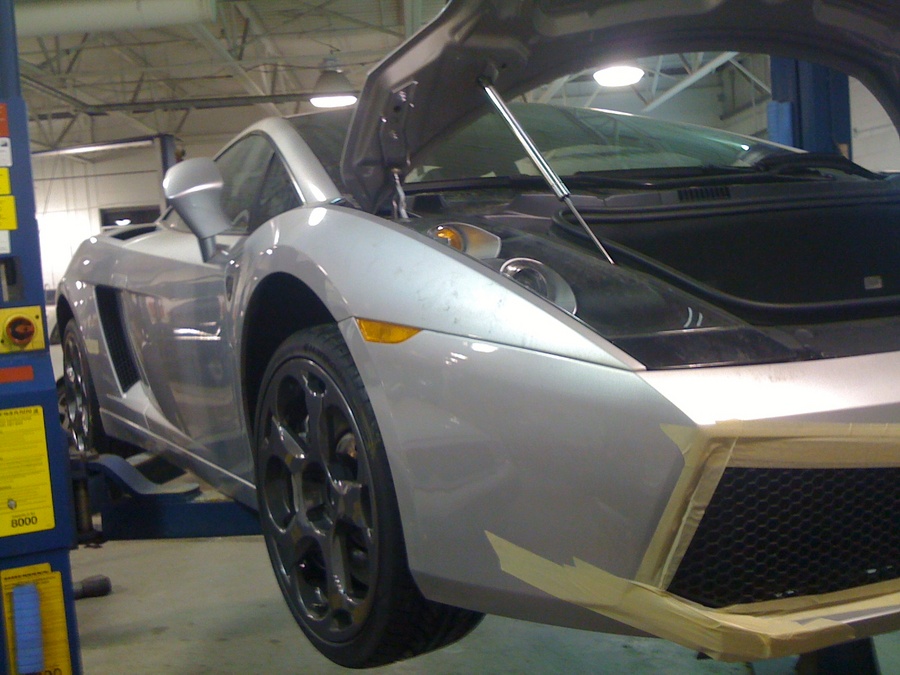

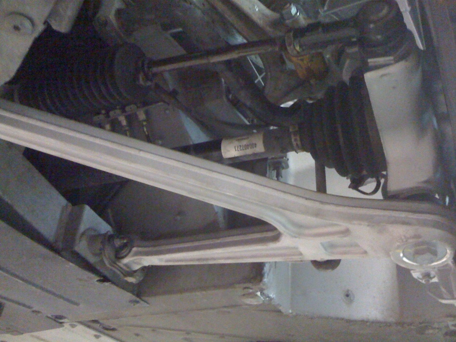

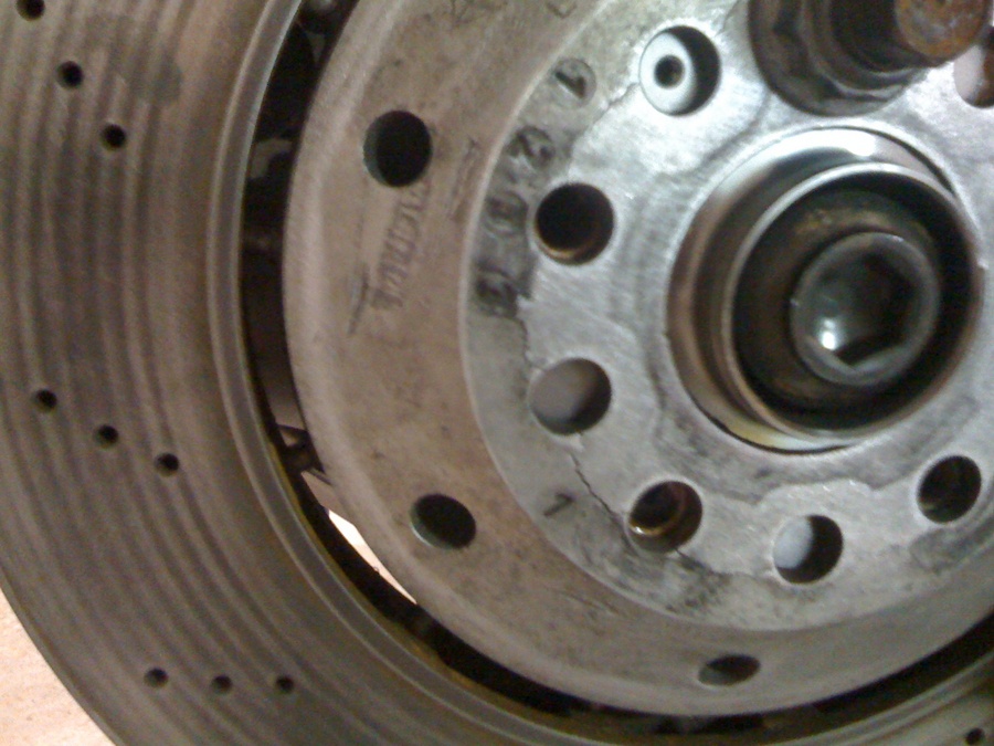

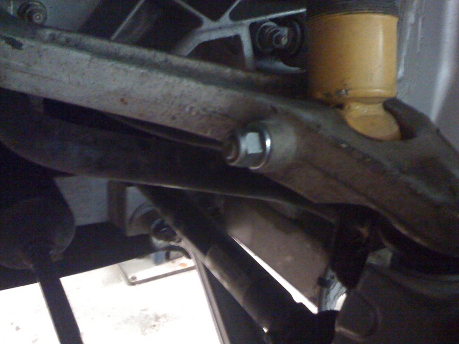

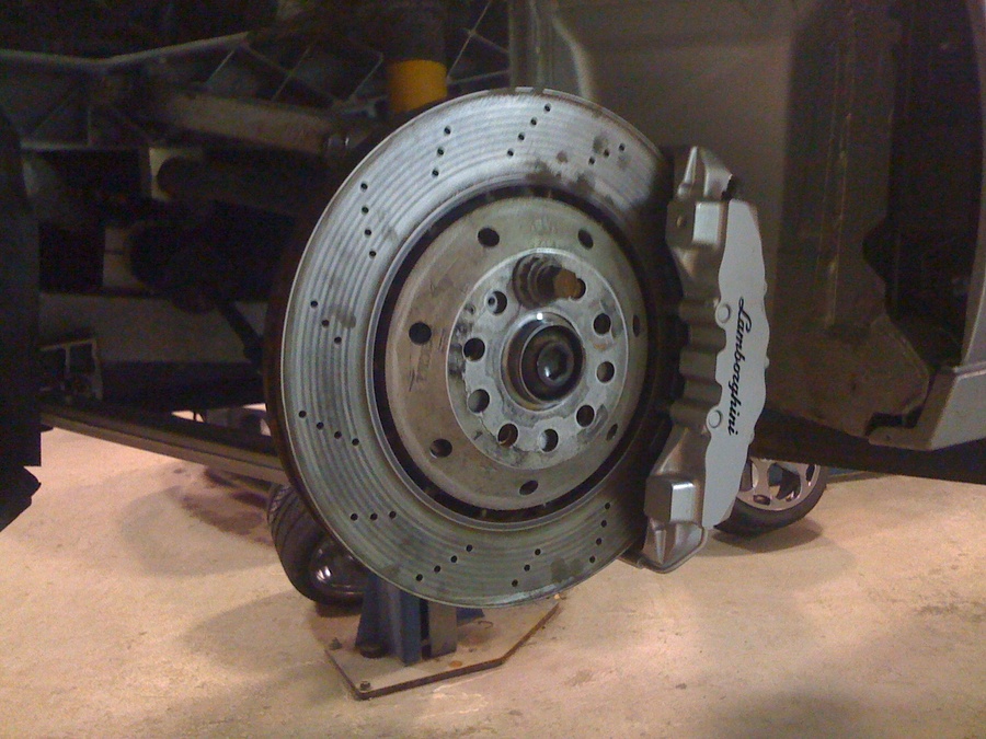

Front left was worked on a bit. They cleaned off (shaved) the disks and noticed that the hub of the left front rotor was cracked so it'll need to be replaced (another battle with the insurance company to replace the other side).
Car also has the new wheels on. Pleased to see the titanium ones look good (old ones were black).
Pic shows new lower control arm, steering tie rod, spindle, brake caliper, and suspension bolts.
Its damage like this that has not yet been spotted that would scare me.

From: Modena
gvan is a splendid one to beholdgvan is a splendid one to beholdgvan is a splendid one to beholdgvan is a splendid one to beholdgvan is a splendid one to beholdgvan is a splendid one to beholdgvan is a splendid one to beholdgvan is a splendid one to beholdgvan is a splendid one to beholdgvan is a splendid one to beholdgvan is a splendid one to behold
I've been over the car extensively and probably spent upwards of 20 hours studying parts diagrams to figure out any interactions of forces, looked at which parts bent, where the energy went, how the diff would be impacted by the forces on the axles, etc. I'm pretty sure we got everything. This one we probably missed because the stump of the rim was still attached hiding the crack. I had actually looked at that rotor extensively and was waiting for it to be shaved to see if it was warped, it wasn't but turns out was cracked instead. I guess that crack follows the edge of the hub behind the rotor.
