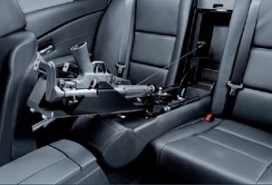

You know, since you live in a free state now, the E39 M5 has a police option MP5 gun rack.
Instead of the rear center armrest, this thing takes its place and you can put your MP5 in this special rack, in the BMW M5.
How cool would that be?

I've been considering an E39 M5, but I'd have I find one in good shape with a full maintenance history. As far as the MP5 in the rear center armrest, I'd be carrying my Sig P250 subcompact on me, a 1911 in the glovebox, and a 10" barreled M4 with an M42000 can,in the trunk.
Having a CCW is a great thing.
