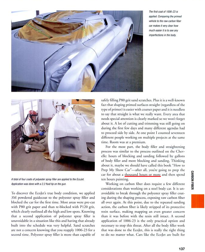

Ignore streetrod, he's the resident Koenigsegg hater/Pagani fanboy and have spent well over 1000 man hours spreading lies and slandering the brand on PH and teamspeed and wont hesitate to do the same here. Which is bizarre given Pagani's (and not Koenigsegg's) rich history of dubious stuff, but oh well...
This simple one layer wet sanding with primarily machines on flat surfaces and only the body panels took three guys 40 hours or 120 man hours in total and cost north of $10000.
Add all the masking, layers, complex surfaces that has to be wet sanded by hand grit by grit as well as the monocell and numerous smaller pieces that also has to be clear coated and wet sanded by hand. If something as simple as that job takes 120 man hours then it's more than reasonable to assume Koenigsegg's paint job eats up much more time.
And here's an actual 1000 hour quote from "How To Paint Your Show Car" by Stefan Gesterkamp, an authority on the subject.
Stefan Gesterkamp is a Master Craftsman and BASF representative who has been in the automotive paint industry for 27 years. He started his career in a custom shop before turning to collision repair. Stefan graduated from the University of Coatings and Colorants in Germany and is the author of “How to Paint Your Show Car.”
