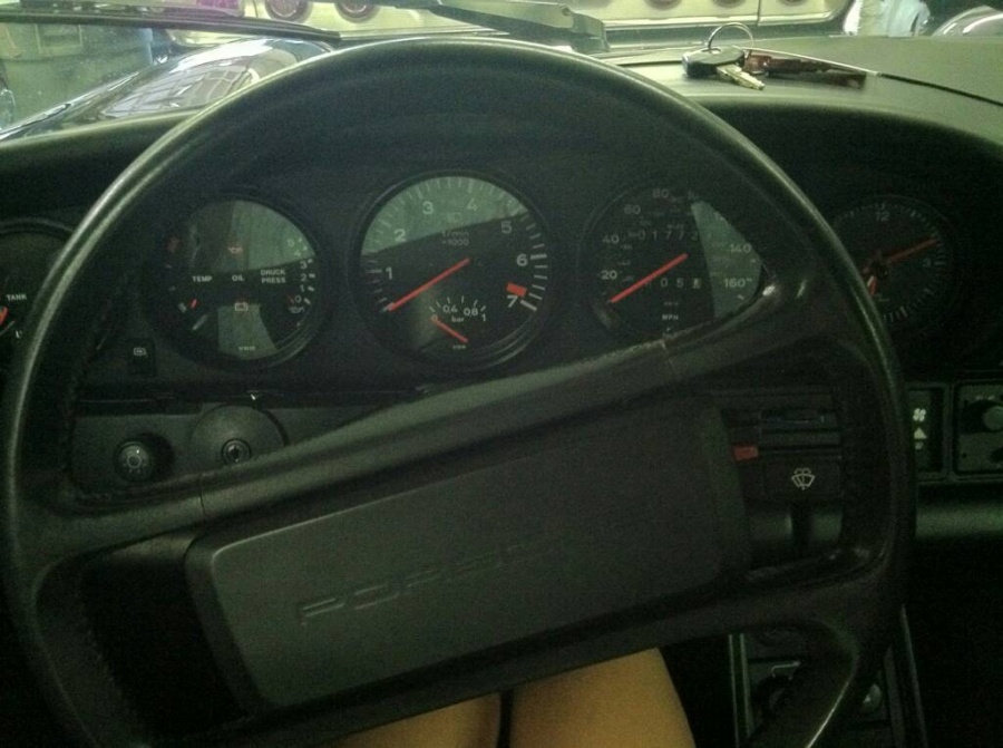

Beautiful ! I used to work at a Porsche shop . Name:  uploadfromtaptalk1407036749945.jpg
