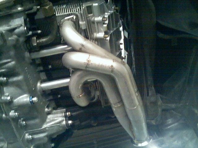

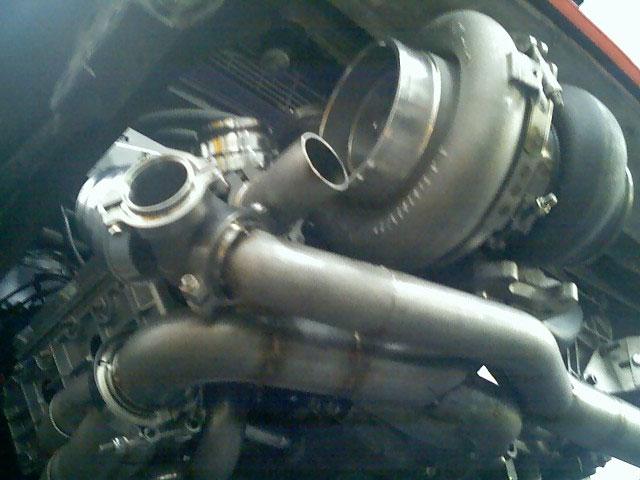

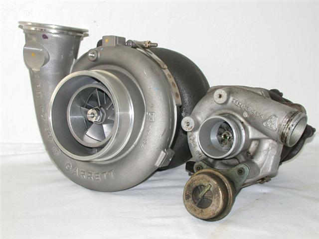

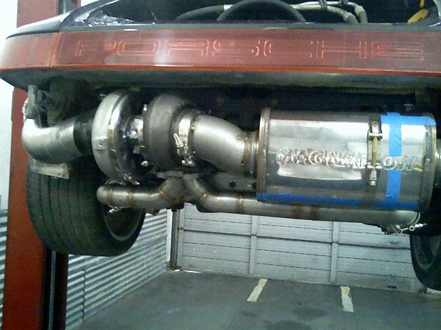

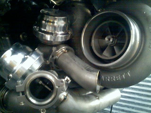

More photo's.
* A photo of the Modified Garrett Turbocharger vs. a stock K24 turbocharger.
* A photo the equal length headers and the 12-degree merge angle collector.

* A photo of the exhaust.
(4” free-flowing race muffler)
* A photo of the twin 44mm Tial wastegates.
(The twin 44mm wastegates come together on the driver’s side to make a
4” tip)

Looks like an incredible project. Carillo FTW.
Just guessint but is that a 4294 compressor with a 4088 turbine or did you go smaller? I'm guessing ball bearing center section because of the coolant ports? If that is 4294 71mm is a big wheel! If it's a 4202 then even more
