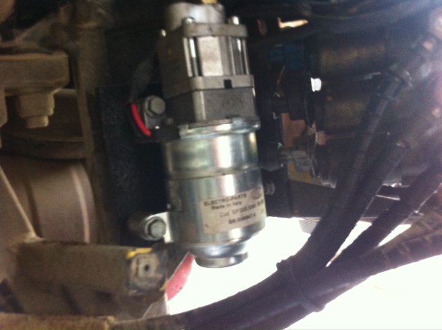

UPDATES: well, the manual did say that the light will flash when the clutch is not fully/properly engaged (cannot remember exact term), and i think we were 80% on the correct path.

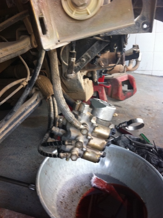

even if i am an now questioning the initial diagnosis that the original 355 f1 pump was low-pressurized, and that it was only the matter of the clutch; i tell myself that since the car is at the shop dismantled, fvck the price and do everything all at once

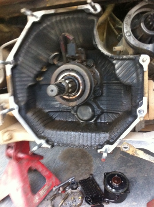

turns out the clutch-release bearing leaked, so i just put in an order with Ricambi (i am amazed by how good Daniel Pass' customer service is) for a Hill Engineering throw-out and it will ship TODAY
i also threw in a new sensor kit, and that way, i would have:
installed a new clutch, new pump (of a Modena + adapter for 355), a new clutch release bearing, and a new sensor
thus, i am guessing and hoping that this will get the clutch/f1 system back to tip-top AND improved shape (stronger pump, tougher bearing)

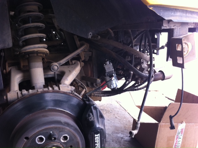

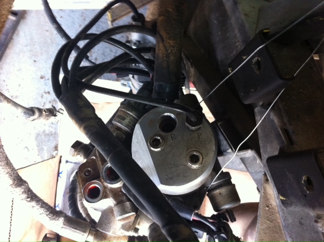

in the first pic below, you can see the adapter installed at the top of the unit
in the second, you can see the OEM bearing; at first i thought the flange was an issue but thankfully and hopefully it is not

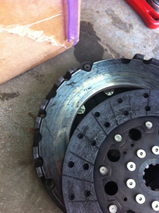

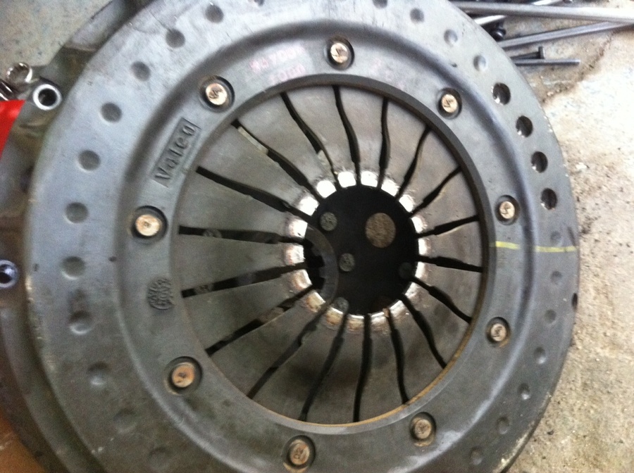

finally, the 3rd and 4th are of the clutch
unfortunately the 355 is my only "manual" car so i have no idea what to look at to see what 'damage' the bearing/pressure of pump did to the clutch.
any pointers?

is there anything you can tell me about the clutch condition just by those 2 pics?
is there something i should be looking at to showcase slippage and loss of grip from the bearing?

unfortunately the Hill Engineering bearing was installed before i could go and snap a photo or two

but i took this pic of the adapter and the wiring for a before/after shot when the pump is aligned

bracket finished, and installed
started the car, pump pressurizes a LOT quicker so that's good
still need to bleed it though and take it to 1st/2nd while idle.

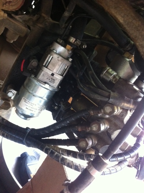

1st pic: you can see the bracket and the screws
2nd pic: bracket from top, and the adapter that the wires are feeding through to the solenoids
3rd pic: assembly as it is now
