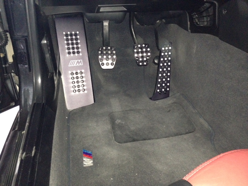

Recently replaced the AC Schnitzer pedals with these beautiful pedals from BMWpedals.com (thanks to Clubber for the tip)

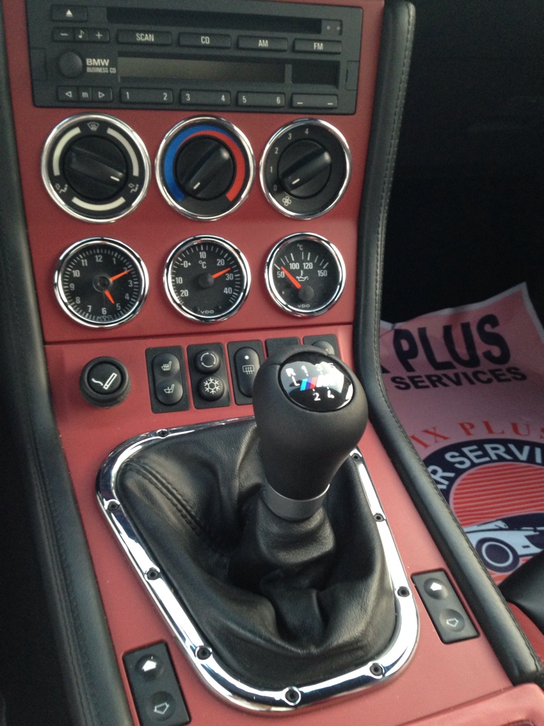

Also replaced the OEM aluminated gear knob with a smaller weighted knob, very cool.

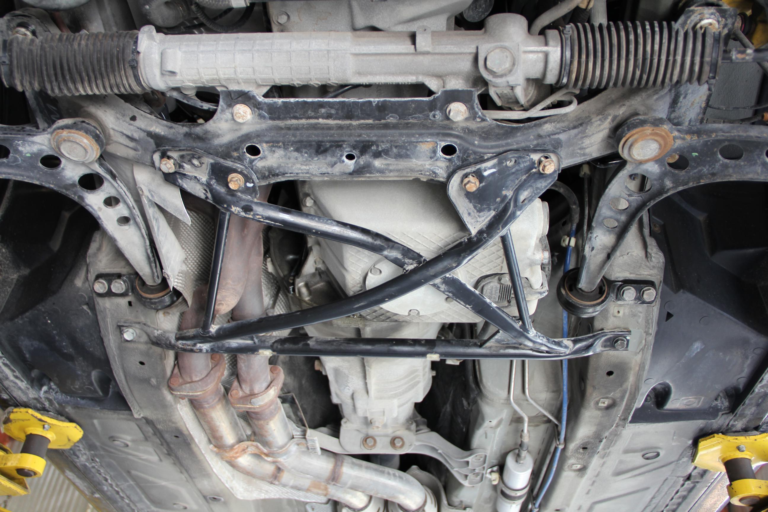

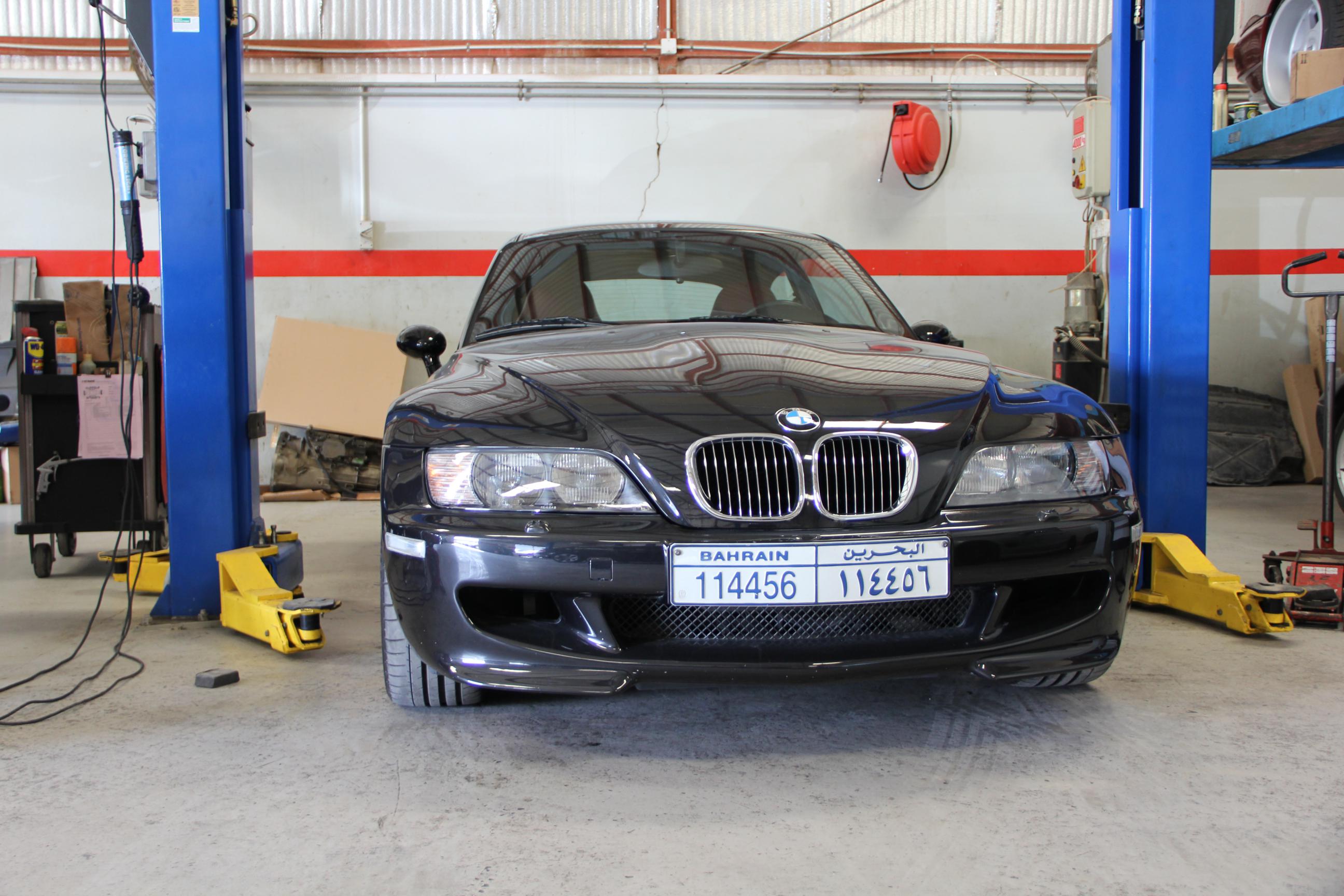

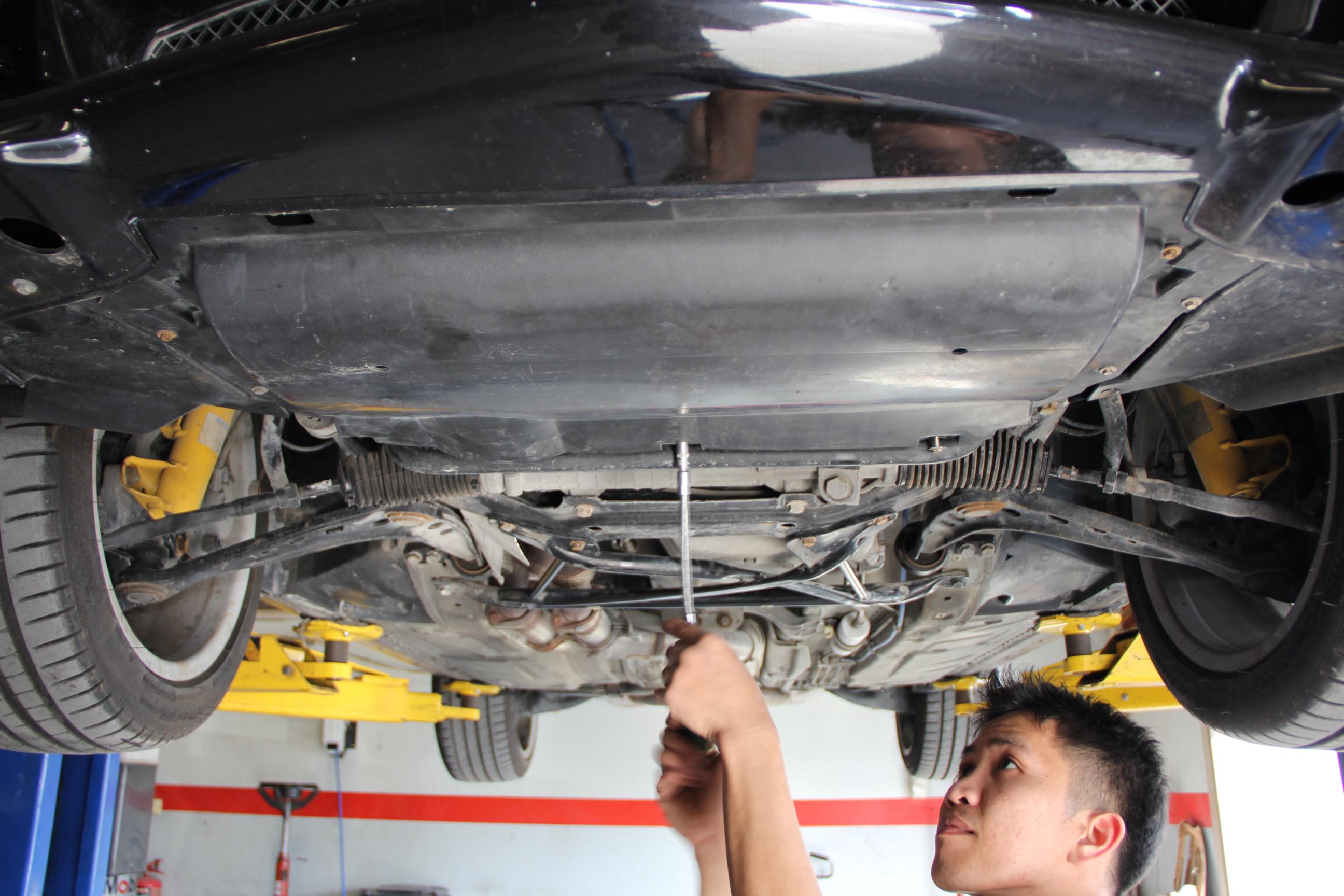

Here she is coming in and straight on to the lift.....

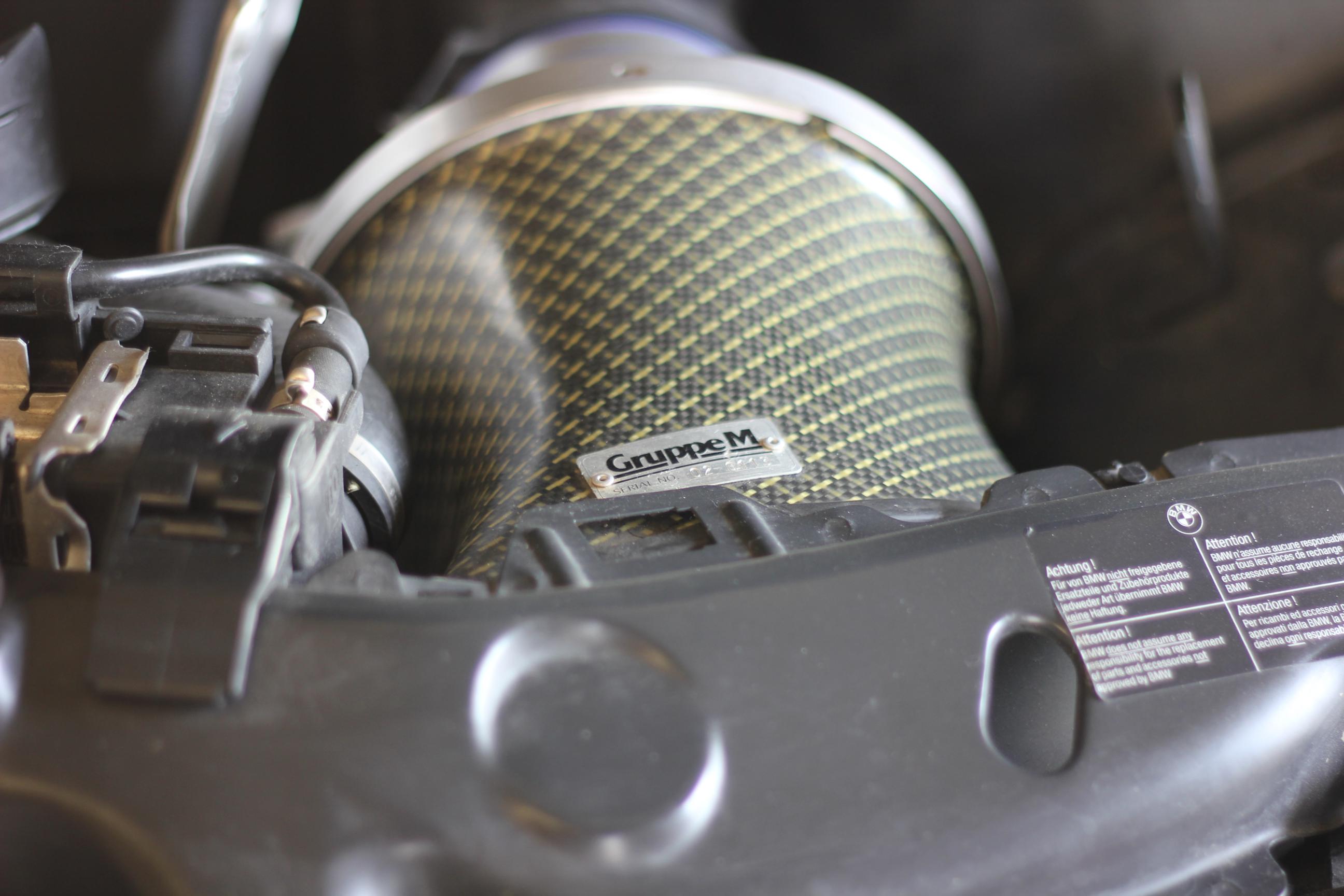

GRUPPE M Intake...

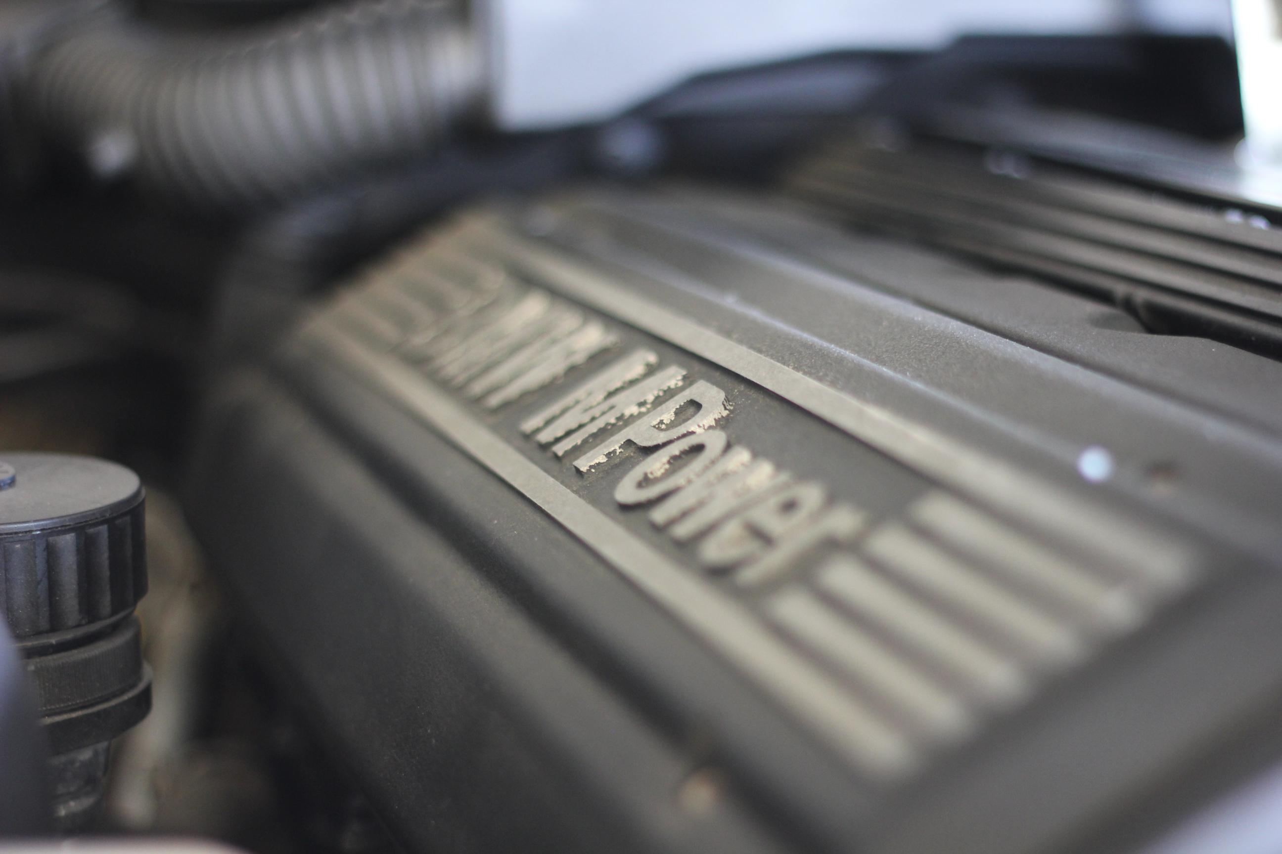

SEXY ///M Power Valve cover....

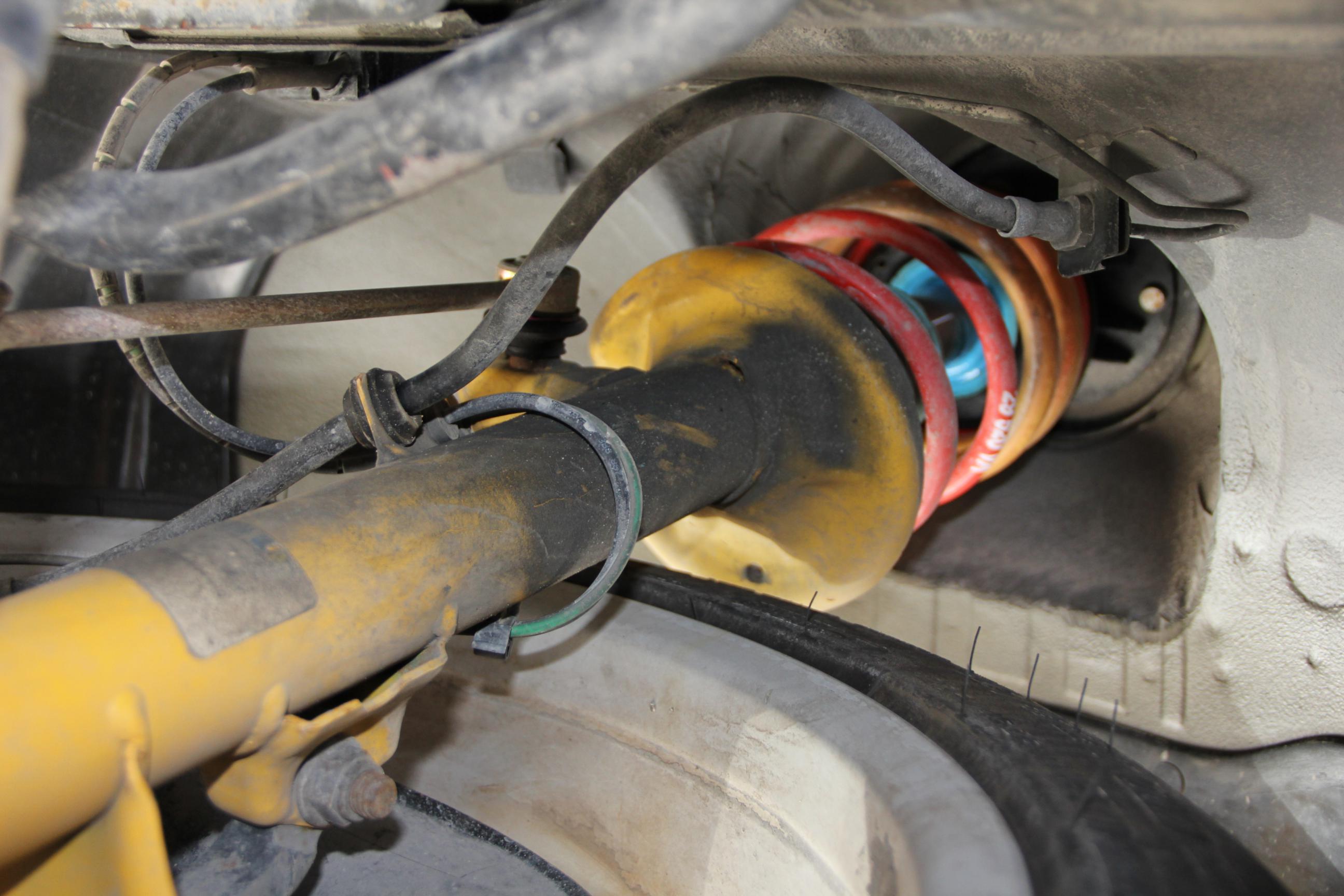

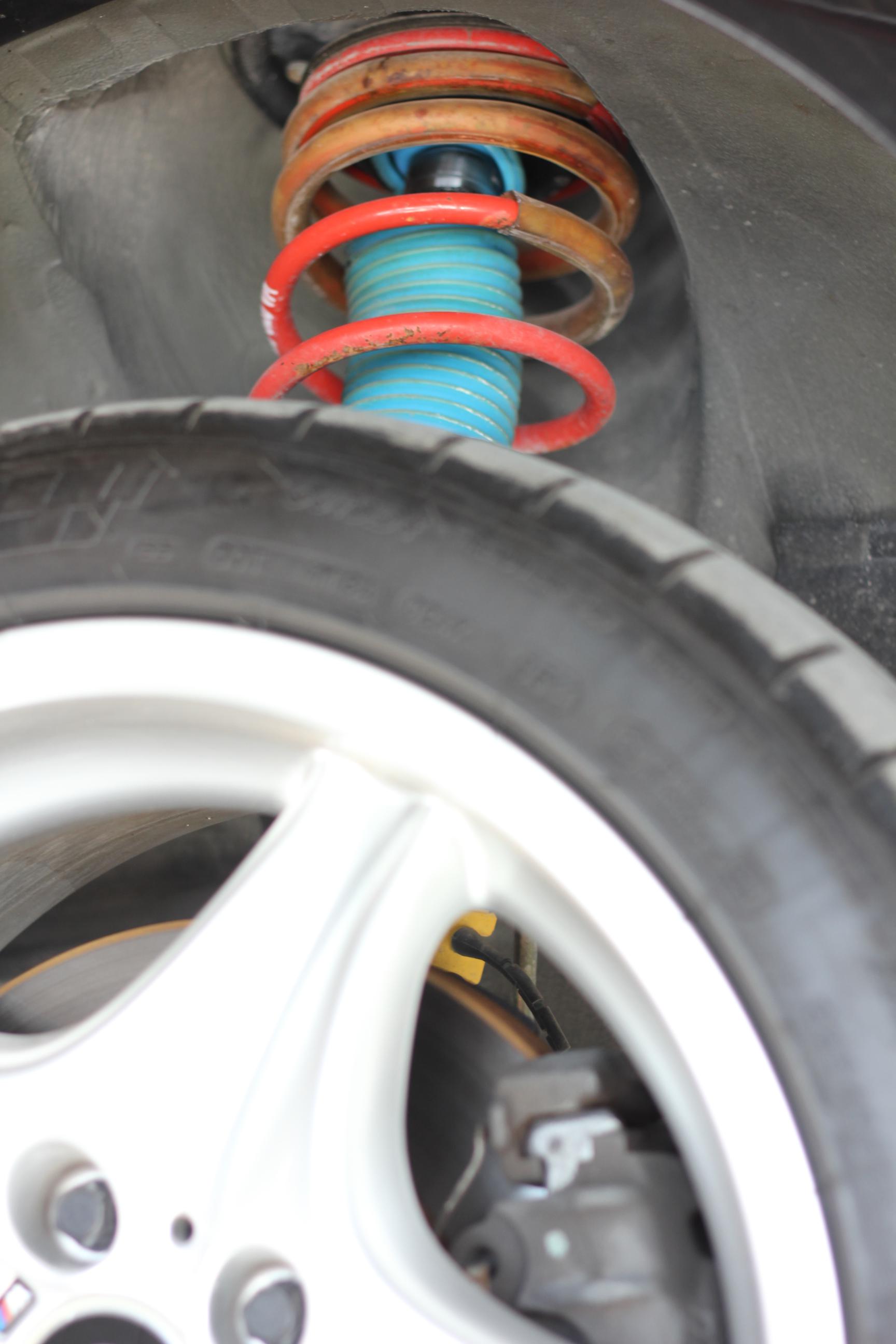

Leaky Bilstein Front Shocks....

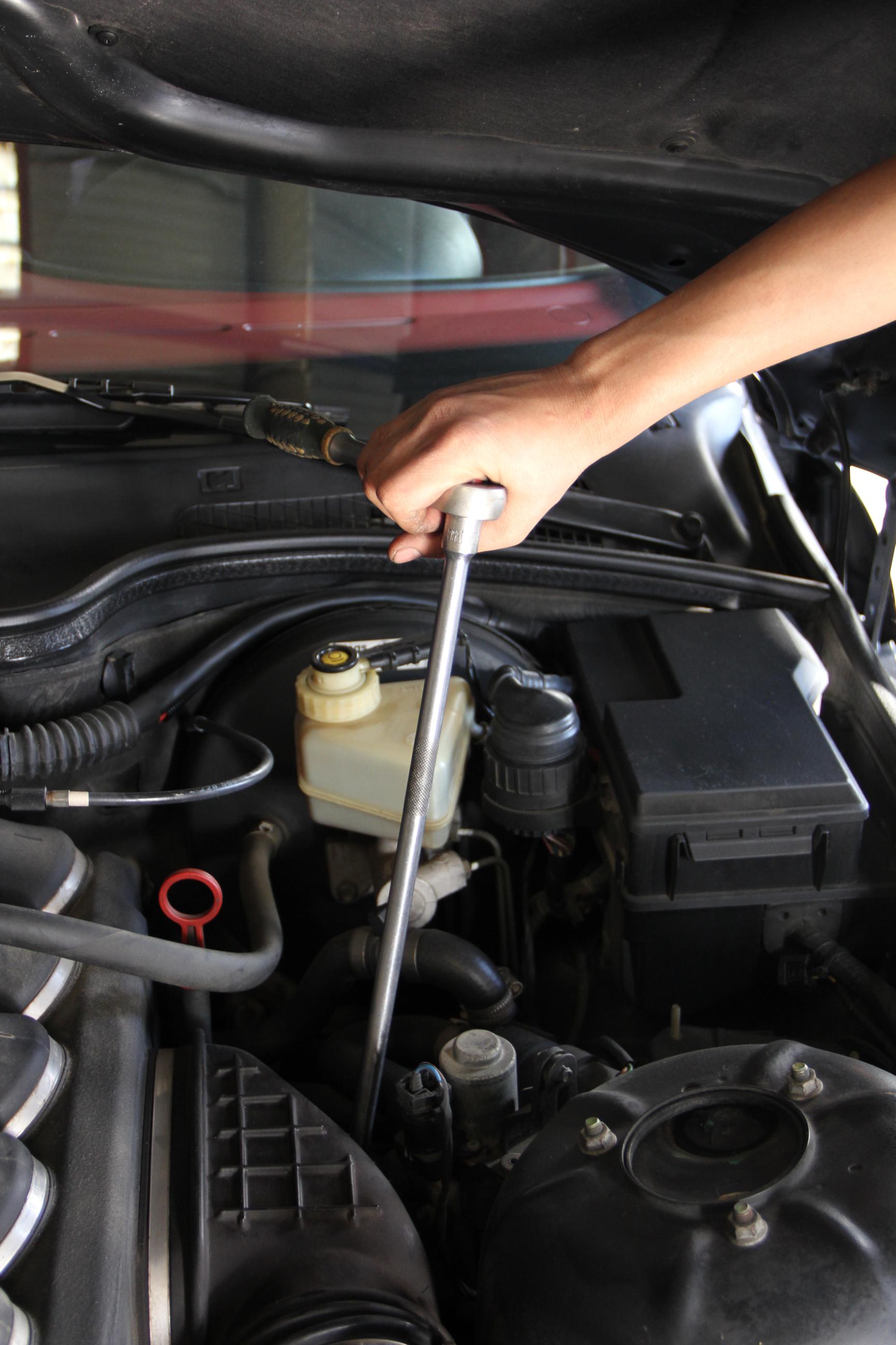

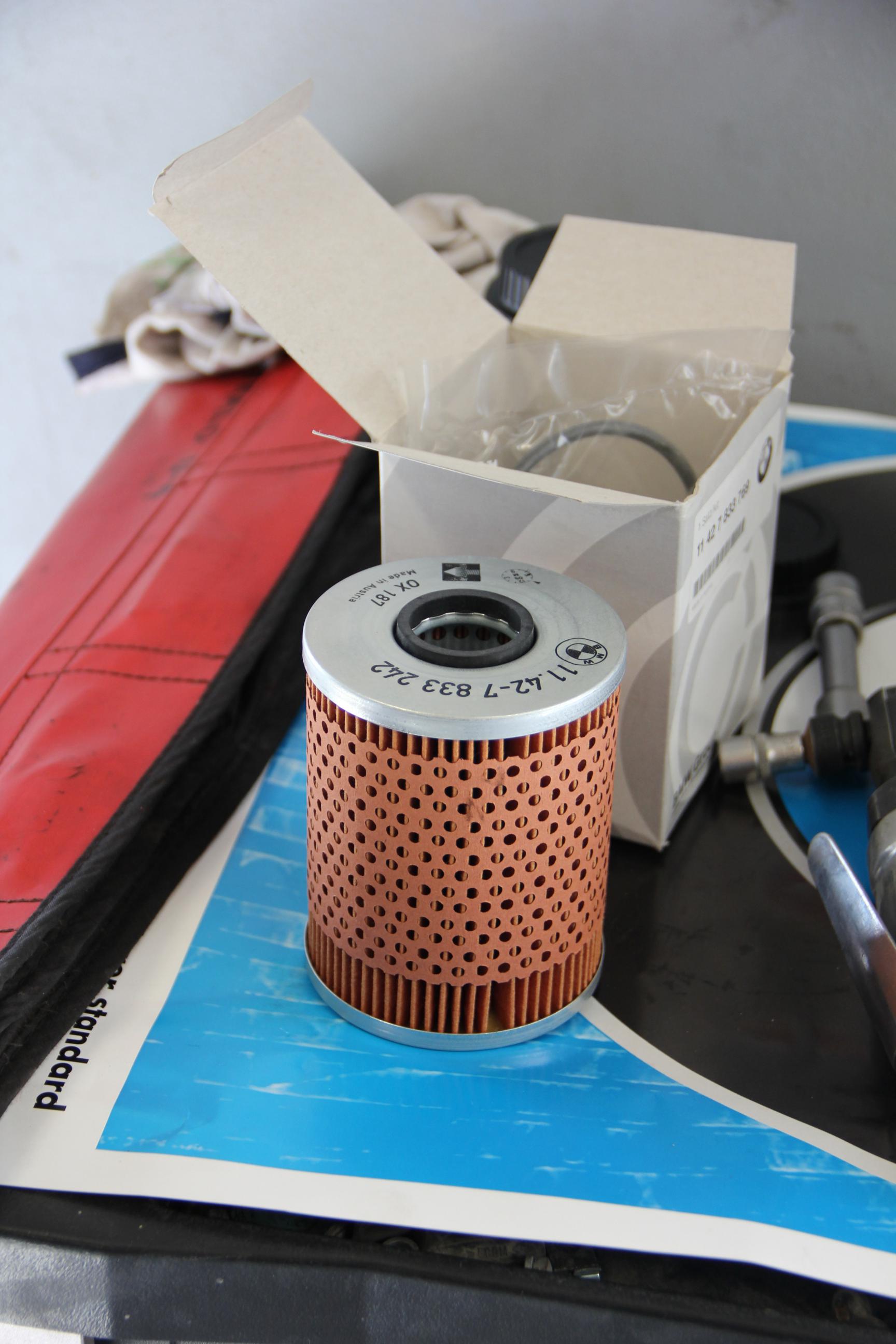

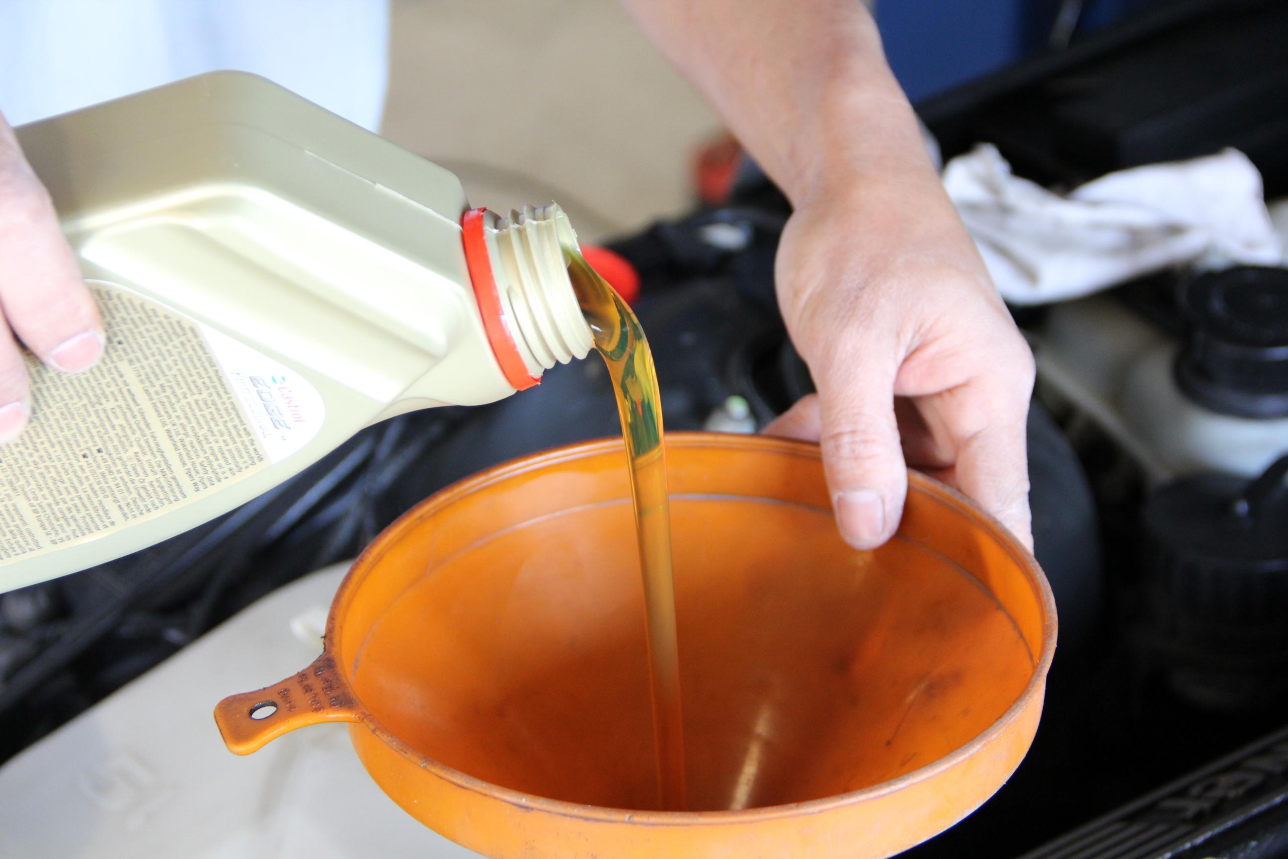

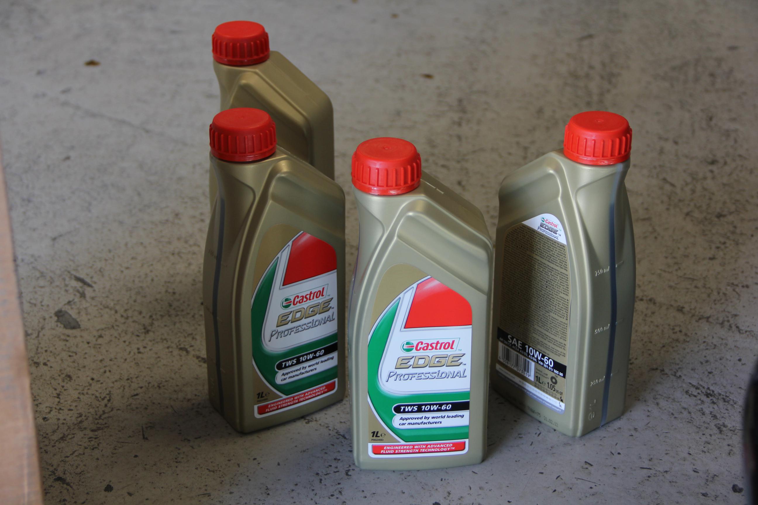

Time for an Oil Change with some Fresh TWS....

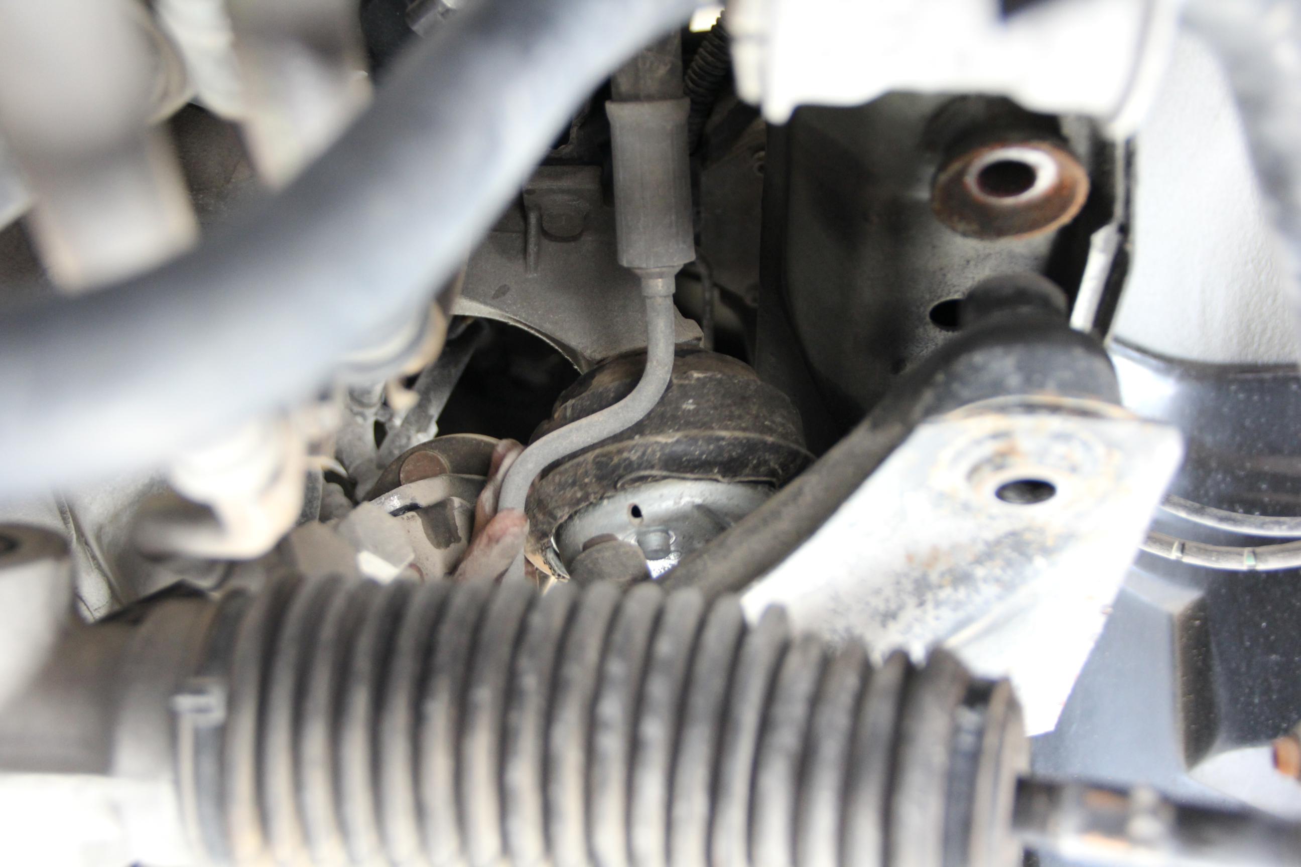

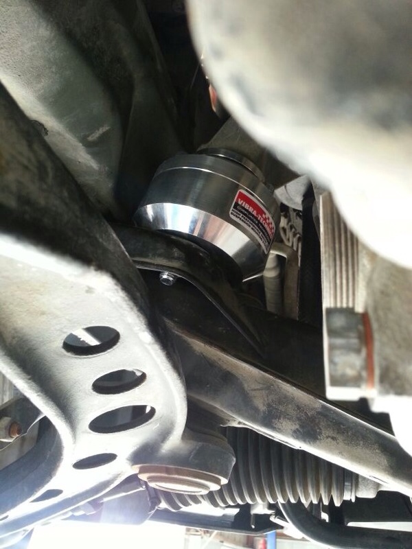

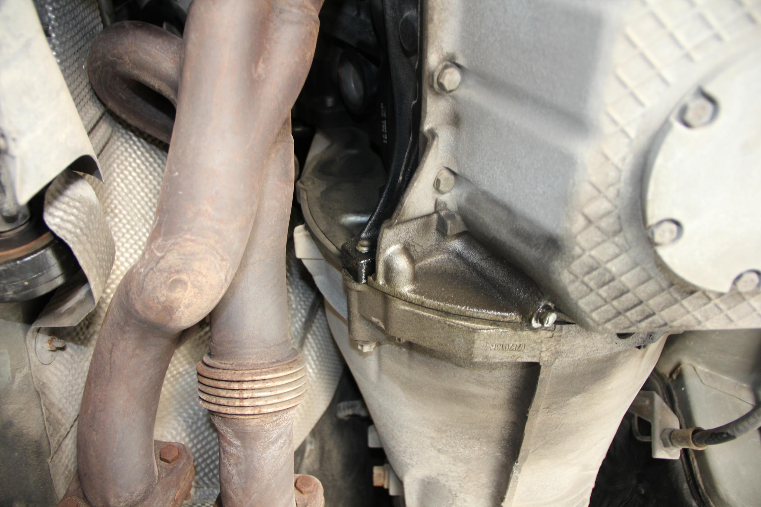

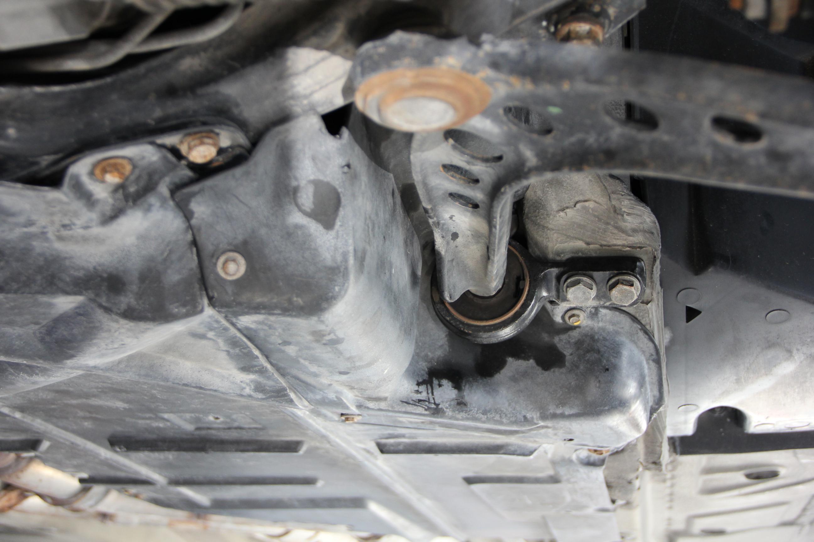

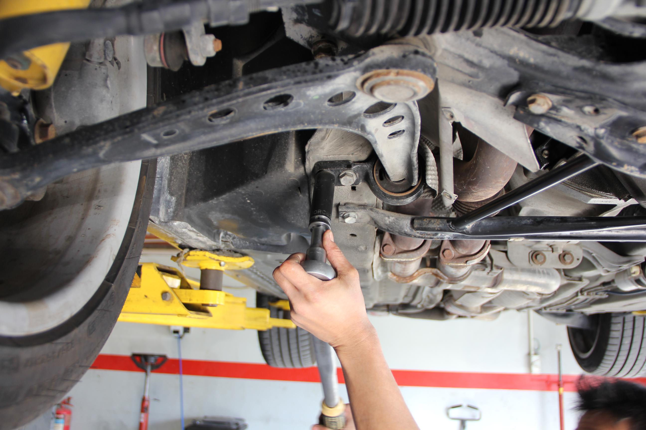

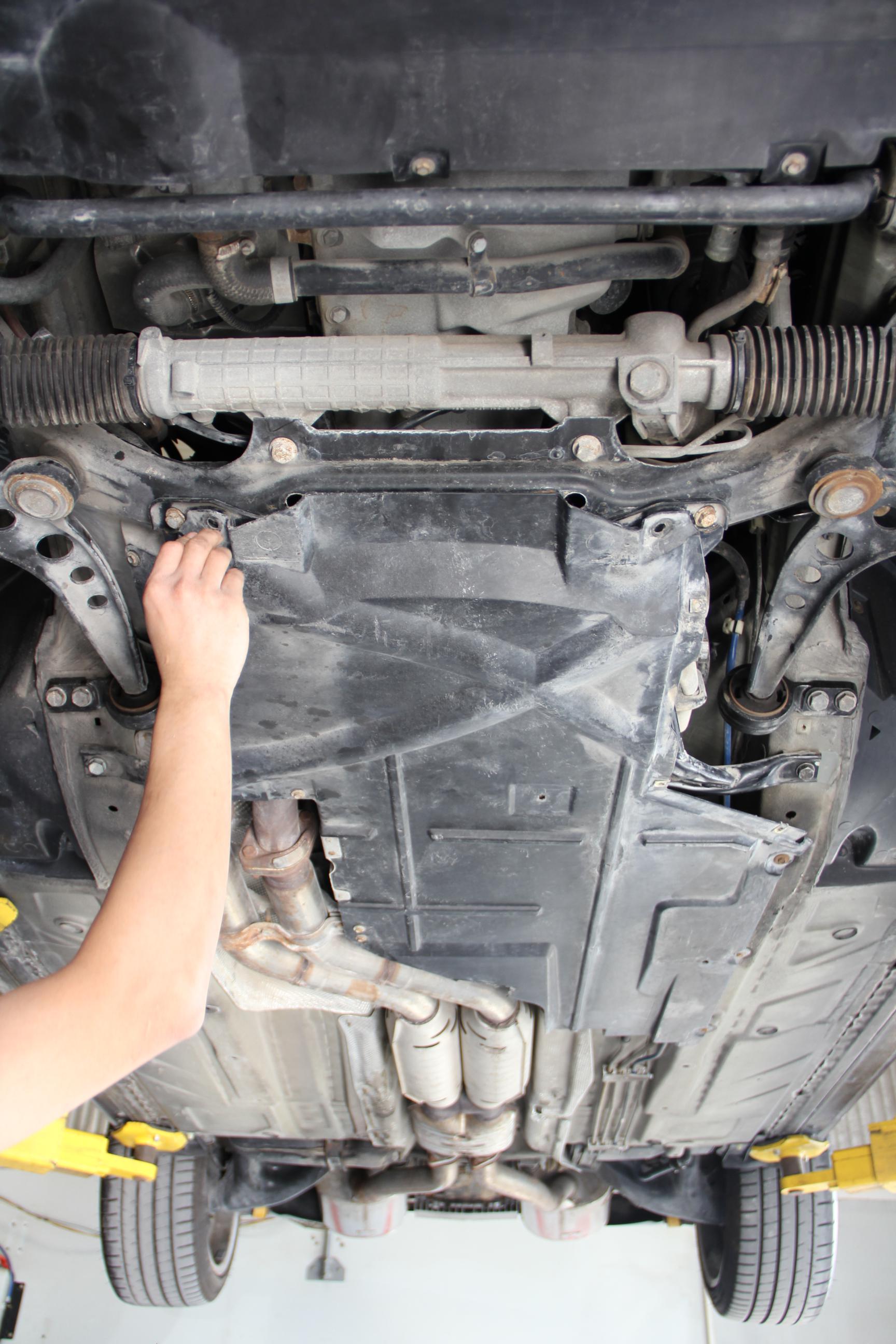

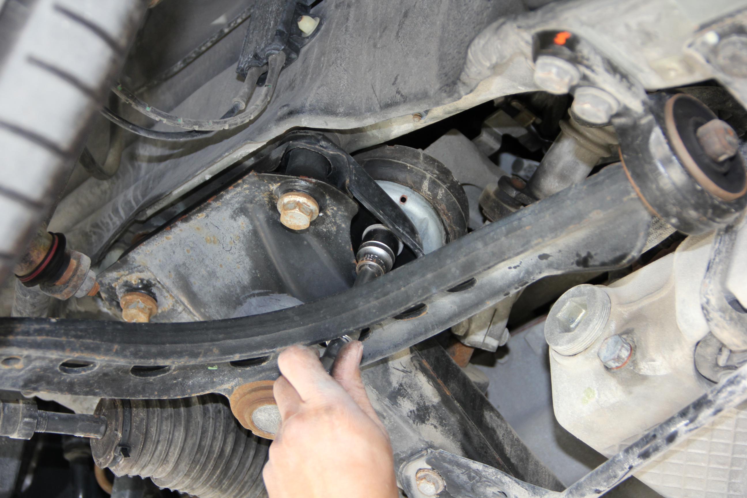

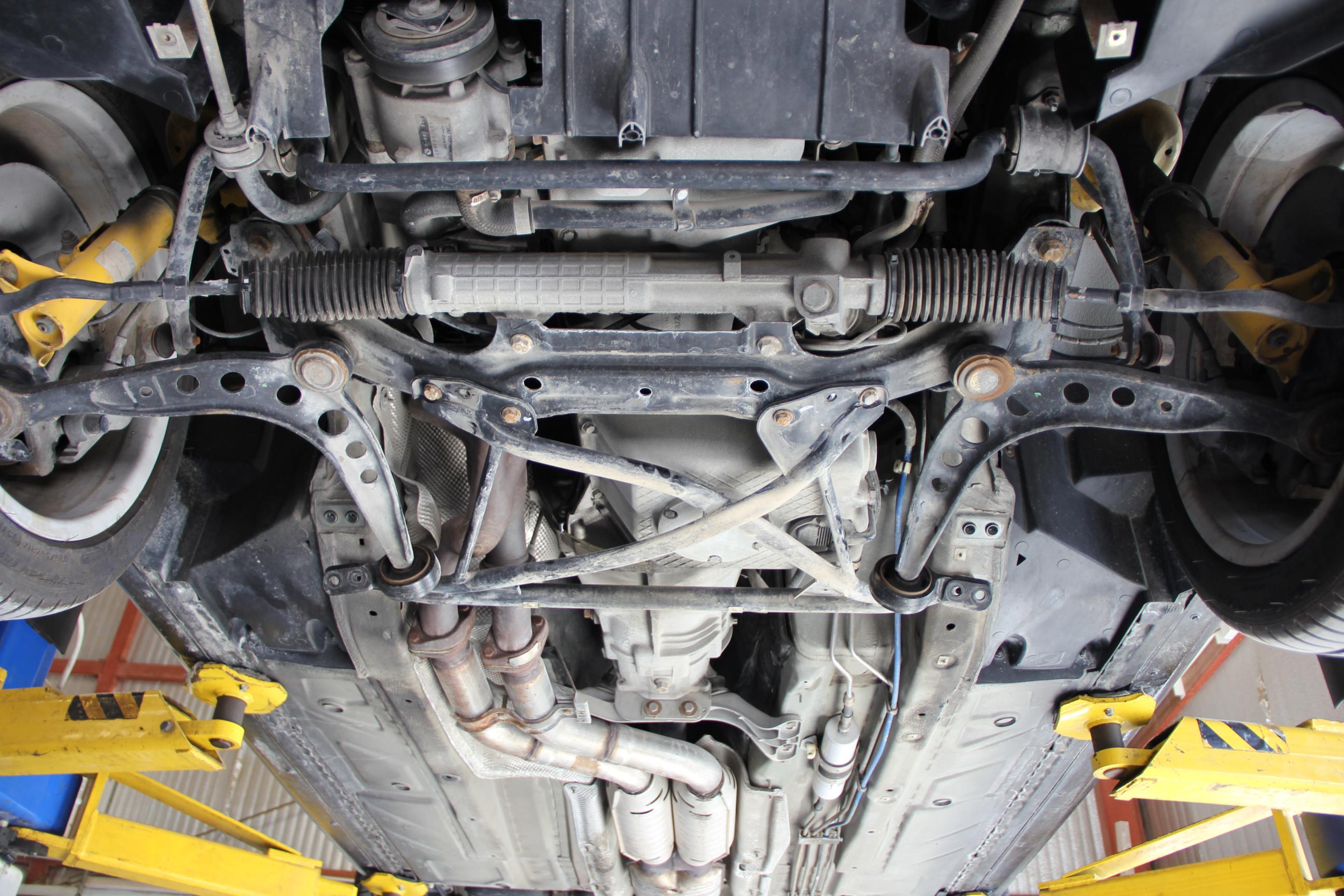

Pics showing removal process of OEM Engine Mounts. They'll be replaced with Vibra technics Street
Mounts....

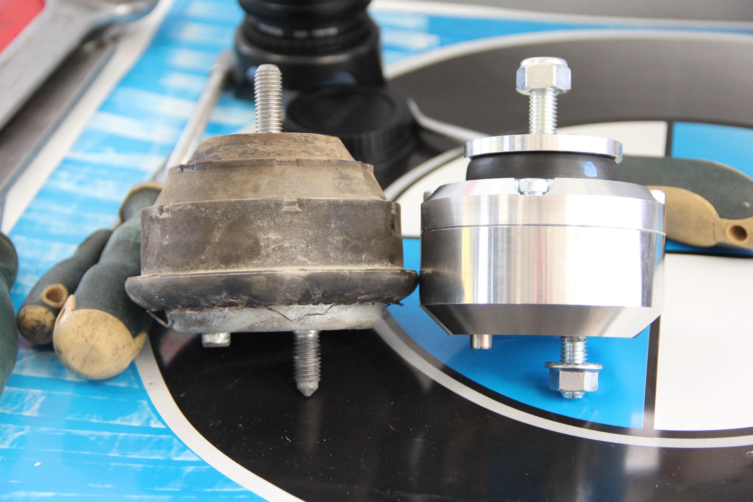

OEM Engine Mounts Vs VT’s Street Mounts.....

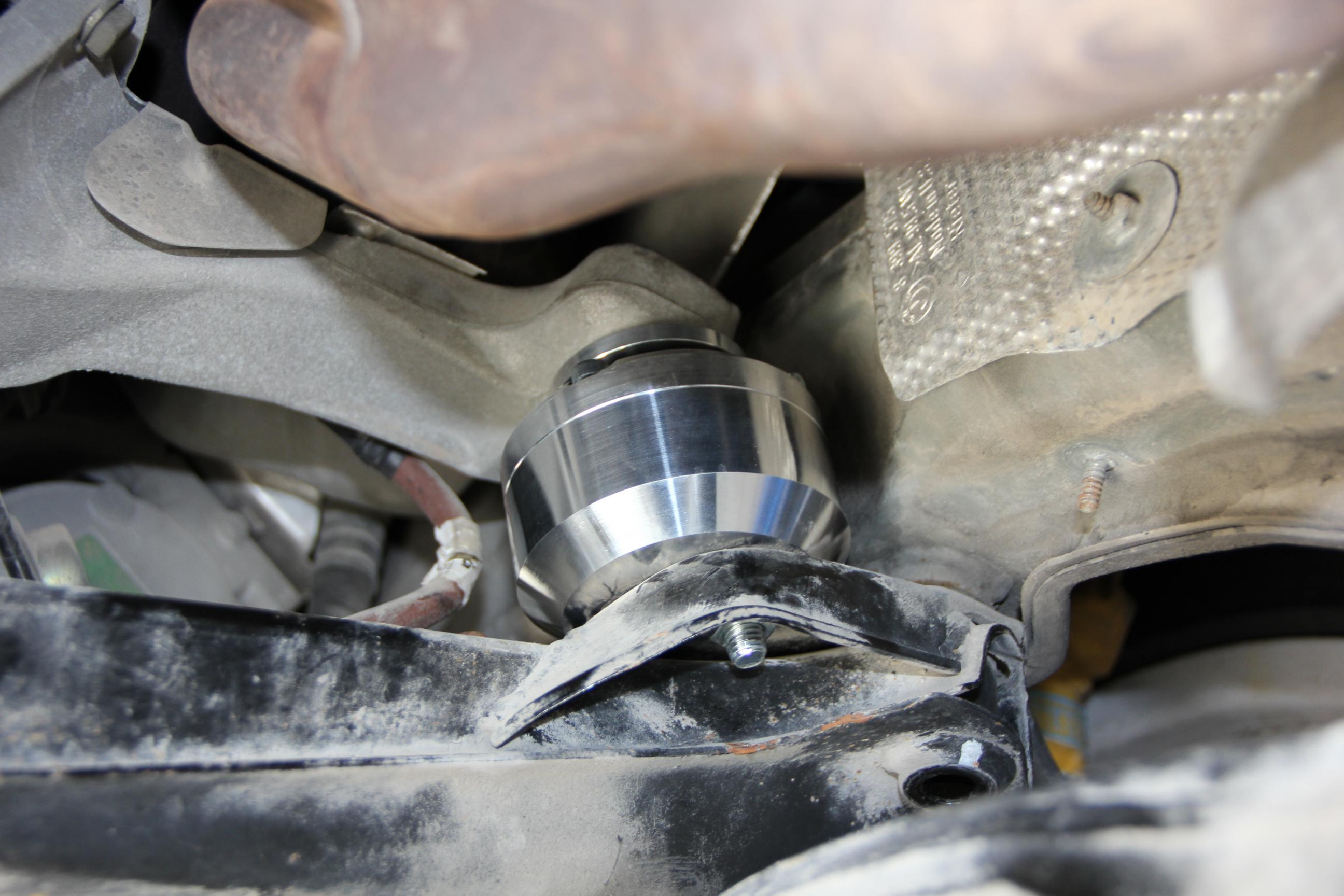

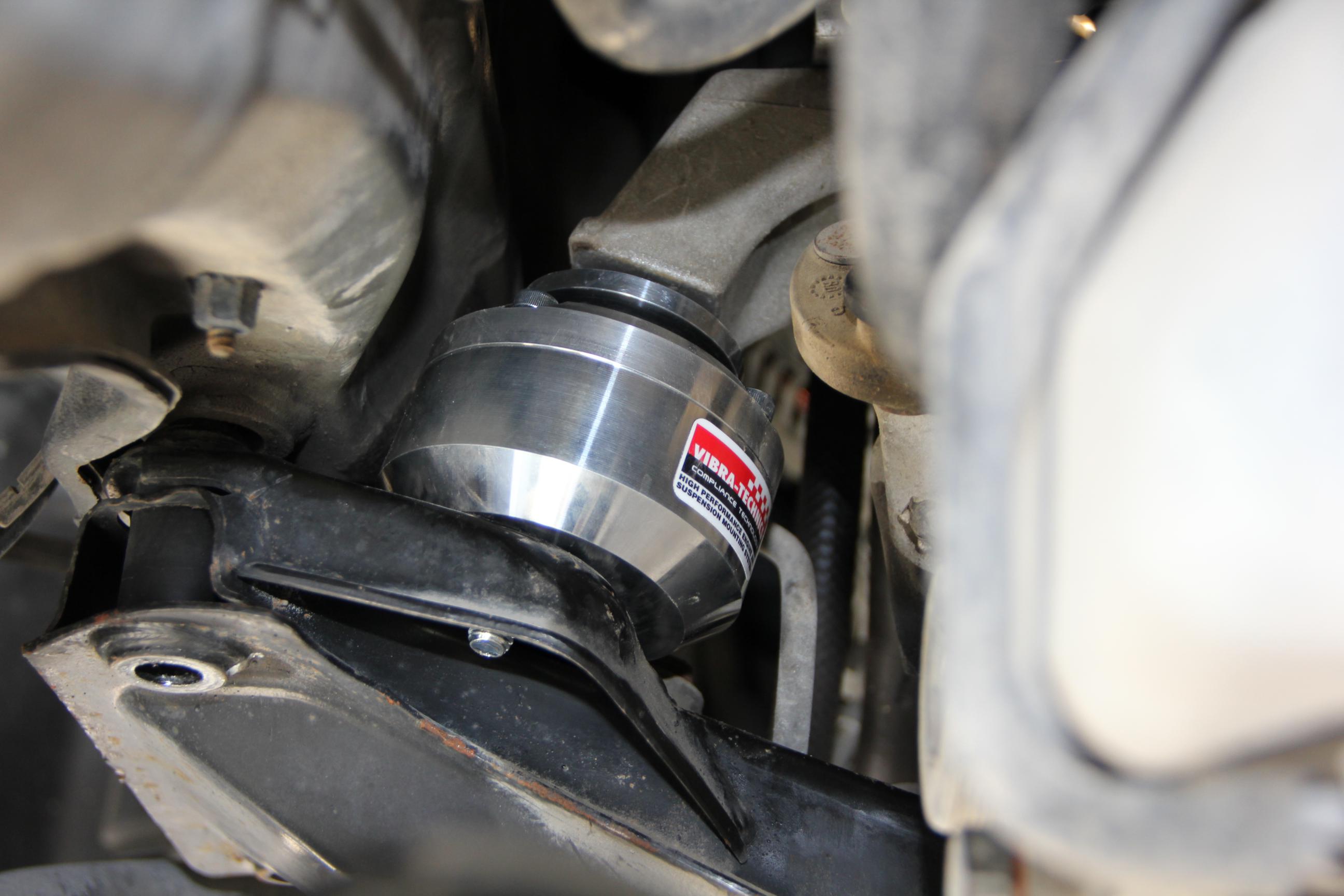

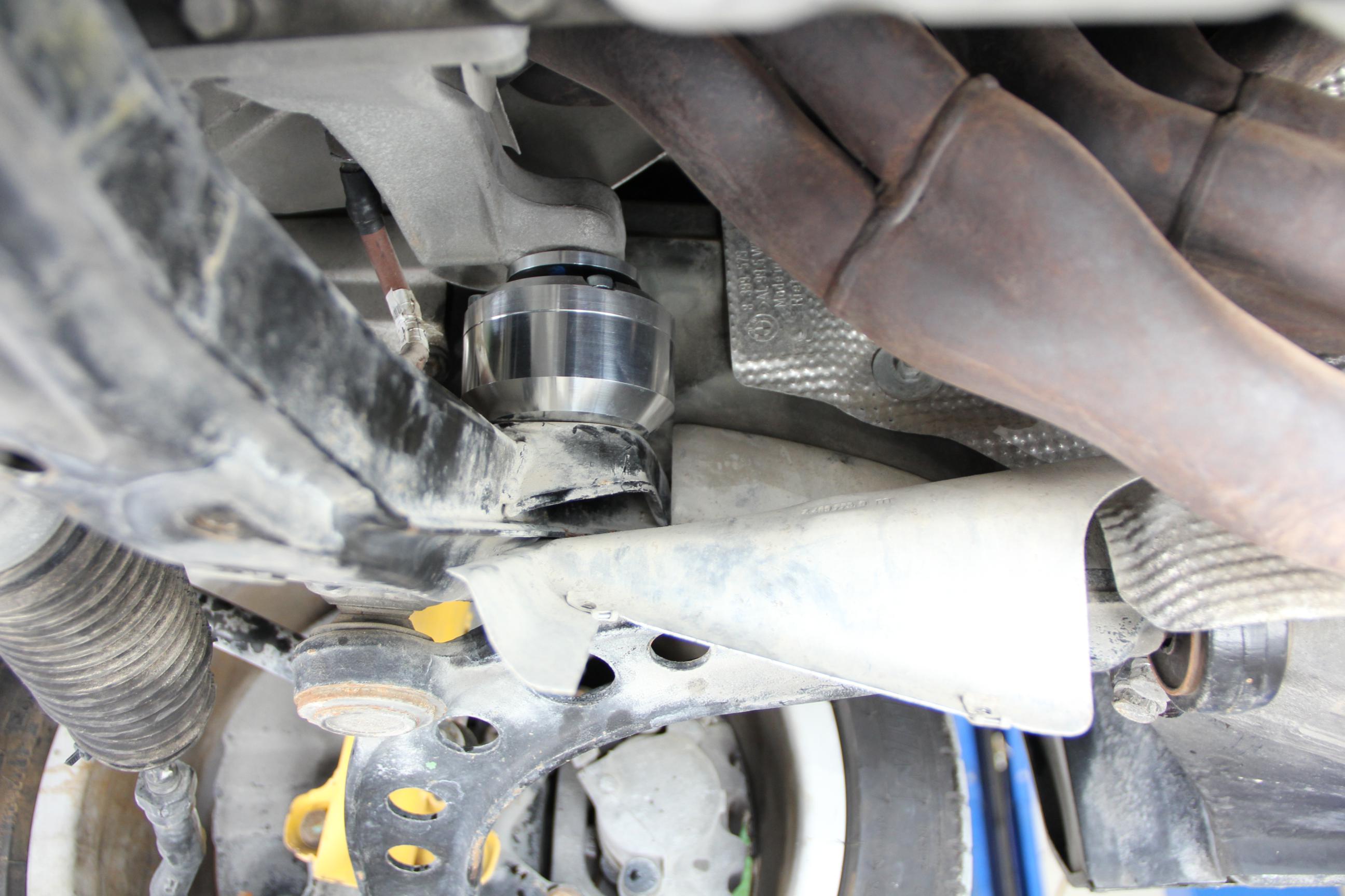

VT Mounts Installed........Easy Peasy Lemon Squeezy.... Well not really, a lot of parts had to be removed
in order to access the OEM mounts and replace them with the VT mounts.....

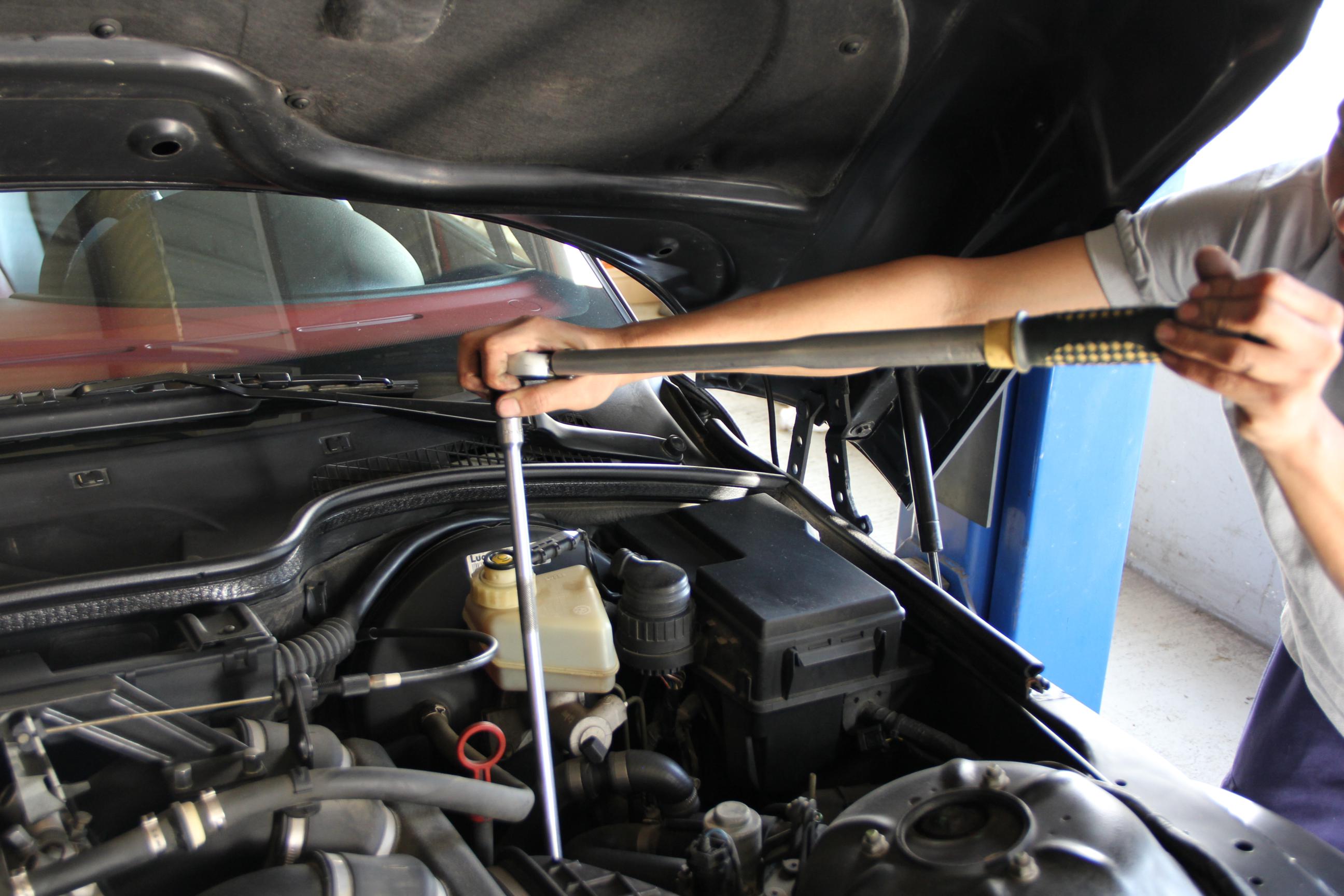

Random pics showing the re-installation of all the parts after the VT mounts install....

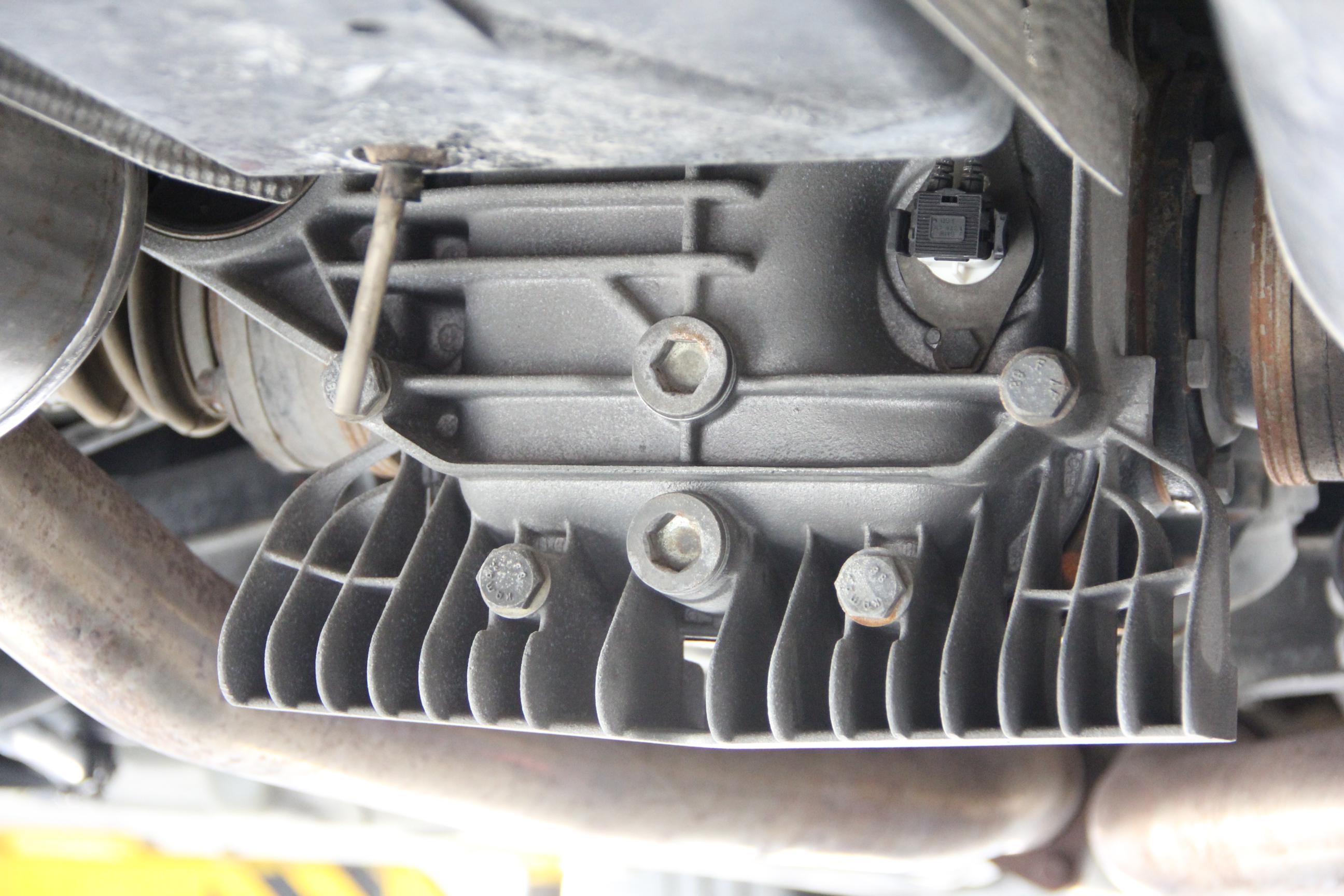

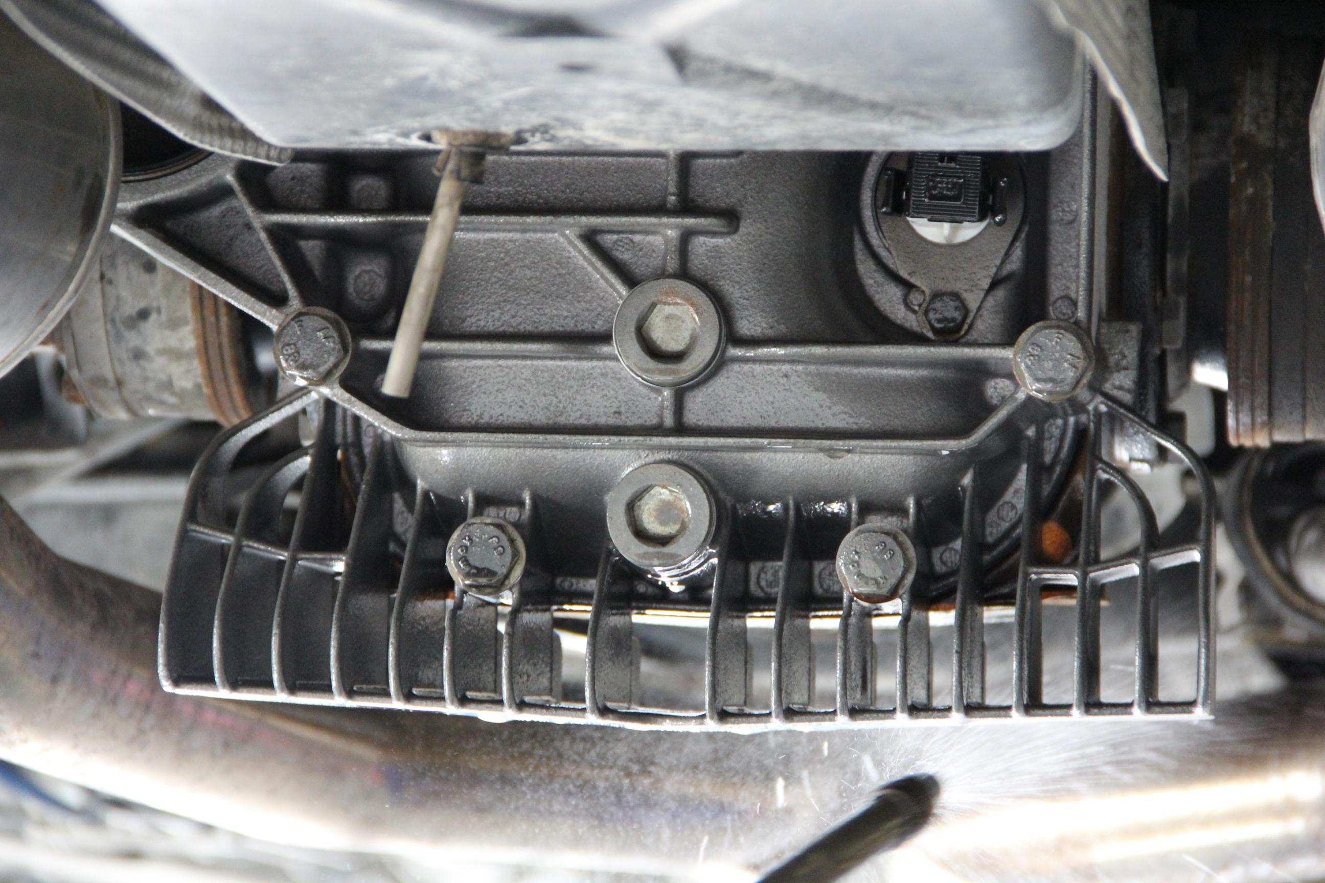

Diff/Final Drive Oil Change.....

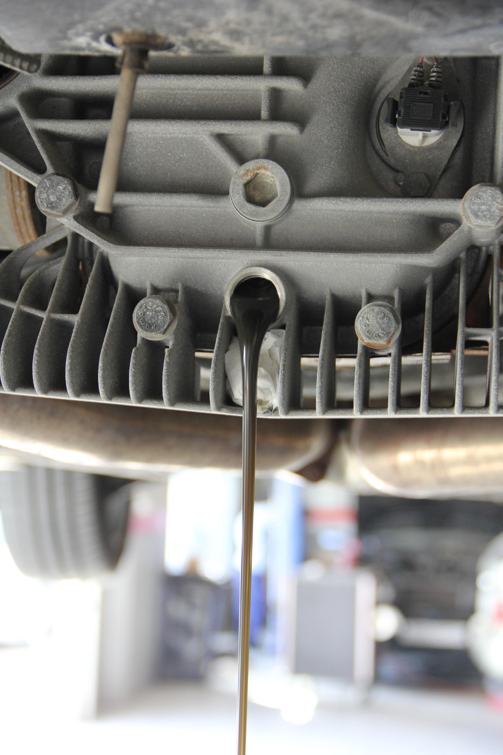

Old Diff/Final Drive Oil Was very black....

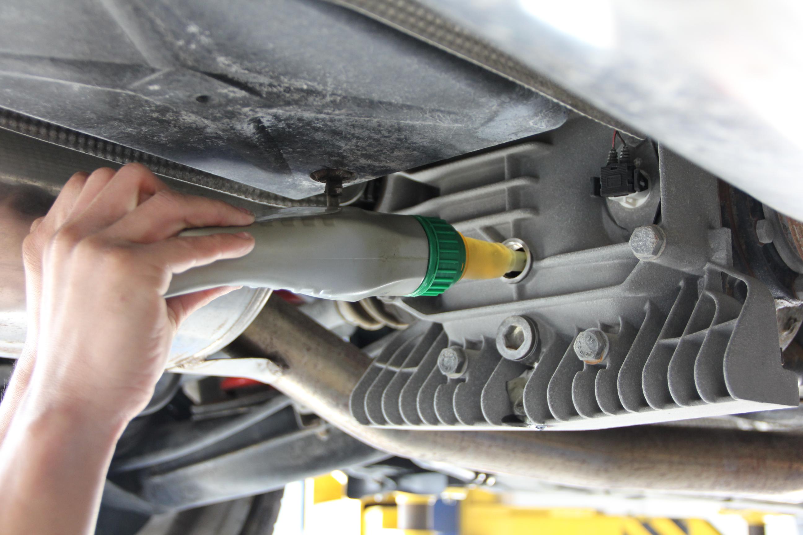

Fresh Diff/Final Drive Oil Going in. Man this diff was hungry, Took almost 3 complete bottles.....
All Done And Cleaned Up.....

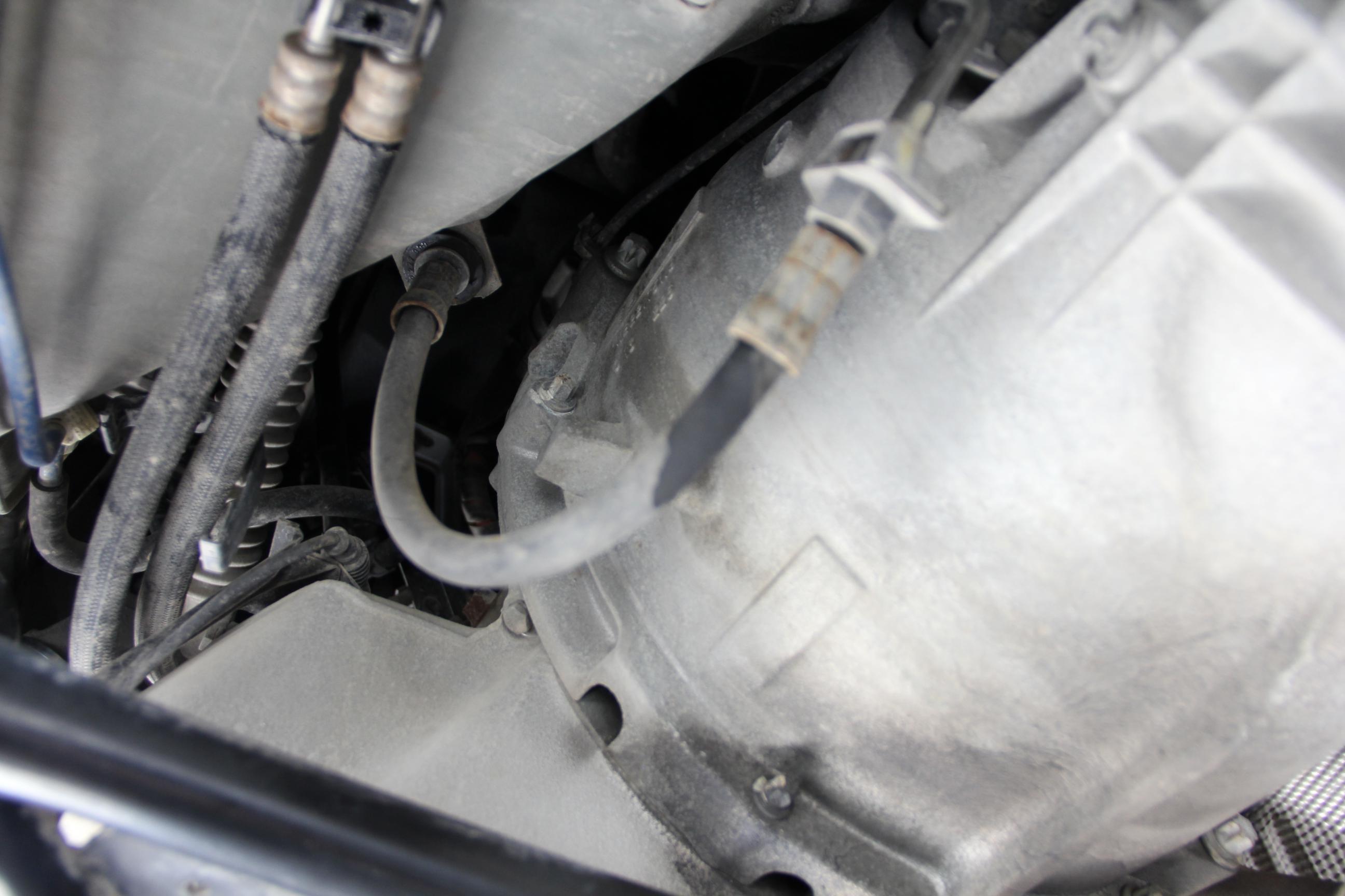

Damaged Rear OEM Brake Hoses which have degraded over the years. They will be replaced with
Stainless Braided Brake Hoses all around for long life and excellent pedal feel.....

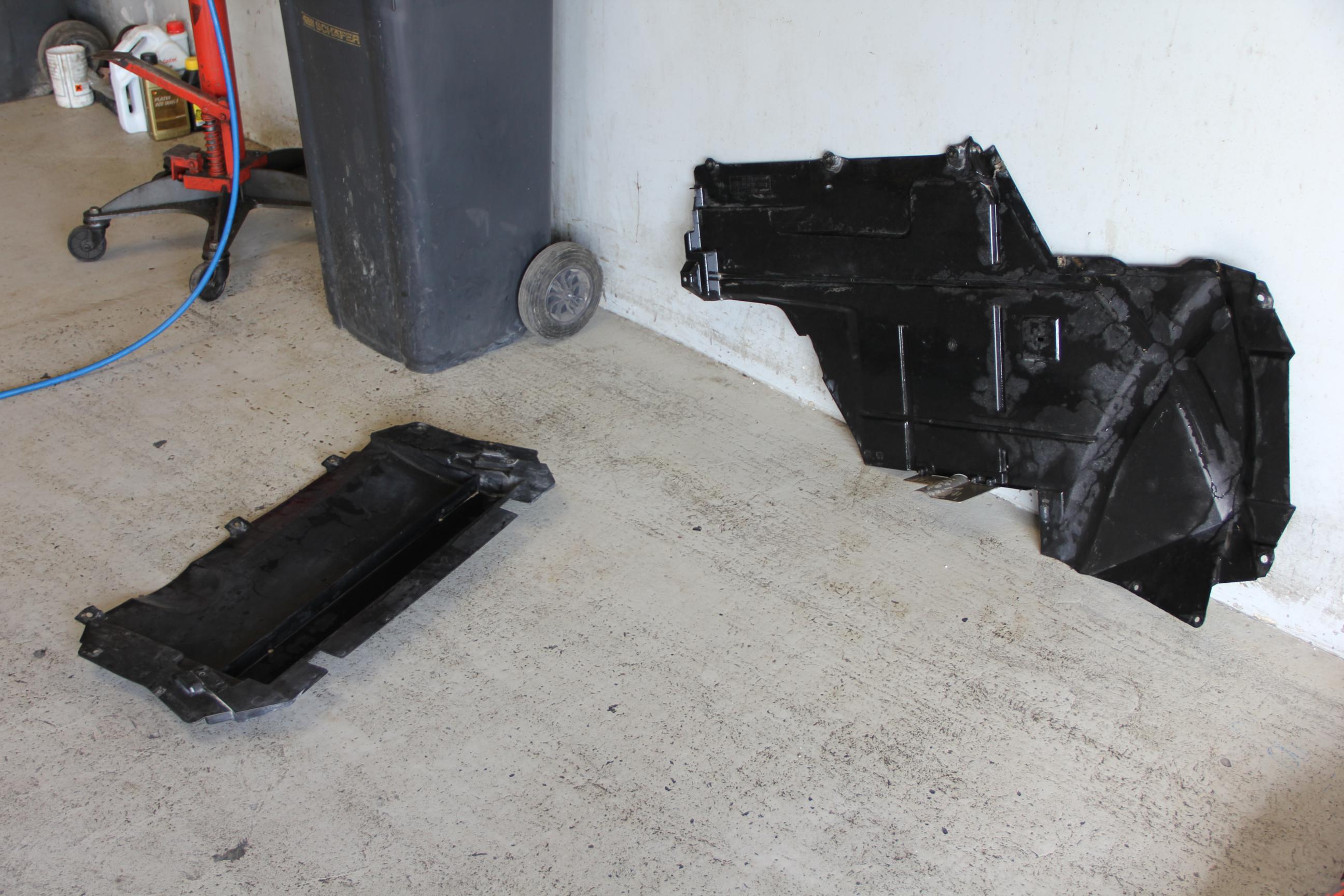

Under Carriage Covers All Cleaned Up.....

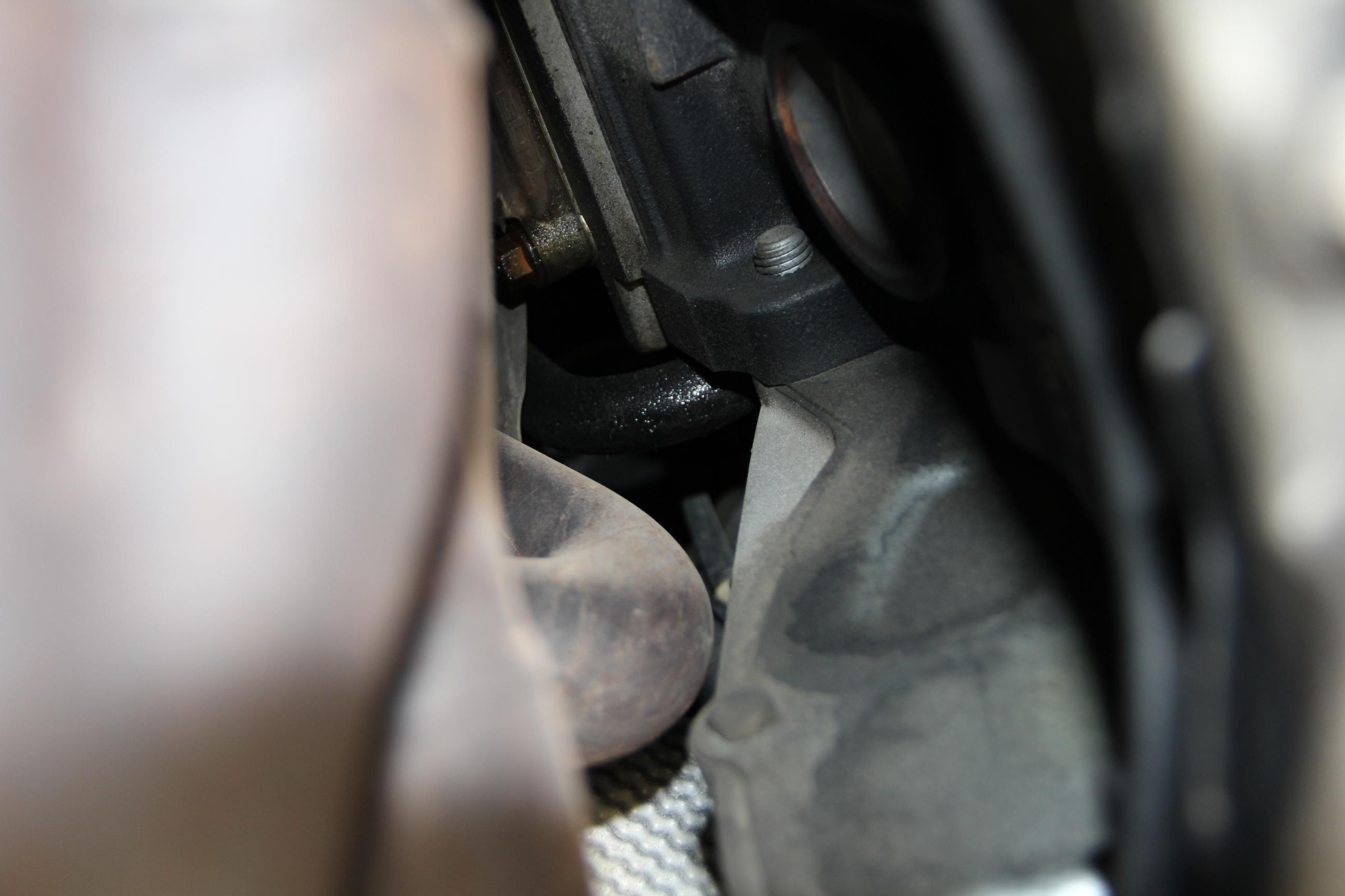

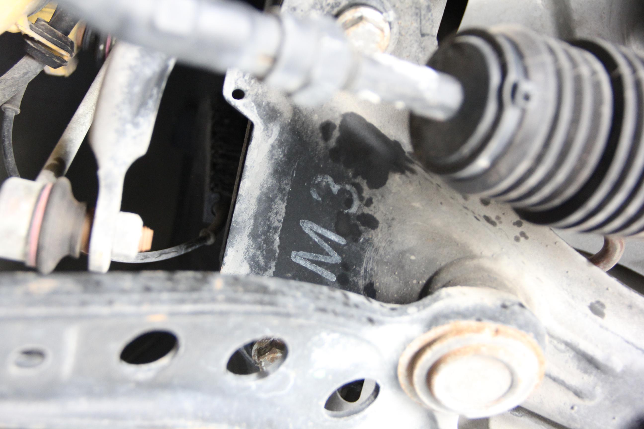

Discovered a Sneaky Leak While I was under the car..... It is coming from the back of the Valve Cover and
also a little leak from the pressure valve on the side of the block. New Valve Cover Gasket and Pressure
Relief Valve have been ordered....
Clutch Line is old and starting to Leak. This will also be replaced by Stainless Braided Clutch Line
including CPV Delete.
