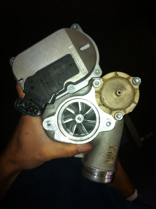

Another GT2 getting the EVOMS treatment at my fitment centre. His turbos just came back, check out the compressor wheel
Its getting a EVT 700 kit
Check out the Techart adjustable geurney flap. I have one being installed also

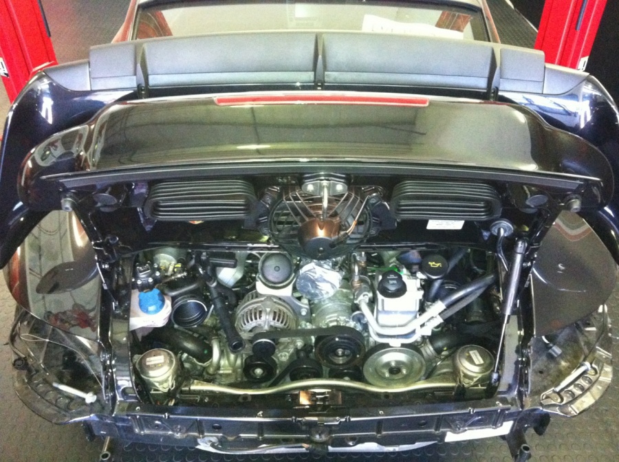

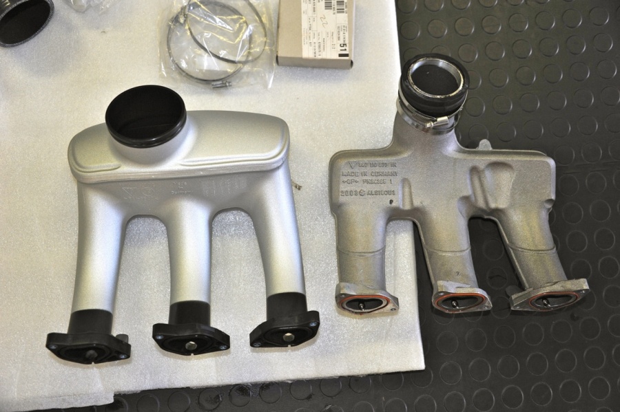

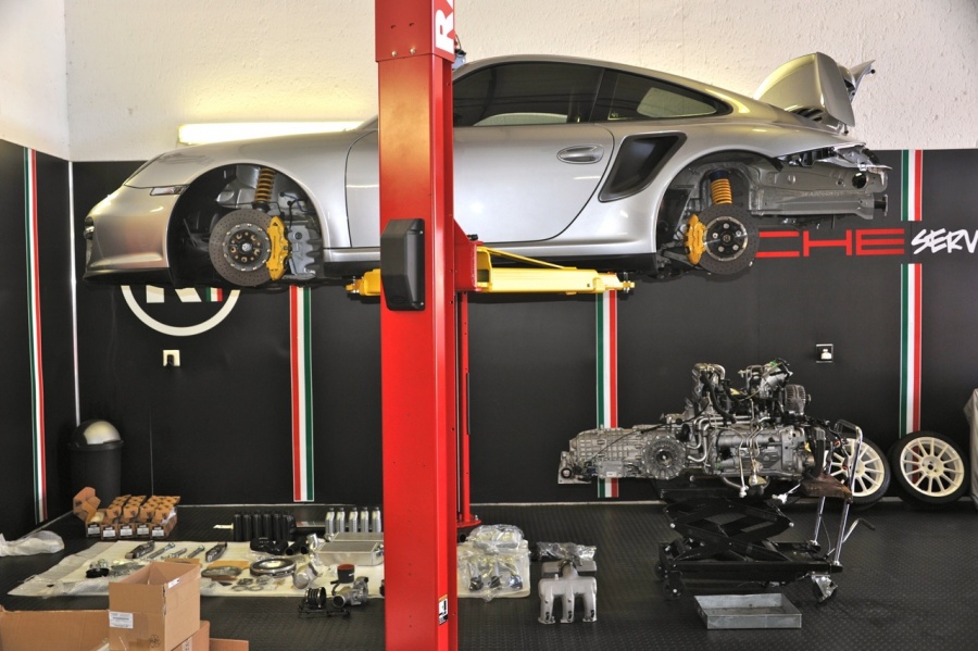

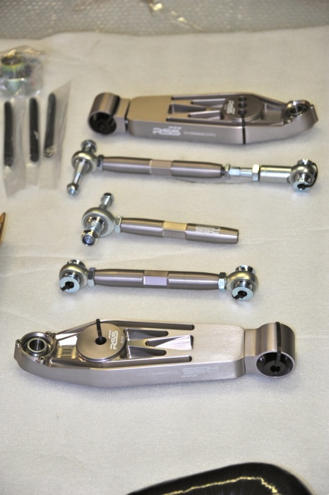

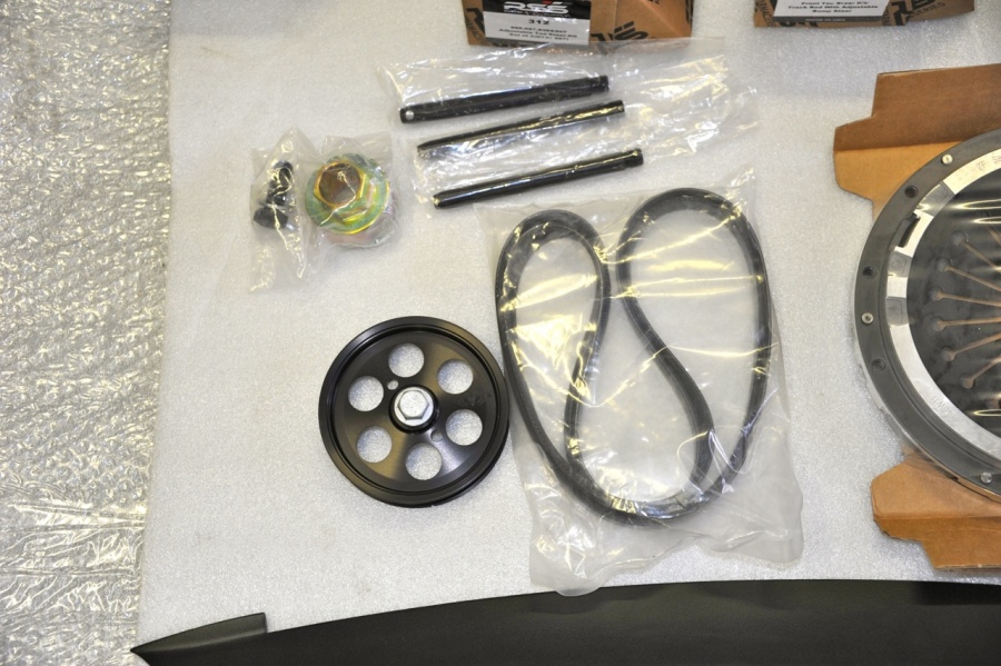

Parts going in. Will be complete by end of the weekend. Turbos being shipped back tomorrow from the US.
Here are some shots of comparison of OEM parts and the new EVOMS replacement parts.
Check out the diameter difference in hoses, IPD plenum, 82mm throttle bodies etc
RSS bits are laid out one of each part as we had limited space to unpack it all
Pics of install process will be taken and posted next week

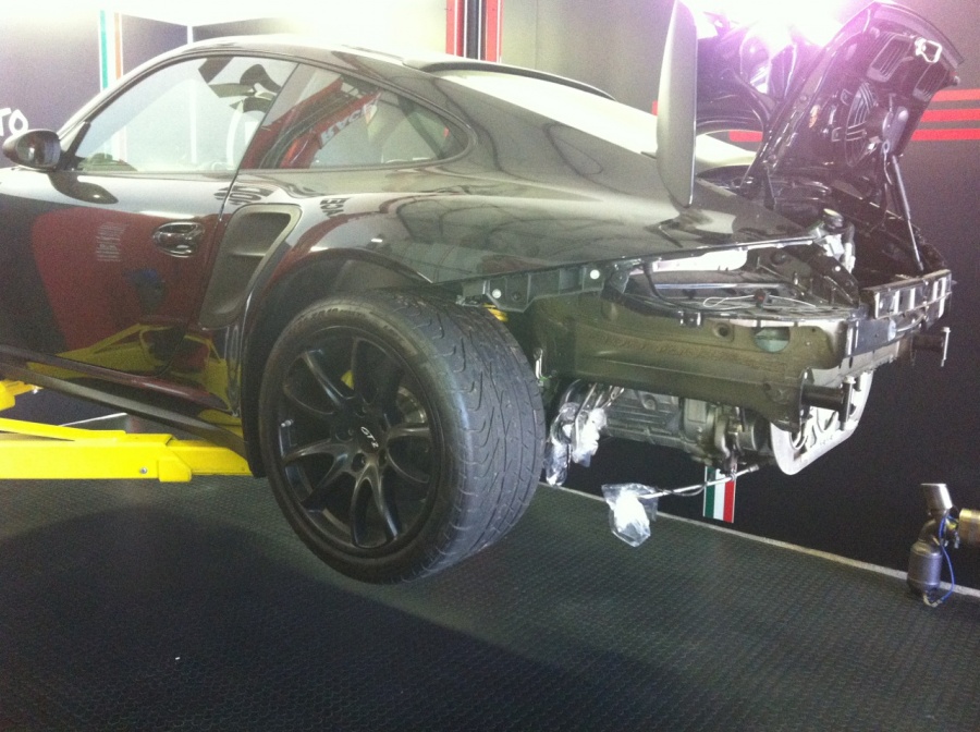

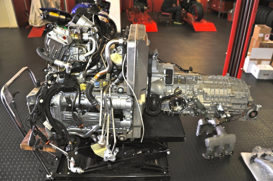

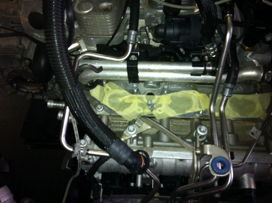

Secondary Air Injection
This is a little mod we doing on the car to remove a useless piece of crap:
Its called the secondary air injection unit and there are two of them which each sit on both sides of the engine near exhaust ports seen in pic 2
They pump additional air into the exhaust port to lean out fuel mixture to cause cats to warm up quicker. This us usually 180s max and there is a pump which creates additional air as well seen in pic 3
Removal of it and replacement of a machined aluminum block same size of the base of the unit saves approx 2kgs. It also allows for better air flow around motor with deletion of the unit and the pump seen in last pic.
With high boost applications it can cause the valve to fail so better to remove them as they are useless in warmer climates anyway
