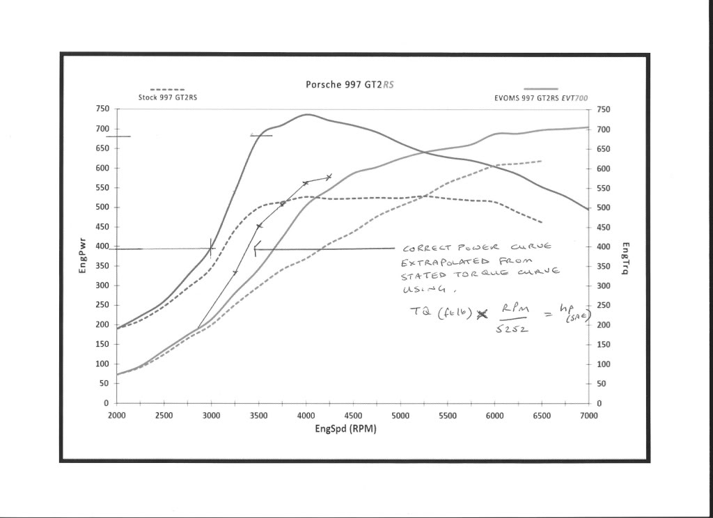

Do we have any more feedback from EVO as to how their power graph at 4000rpm reads 505hp which equates by formula (which is not subject to insane hype) to 898NM at 4000rpm ?
I am very disappointed and disturbed that a company which can and does push the boundaries for their 1 mile drag racers can produce the drivel below....
A GT2RS in the configuration they present cannot make more than about 660PS DIN - I have data logs of acceleration of one tuned to this level..... does EVO want to show their acceleration logs ? say 100-250kph ? (flat surface please no 6 bling slopes )

yeah but isnt he kinda right about the HP - TQ discrepancy on the graph? they are related by formula...

I know, I'm sad but things like this bug me
The power curve "works" over 4500rpm but below this is doesn't. IMO this is a chassis dyno attempting to measure too much turbo torque by calculating a value based on a 6 second light load dyno run and failing spectacularly...
This engine does NOT have 737ftlbs....
