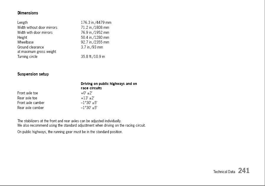

Not familiar with the .2 GT3 models but the older ones had a factory recommended track setup somewhere on the back of the owners manual. I'll try using that as my starting point and adjusting as needed. Don't change too many things all at once, it will only make troubleshooting far harder.

Am at work now so the only source of the manual I have right now is the US version. It does mention however the recommended alignment.
