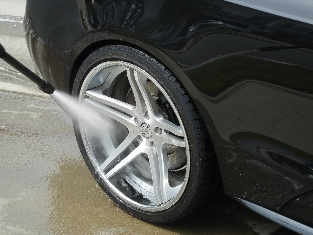

Everyone's favorite foul-smelling ainkiller: wheel cleaner, Sonax, was used first to get most of the brake dust and grime off the wheels. This got the wheels mostly clean, but David went a few extra steps toward the end of the detail. I'll explain more later...

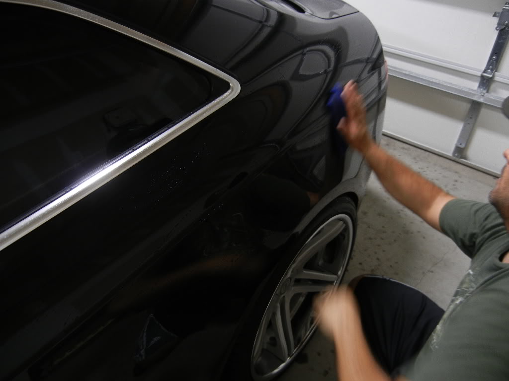

After washing and drying the car, I had my first chance to try the new Speedy Prep Towel. Bryan Burnworth recommended using it on glass for a few minutes to break it in before using it on paint, so we did. All I can say is...goodbye clay bar! I love this towel, it really moved the whole decontamination step along quickly. It didn't leave any noticeable marring, but the finish was pretty hammered anyway, so it was hard to tell.

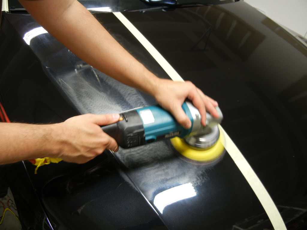

Once the car was ready for polishing, we got started trying to find our best combo. Multiple combinations of D300, M105 and M101 where used along with MF pads and Megs burgundy pads. For polishing, we used M205 on a white LC pad.

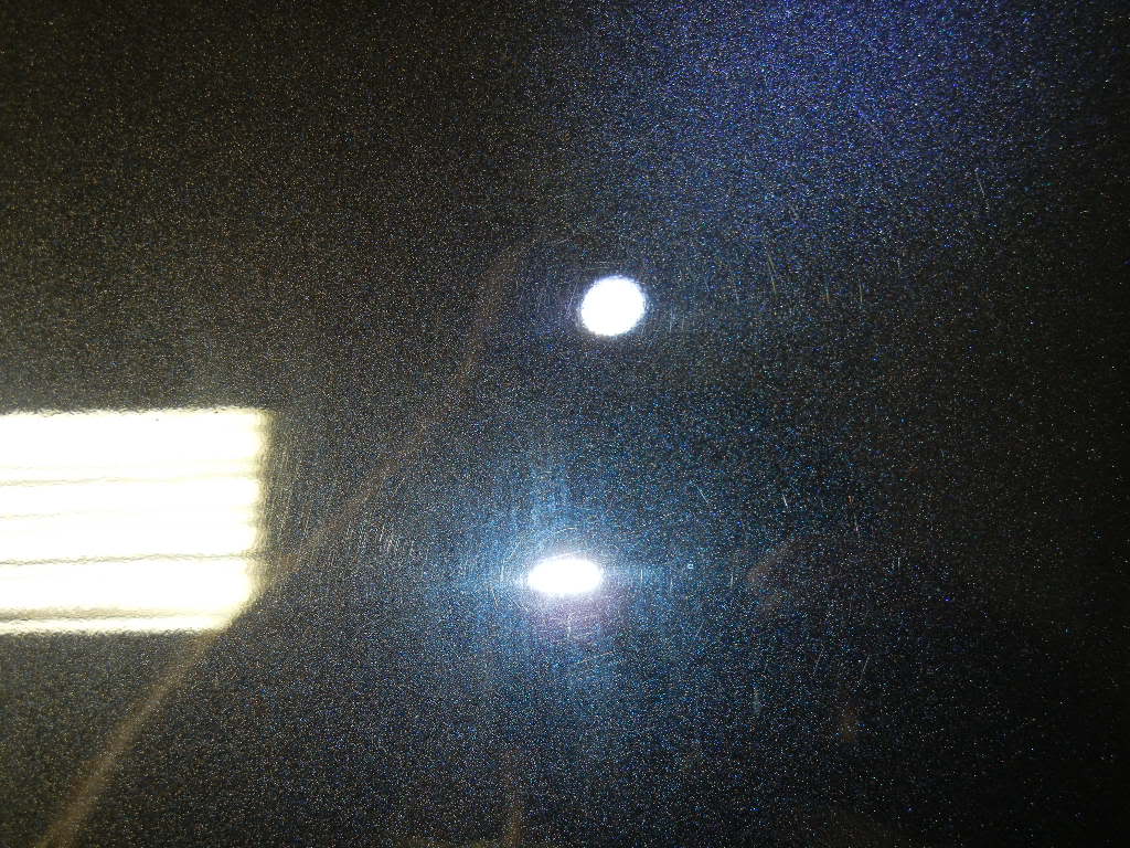

Before

After shots are after compounding but before the final polish. Most are with LED or camera flash since the sun wasn't cooperating.
