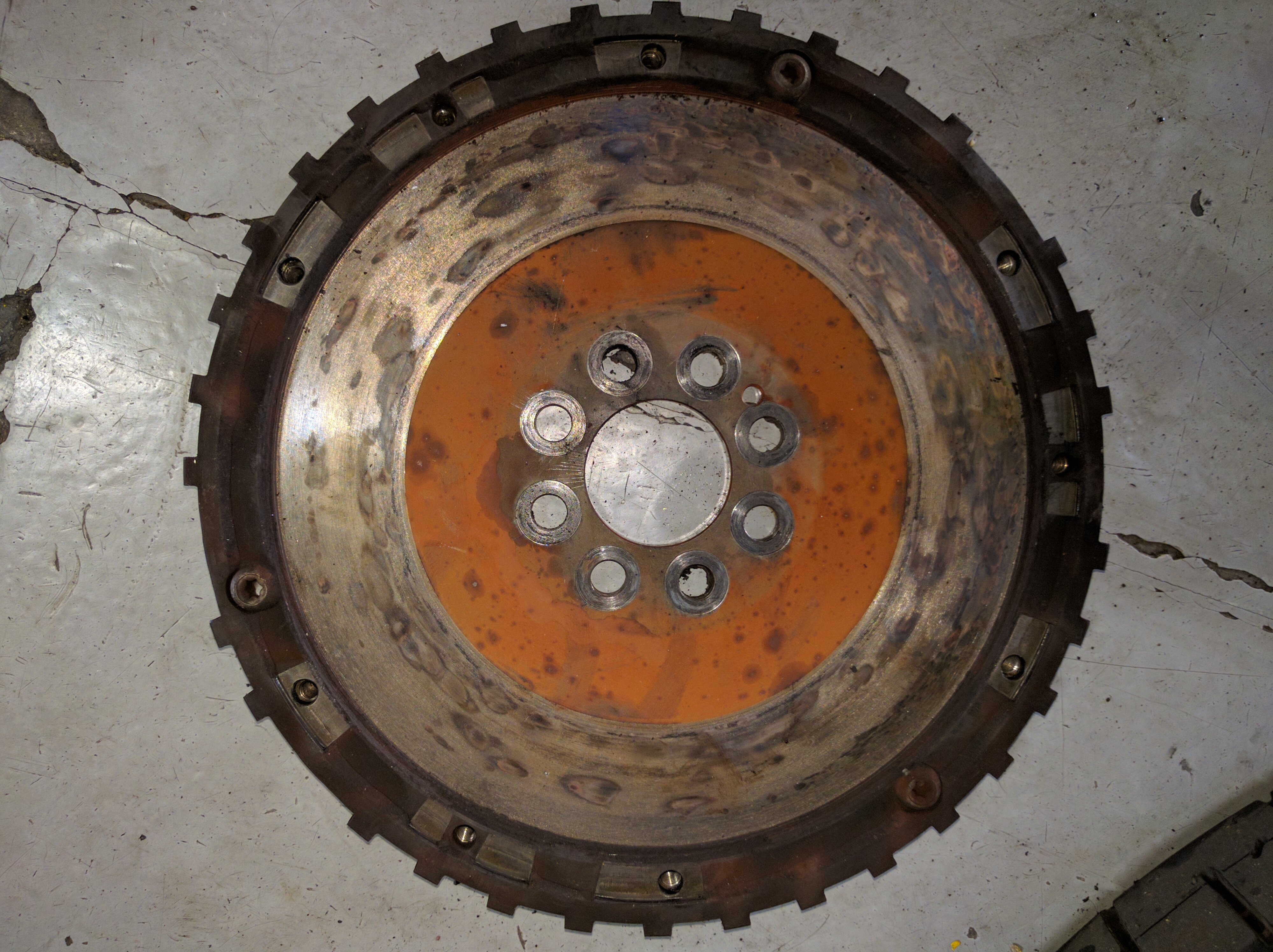

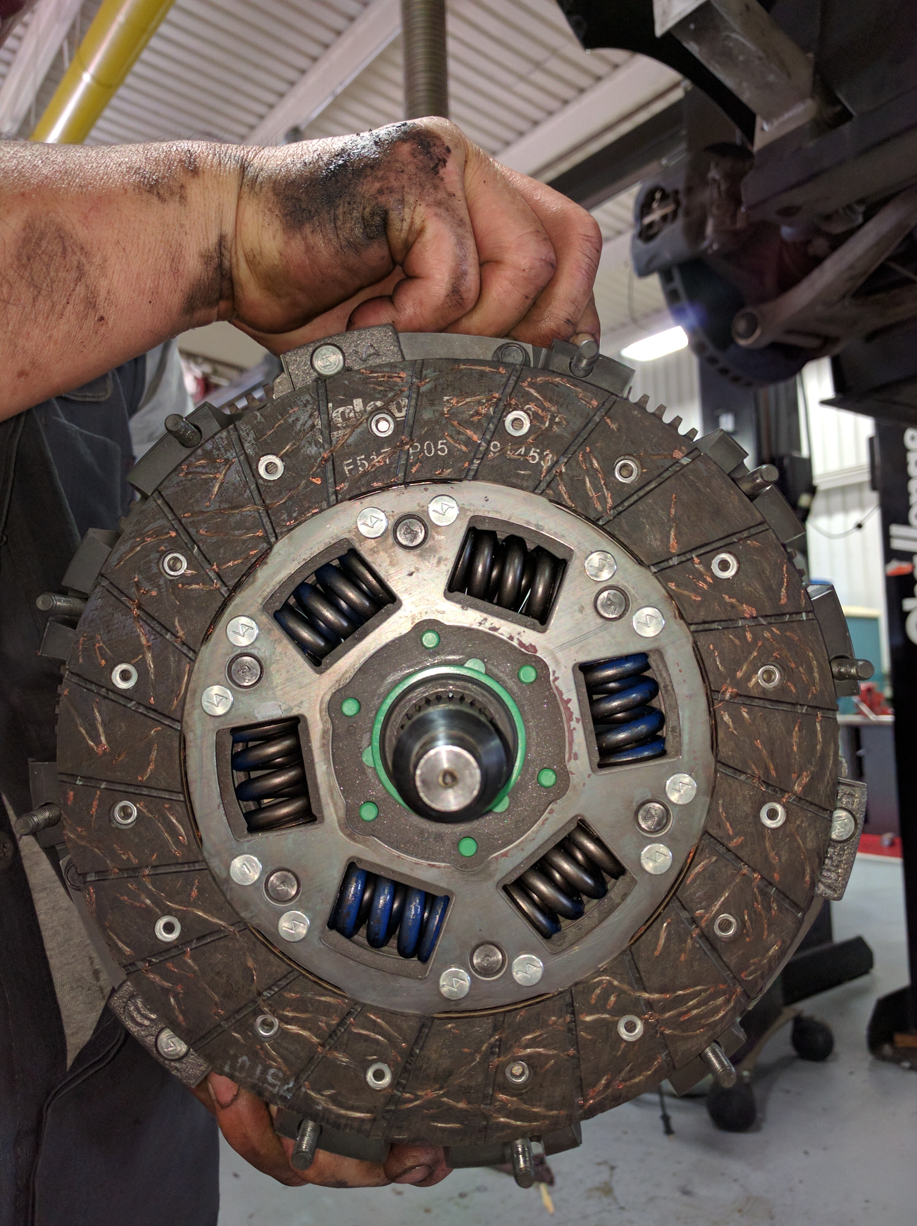

as of 2016-08-23 my car had done 107,894 miles on its original clutch
at that point snapshots were reading between 5.4 and 5.7 mm "worn"
and the TOB was leaking, leaving me with no 1st gear above 90 deg F,
no 5th gear above 100 F, and occasional engine stalls on 1st-to-2nd --
a bit challenging to drive on my 1k mi road trips to the Sierra Nevada
I made it to Concorso... and (with a lovely round of stalls when exiting
the golf course onto the city street where a bunch of folks were filming
cars as they left) back home... and to the shop for the big one, at last!
the old clutch still had a tiny bit of life left: the groves where still there
except for a few bald spots on the outer edge -- with road trip drives I
could have made it for another 1-2k mi i.e. to 110k mi total... which is
exactly what the regular E-gear snapshots were predicting for years
went with a factory rev F clutch, a new TOB, and a new position sensor
the replacement job went smooth, as expected, performed by/at LGLC
I was able to watch the installation of the clutch assembly and the TOB
in person, and take lots of good pics/vids in the process -- thumbs up!
immediately went on another 1k mile road trip the next weekend...
so there you have it -- ~108k mi on my original/1st rev F clutch
