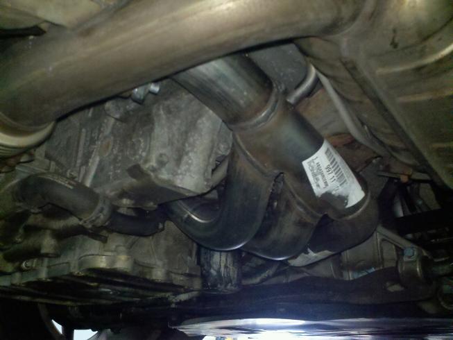

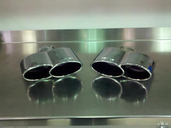

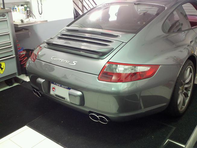

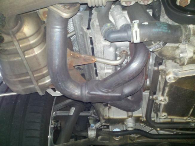

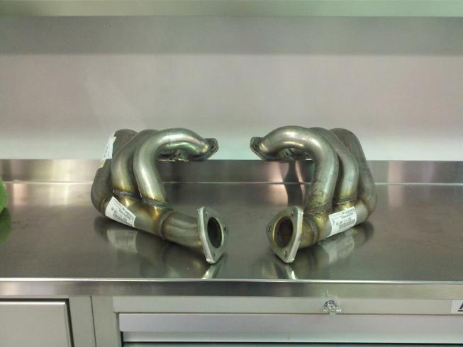

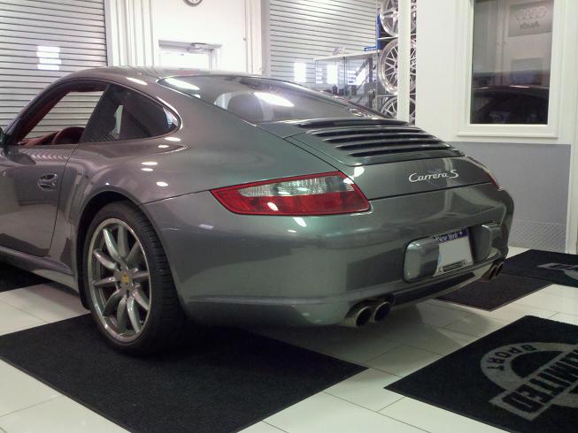

Here is a customers 2008 997 C2S we did some mods to. We installed X-51 headers, performed the popular "Gundo Hack" to the mufflers and topped it off with Techart polished tips. We also added a Techart Type I rear spoiler for a subtle appearance change.

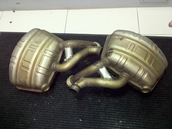

Looking good, question though...what's a gundo hack?
Old Mar 4, 2011 | 11:28 AM
SpeedLimit?'s Avatar
Posts: 1,837
^^^I think they gut out the factory mufflers for better sound
Old Mar 4, 2011 | 11:53 AM
Rich@unlimitedautosport's Avatar
Posts: 40
From: Oyster Bay, NY
Rich@unlimitedautosport You are a Teamspeed member that Rocks!Rich@unlimitedautosport You are a Teamspeed member that Rocks!Rich@unlimitedautosport You are a Teamspeed member that Rocks!Rich@unlimitedautosport You are a Teamspeed member that Rocks!Rich@unlimitedautosport You are a Teamspeed member that Rocks!Rich@unlimitedautosport You are a Teamspeed member that Rocks!Rich@unlimitedautosport You are a Teamspeed member that Rocks!Rich@unlimitedautosport You are a Teamspeed member that Rocks!Rich@unlimitedautosport You are a Teamspeed member that Rocks!Rich@unlimitedautosport You are a Teamspeed member that Rocks!Rich@unlimitedautosport You are a Teamspeed member that Rocks!
The "Gundo Hack" is a modification to the stock mufflers which gives a deeper exhaust note similar to the factory PSE sound. As you can see in picture #7 there is a 2" stainless steel pipe welded in between the muffler inlet and outlet.
