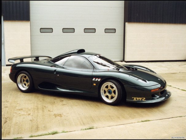

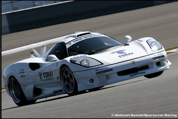

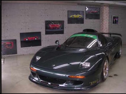

Boxer, the information I have at the moment is that a wealthy Japanese individual purchased a number of XJR-15’s for resale in the Japanese market. To the best of my knowledge the cars were not produced to compete at all. That said, one of the cars was cannibalised by a university to produce a racing car, but I don’t know if this started life as an LM. Strangely however, my blue car was originally exported to France and from there it went to Japan. Consistent with the Japanese buyer, my car was bought by a guy who purchased a number of XJR-15’s. I hope that one of these days he might disclose some information about the car. From what I have gleaned thus far, I think that all of these cars were amongst the last produced. I will try to upload pictures of the LM’s I have identified, but I am having trouble uploading pictures to the thread.

A few LM's

The white one in the lower right hand corner picture is very interesting. Looks almost like a cross between a F40 LM and a XJR-15.

There were 5 LM cars converted for a wealthy Japanese gentleman. This deal included the handing over of suitcases of cash the exact details of which have been published elsewhere. The LM's were converted by XK Engineering who did much work at that time for TWR and was under the management of Neal Smith. The XJR15 engines where changed for complete rebuilt 91 Le Mans engines at 7.4L They retained their slider throttle valves and the extra height (particularly at the rear) was overcome by using the scoop somewhat similar to the XJR14, but not the same as. There were apparently 60 detail differences in the LM's from the gold wheels to the arches, some subtle some very obvious.
