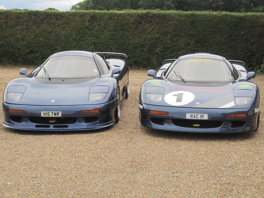

A few pictures

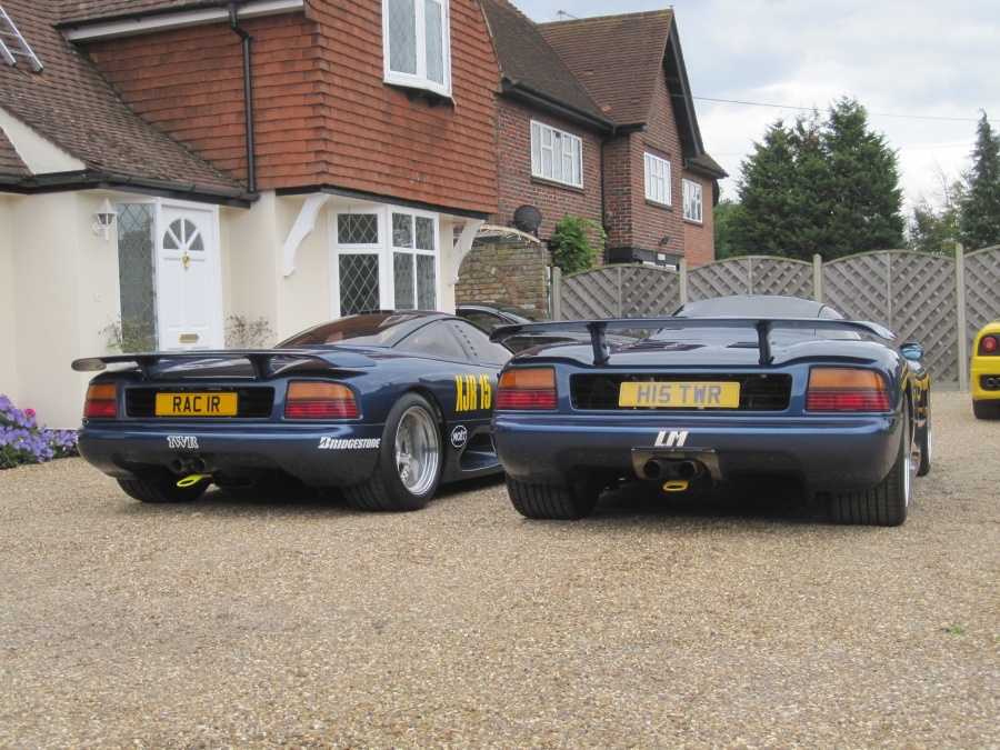

More pictures

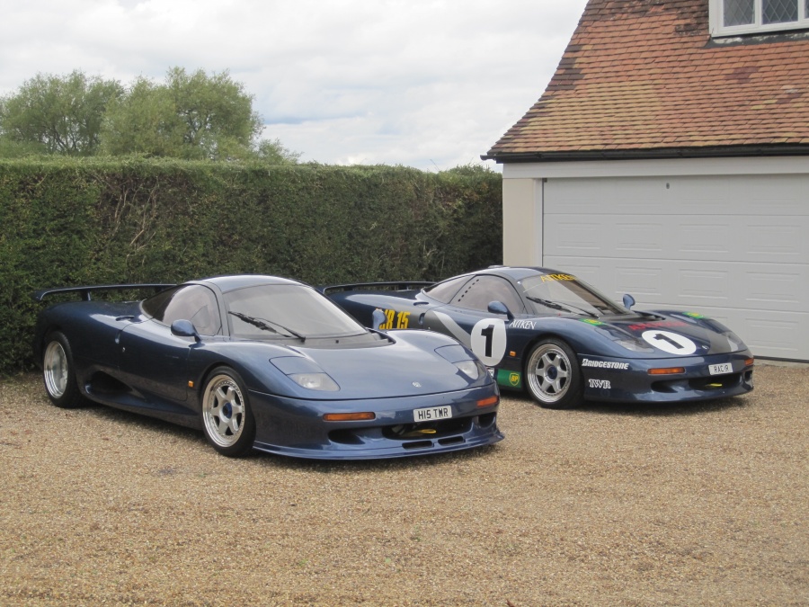

From above
