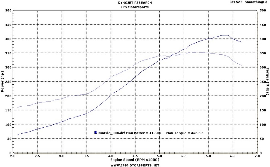

Thanks for the kind words again guys. I have attached a dyno sheet, as you can see the power is very linear. I have taken the car to 2 DE events, and it was very easy to gradually feed in perfect amounts of throttle while exiting a corner without any sudden jumps in torque. The spoolup on the track was also great, there was never a corner exit where I felt there was any lag hurting me at all. On the street the car really starts to come alive around 3500 rpm, and the higher you rev it the better it feels, I wish I didn’t have to shift at 6500.
It is an extremely fun and rewarding car to drive since it is so light and responsive with great top end pull. Just last weekend I was following my buddy on his Ducati 1098 through some twisty back roads on a spirited drive, and we just had a blast. It makes a variety of very entertaining noises as well from the exhaust, turbo, wastegate, and blow-off valve. I have some videos of it but they are all pretty crappy, I’ll try and get something decent soon.
The only thing the car is missing is another 200RWHP. I have been involved with some pretty powerful projects in the past, and this car with 600 at the wheels weighing only 2900lbs would be ridiculous amounts of fun. The turbo/intercooler/ignition/standalone were all built/designed to shoot for this number, but of course the stock internals will not like it. So someday when I get the chance to build the engine internals, I will be able to throw in one of those stiffer wastegate springs I have sitting in the garage just waiting. Higher boost with the stiffer WG spring will help the spoolup as well, since only running 6 psi peak right now the WG starts to crack as early as 3 psi hurting my spoolup a bit.
