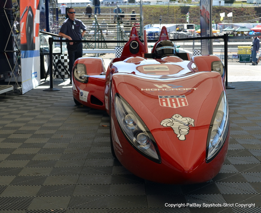

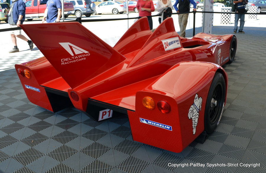

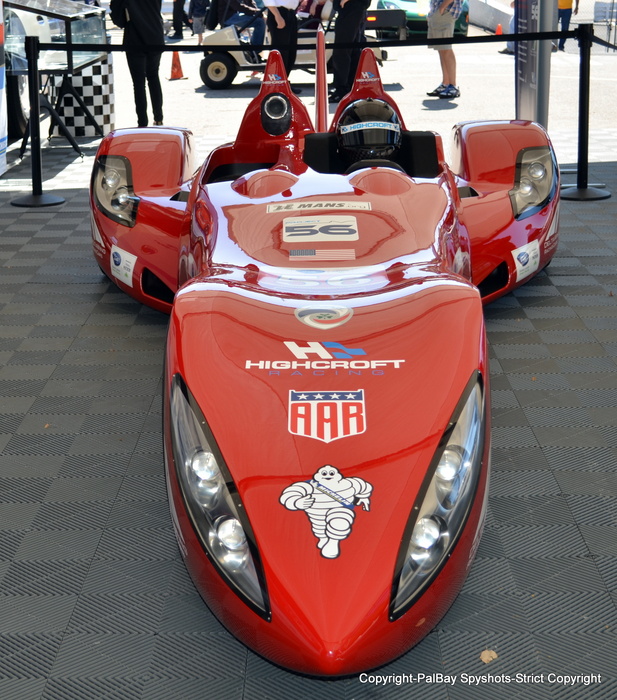

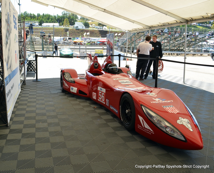

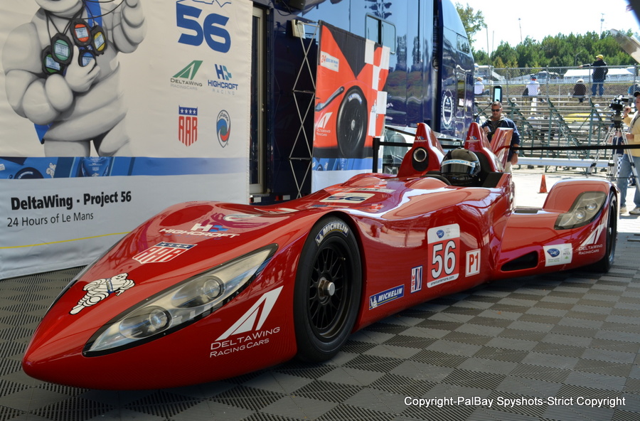

This is the actual 1st full size prototype of the Highcroft Racing DeltaWing LeMans car. Highcroft Racing was awarded the "Garage 56" slot at LeMans next year for the DeltaWing.Garage 56 is reserved for future automotive technology.The car will weight approximately 1,047 lbs and be powered by a 1.6 liter 4 cylinder turbo gasoline engine w/ around 300hp.EMCO Gears out of Chicago was just awarded the contract to build the 5 speed tranny.It will weight 70 lbs. No engine supplier has been named yet.The tranny will have torque vectoring to the rear wheels.The only downforce is generated by ground effects aerodynamics via the undertray beneath the car.It will be kidda crazy seeing this thing fly around the Circuit de la Sarthe next June.Is this the future of professional sports car racing....stay tuned. Thanks. PalBay

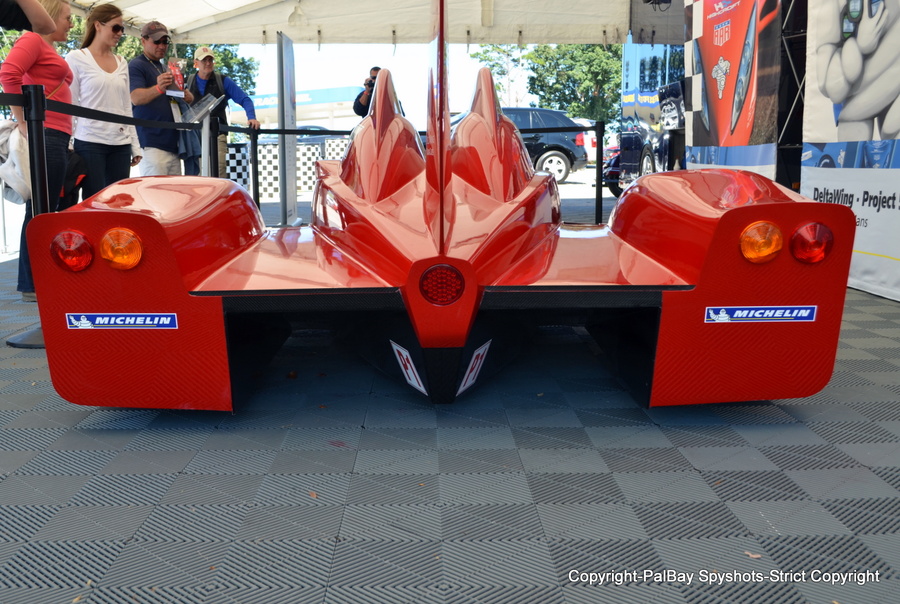

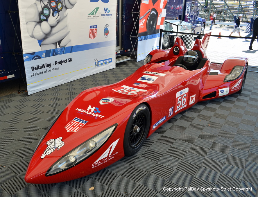

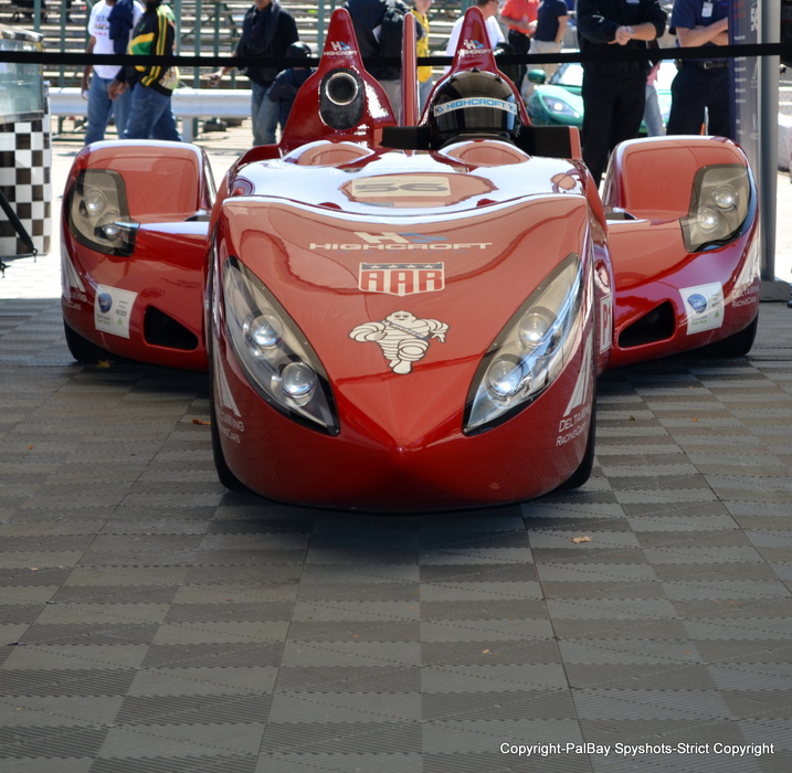

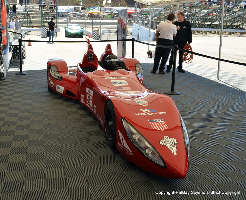

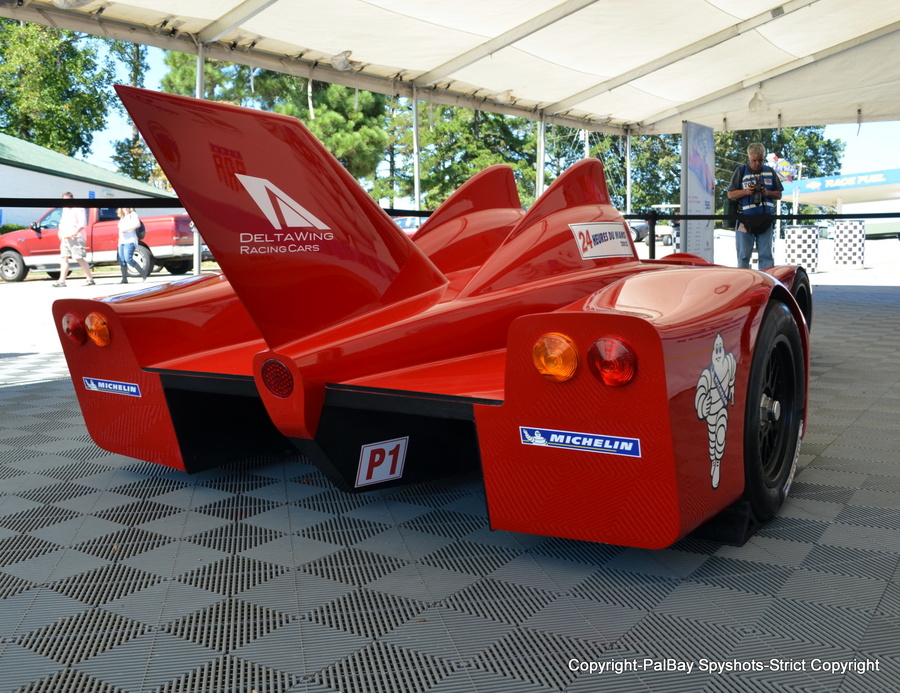

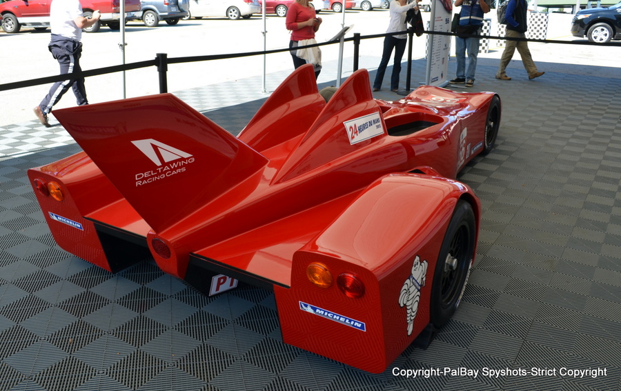

DeltaWing

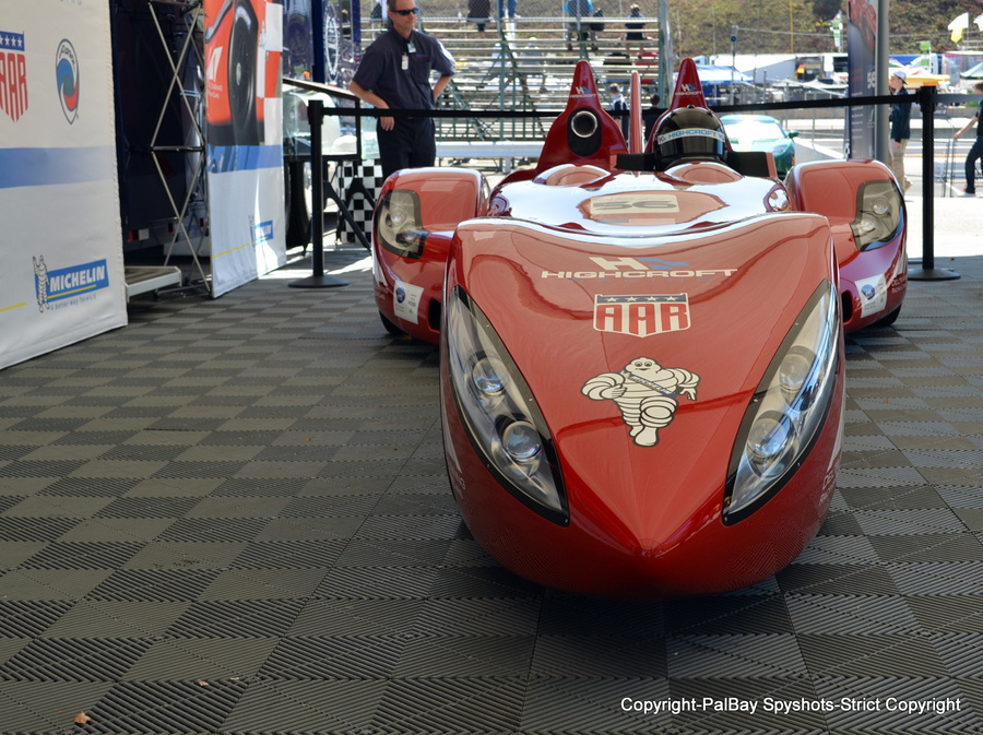

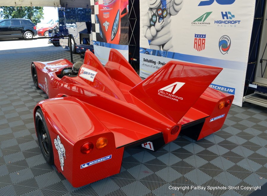

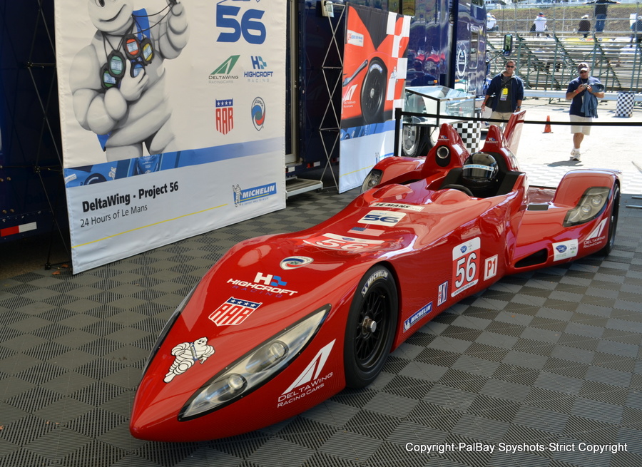

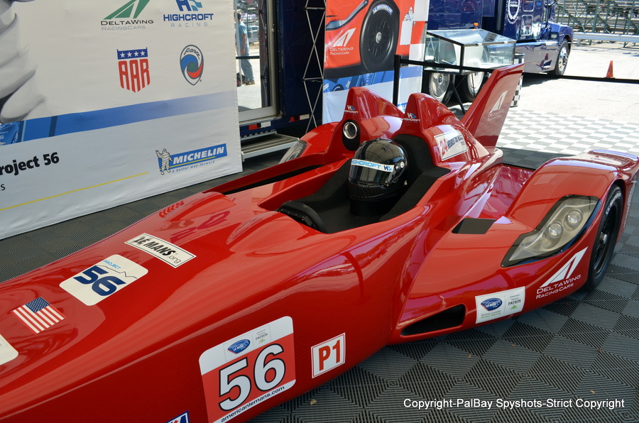

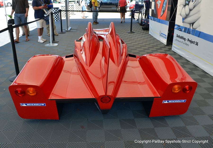

More shots. Thanks. PalBay
