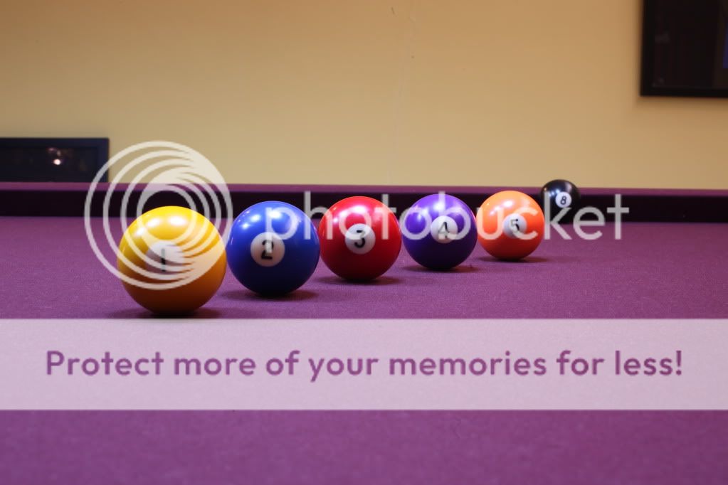

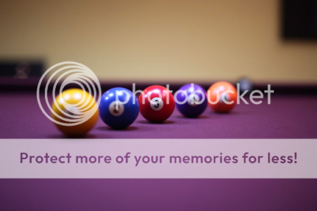

Here are a few pix to illustrate the relationship of aperture to the depth of field (DOF)...
Depth of field is the distance between the nearest and farthest objects in a scene that appear acceptably sharp in an image
Lighting inside the room was terrible but I still went with an ISO to 200. I had the camera set the shutter speed for me as I went through different f-stops to play with the DOF...
My focus point was the number 3
f 1.4
Notice how tight the DOF is, it is very much my focus plane... in other works as soon as you start looking at things in front or just behind the plane that the number 3 is in, you will notice its not sharp (look at the edge or ball 2 and ball 4).
f 3.2
Here you can see that the POF is widening, both ball 2 and 4 and sharper now
f5.0
POF is even wider/deeper
f10
Here all five balls are pretty sharp but not the 8 ball in the back
f16
Here you can see great depth but the shutter speed was 2.0 seconds due to the small aperture... so you will need to set the camera on something
