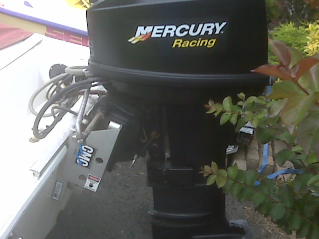

Hey,
Just added a CMC trim and tilt to my mini and was able to get about 4-5 extra MPH out of it. Had a 17 pitch SS on it and pushing 47. Just a heads up on that cool project.

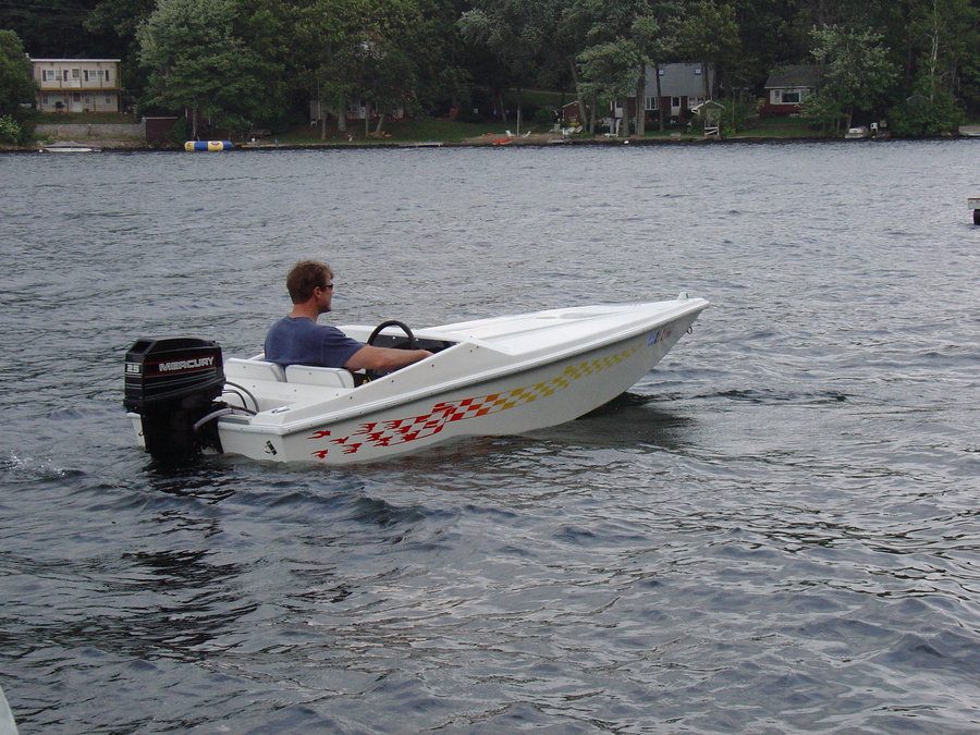

Before I added CMC
Old Shot before I added the CMC trim and tilt.

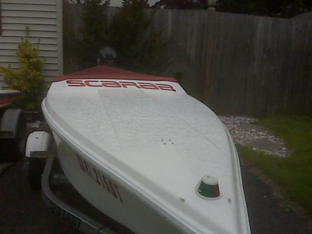

That's very nice! That boat (to me) seems to have a different deck/fairings then mine. What speeds do you get out of it?

The best I have seen was 47. I did try a new prop, a 28 pitch SS, but I wasn’t able to plane with that much pitch so I will have to depitch it and cut down the diameter to get this going. It should put me in the high 50’s after I get this prop to work. Who knows these boats are so lightweight that it may be possible to hit 60. It would be great to pass a bigger one in a mini. Yes the deck is slightly different then most mini’s
