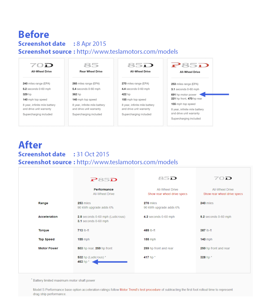

Tesla fixes incorrect 691 horsepower claim for P85D by publishing the correct number as 463 hp due to battery limited maximum motor shaft power.
Ever since the release of the high-performance Tesla P85D, its combined horsepower of 691 has been quoted liberally and loudly.
CEO Elon Musk confirmed the rating on “60 Minutes.” It was printed in a Tesla Model S brochure. And a multitude of automotive magazines and websites listed it.
But one group of Tesla owners questioned whether this number is accurate. In an open letter to Musk last month, the owners challenged Tesla’s statements on the P85D’s horsepower.
“We are writing to you as a group of concerned Tesla owners, investors, and perhaps most importantly, supporters … because the Tesla Model S P85D falls considerably short of actually making 691 horsepower,” the letter stated, which was signed by 71 Tesla owners.
Now, Tesla’s Chief Technical Officer JB Straubel discussed horsepower ratings for electric vehicles (EVs) on the company blog:
“There is some confusion about our methodology for specifying ‘equivalent’ horsepower ratings for our all-wheel drive, dual motor vehicles,” Straubel said.
Straubel also noted that, to calculate the overall horsepower of a dual-motor EV, the rating of the front motor was added to the rating of the rear motor.

First Tesla claim:. 691 hp motor power (221 hp front, 470 hp rear)
Fixed Tesla claim: 463 hp due to battery limited maximum motor shaft power (340 kW)
Now 90 hp (66 kW) power appears in official governments registration documents:
UK - V5 governments EU certificate led interpretation of ECE R85
Germany - official vehicle governments registration document/certificate acc. ECE R85
Acc. ECE R85 electric vehicles are tested for peak/maximum power and 30-minute-power (maximum power during 30 minutes test run).
So, the fixed claim seems to be the peak power and 90 hp (66 kW) the 30-minute-power.
