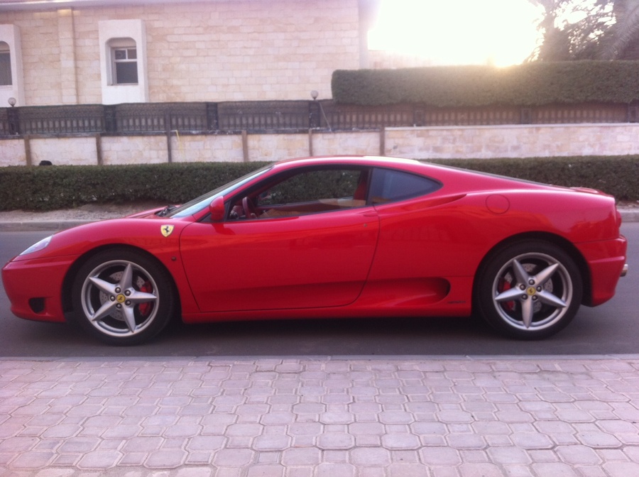

i put on 400km in 5 days
my impressions:
- ASR off =
- no idea what the guys were on about saying it's slow, getting up to 200kmh is a breeze really and effortless
- love how the power is always on standby without necessity for downshift, feels like a supercharged car with the 10k revs (comparing it to the SL55)
- ride is very comfortable, tbh i dare use the word 'smooth' even
- i love the steering wheel's thickness, very easy to navigate and very secure at speeds
- auto mode sucks, was never planning on using it of course just curious
- interior is spacious, but no space for your stuff
- car goes exactly where you want it to go, and positively goes in style if you the asr is off and you are throttle happy

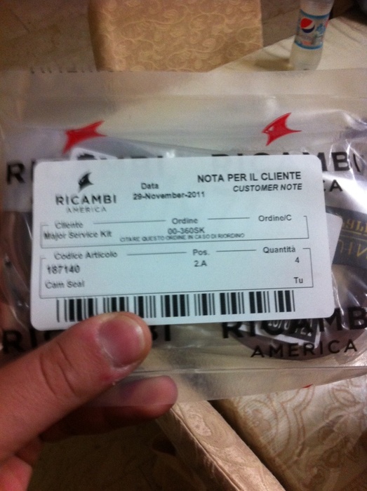

major service kit + head gaskets are with me and waiting on clutch/bearing/sensor to arrive, probably in 10 days. going to perform engine out to install new head gaskets and check on internals altogether whilst installing new clutch and co.
