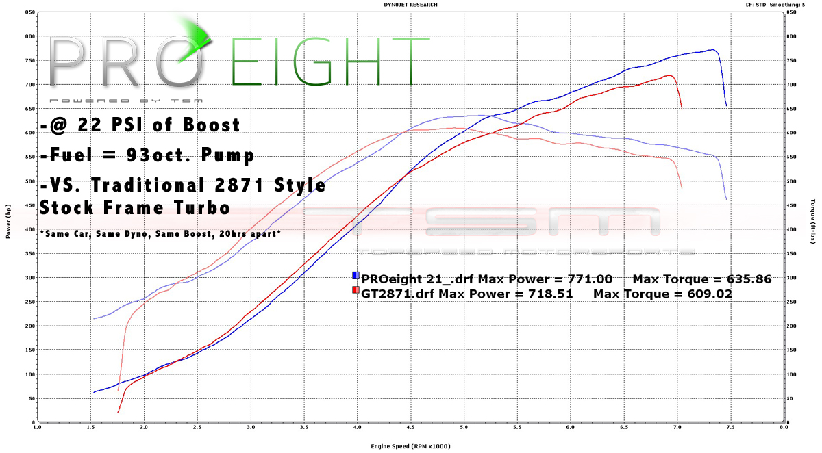

After our preliminary release of the TSM Pro Eight turbo package, we have received dozens of questions asking how these compared to a competing manufacture's turbos. Instead of making claims of how much power they make or comparing them to another vendors turbos, we decided to just lay all of the data on the table for everyone to see. We decided the best way to provide honest and accurate data for the community was to run a back to back test using the same car, the same supporting modifications with as similar conditions as possible. While I am not comfortable disclosing the specific brand of the turbo we are comparing, we will tell you that it is a known 2871 turbo upgrade for the GT-R.
So on Monday night we decided to throw the 2013 TSM test car on the dyno for a perfectly accurate baseline then on the lift she went. With our current work load here at TSM there is absolutely no time during normal working hours to perform this type of minor surgery. However I deemed it as something very important in order to provide accurate information to you guys. So to work we went. Much of the team worked tell 4am and then started again at 7am in order to make this happen. I have to thank my guys! I have such a passionate wonderful team behind me! So, out came the current 2871 style turbos and in went our TSM Pro Eights.

Test vehicle: 2013 GT-R
90mm Exhaust
90mm Y pipe
90mm Downpipes
3" Intakes
2.5" Turbo Inlet Pipes
FMIC
1000cc injectors
340lph fuel pumps
Cobb AP w/ TCM
OEM Engine
OEM Heads/Cams
DYNO RESULTS:

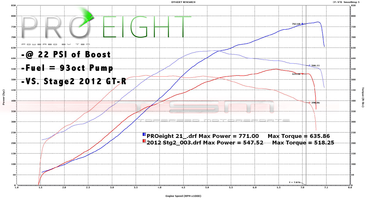

These dyno runs were done within 20hrs of each other, same tuner, same dyno, same car, same parts. Only change was the removal of the 2871 style turbos and installing our TSM ProEights. They are also at the EXACT SAME BOOST! As you can see from the log screen shot we got the boost level as close as possible between the two runs. As you can see from the graph the lag is very minimal. Giving up less than 10whp and 5lbs of tq below 4400 then the magic happens. The ProEight opens a very respectable gap all the way from 4400 to redline as you can see. A gain of 53WHP at the same boost levels is something we were very happy with!
All the data I could think to give you guys is below. Please feel free to ask any questions you like as I’m happy to share as much as I can. These turbos will be put to the test both at the drag strip and at the TX2k 2013 on a couple of our customers cars! As always expect real world results to back up what we build here at TSM!
