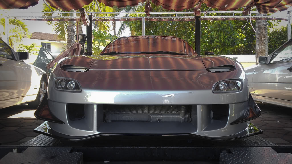

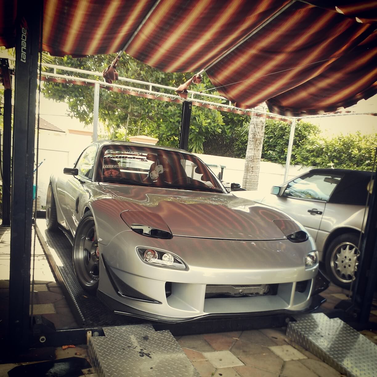

Old Nov 4, 2012 | 10:26 PM
  #93
curacaosfinest's Avatar
Joined: Aug 2012
Posts: 87
curacaosfinest is an unknown quantity at this point
the lift queen is almost done!!! should be firing her up this week!!! 2 more fittings, just 2 more fittings!!! the anticipation is killing me!!!!!

First off, love the build. The RX7 is one of those cars that even today could pass for a new car with it's body style.
This probably a dumb ass question (I can admit that, lol) but The headlights, not yet fitted or plan to leave the opening below the headlight casings open? If so will that not cause any drag?
Be sure to post a video when it's all full tuned, love to hear it.
thanks alot man
and dont worry man theres no such thing as a dumb question lol
I havent fitted the headlights in there yet, i will also be running brake ducting from the openings

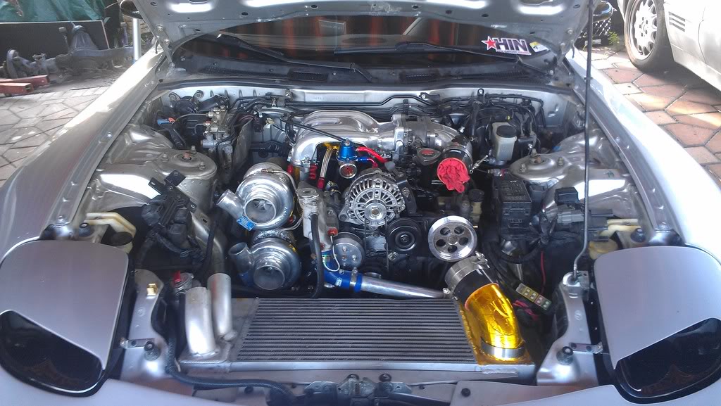

Old Dec 5, 2012 | 01:04 PM
  #98
Joined: Aug 2012
Posts: 87
finally have some updates for you guys!!
well good and bad updates sadly
the good is that the motor is all put back together...
i ran into a massive oil leak because of the rear oil return flange on the block, turns out there was an edge there i couldnt see and the flange ending up resting on the flange and didnt seal against the block, so i had to grind down an excessive edge on the flange and put it back together...everything is perfect with that now
I also made my first attempts at starting which didnt work LOL!! didnt really expect more than that though lol
it sounds like the motor is flooded so i'm going to pull the EGI fuse and turn it over a couple times to get rid of the excess fuel, clean up the plugs and give it another shot tomorrow
PICS AND VIDEO!!
the last pic of just the exhaust smoking which was pretty cool lol
