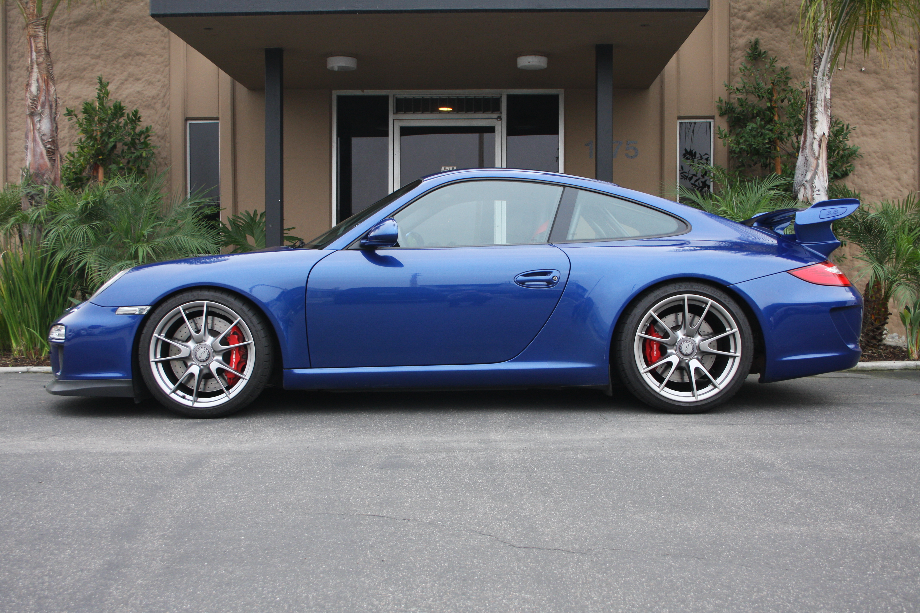

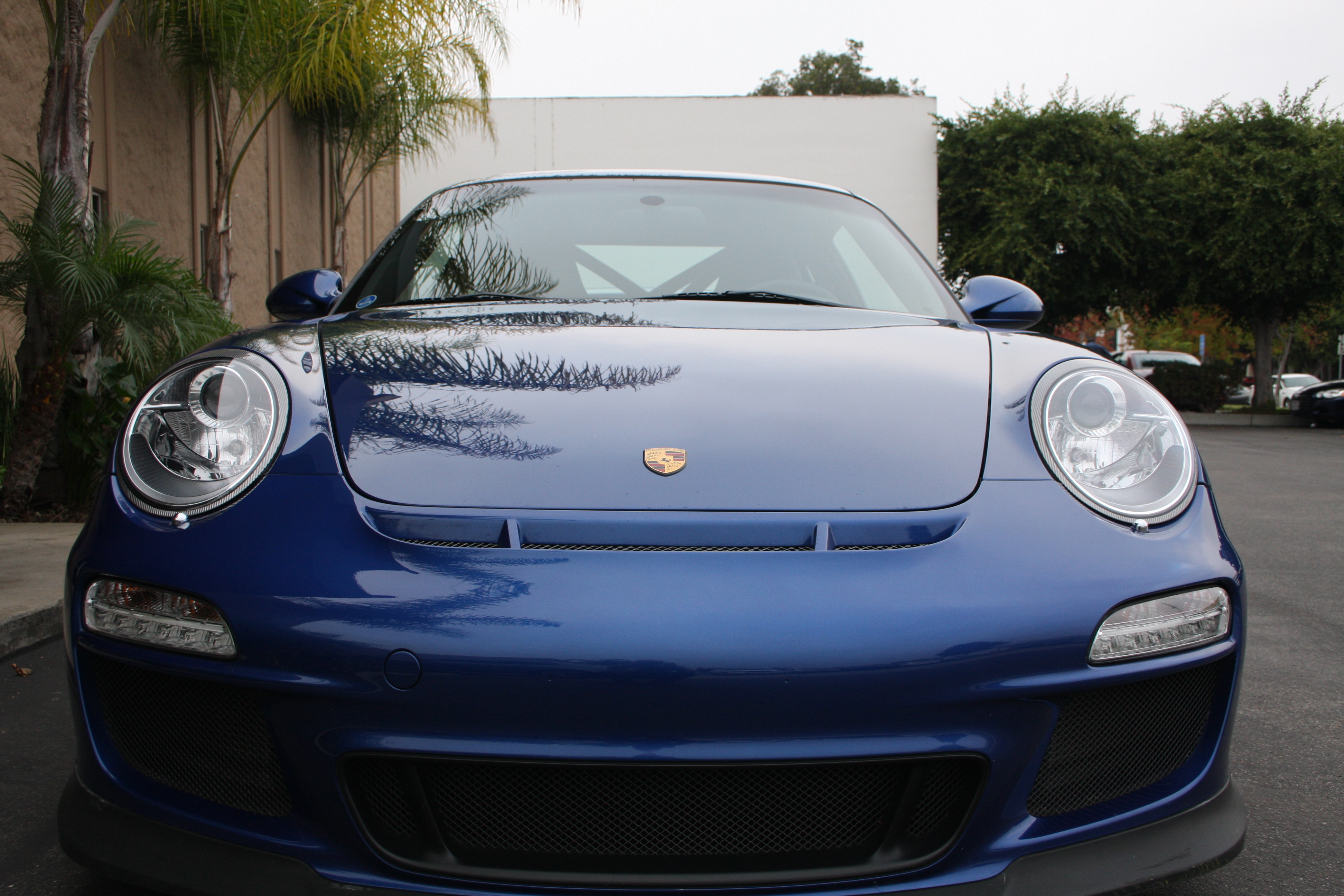

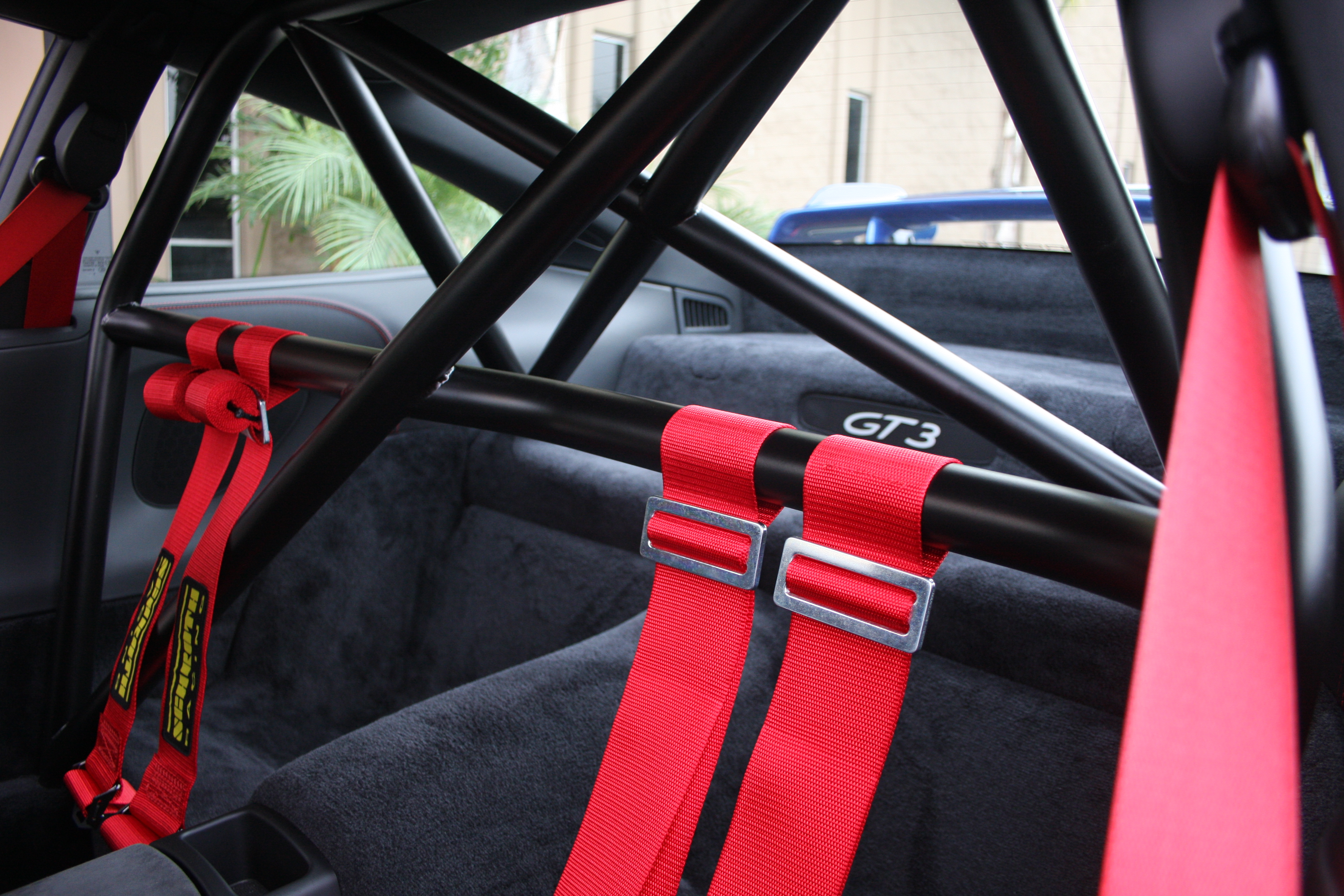

This Metallic Blue GT3 was delivered "fresh off da boat" from Hawaii, for some RSS Track Prep before its track-day at Laguna Seca. The owner’s goal was to improve the rear end handling dynamics, add a stout 4 point roll bar with harnesses, and top it off with a more aggressive track-day alignment.

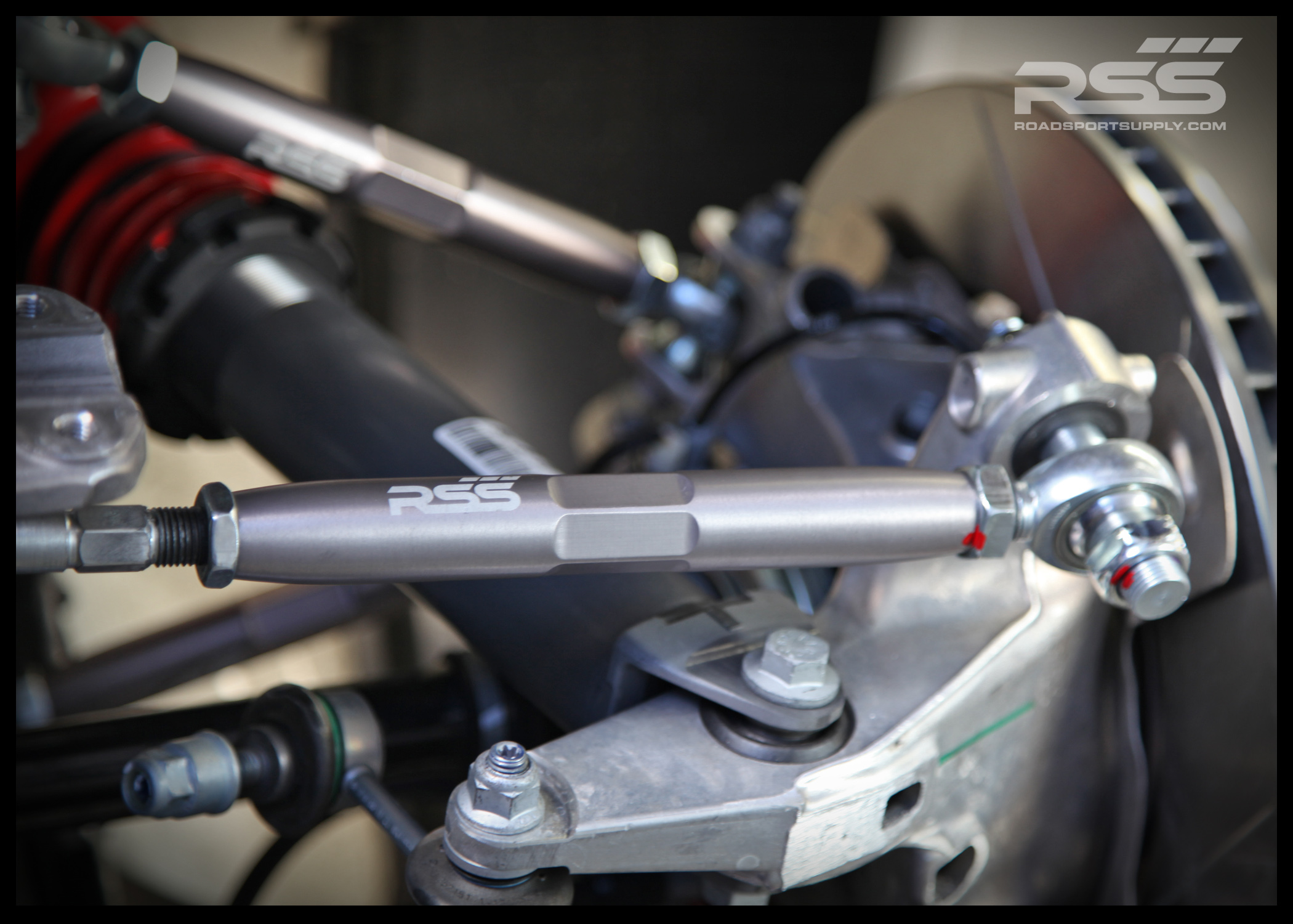

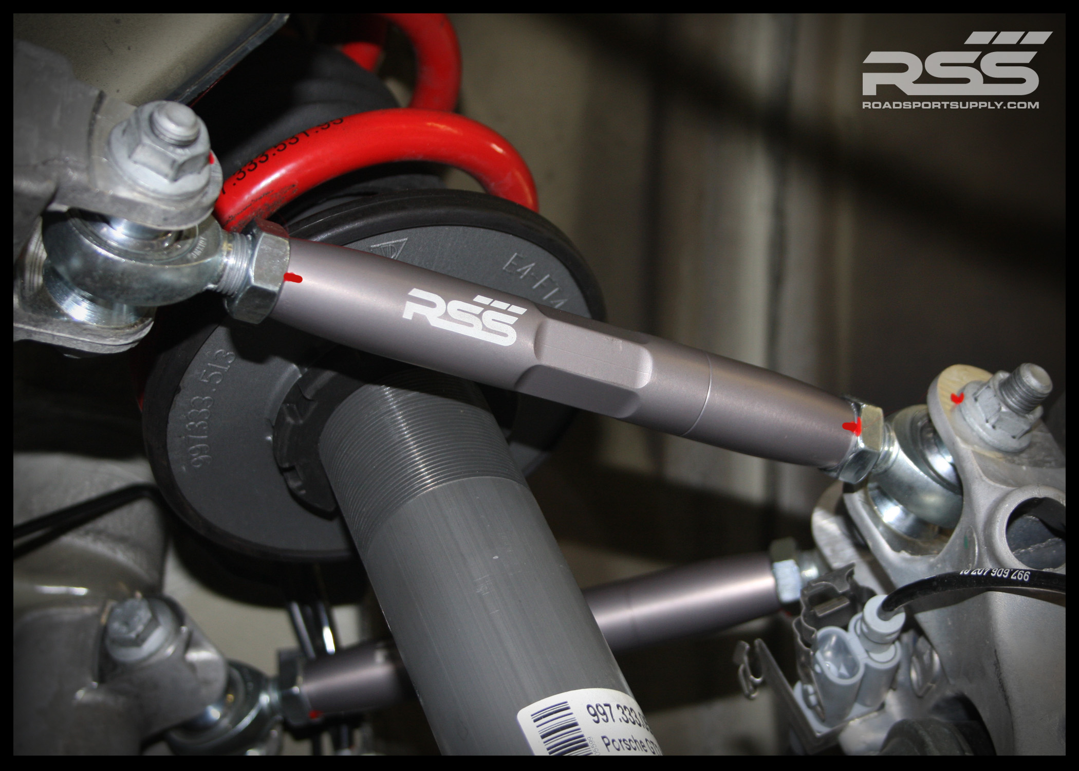

RSS Tarmac Stage 1. “Rear” Suspension Upgrade Package with RSS Alignment.
Part #312
• The RSS Adjustable Rear Toe/Bump Steer Kit[/B] is designed for Porsche vehicles that have been lowered. This kit will help minimize suspension geometry changes in the rear of the vehicle.
• Allows for additional toe adjustment at the toe steer arm giving the ability to make adjustments independent of the factory eccentric bolts which may not offer sufficient refinement.
• Our motorsport style monoball components will significantly improve handling, feedback and control while eliminating rubber bushing deflection.
• The rod ends are also height adjustable to help reduce/eliminate bump steer.

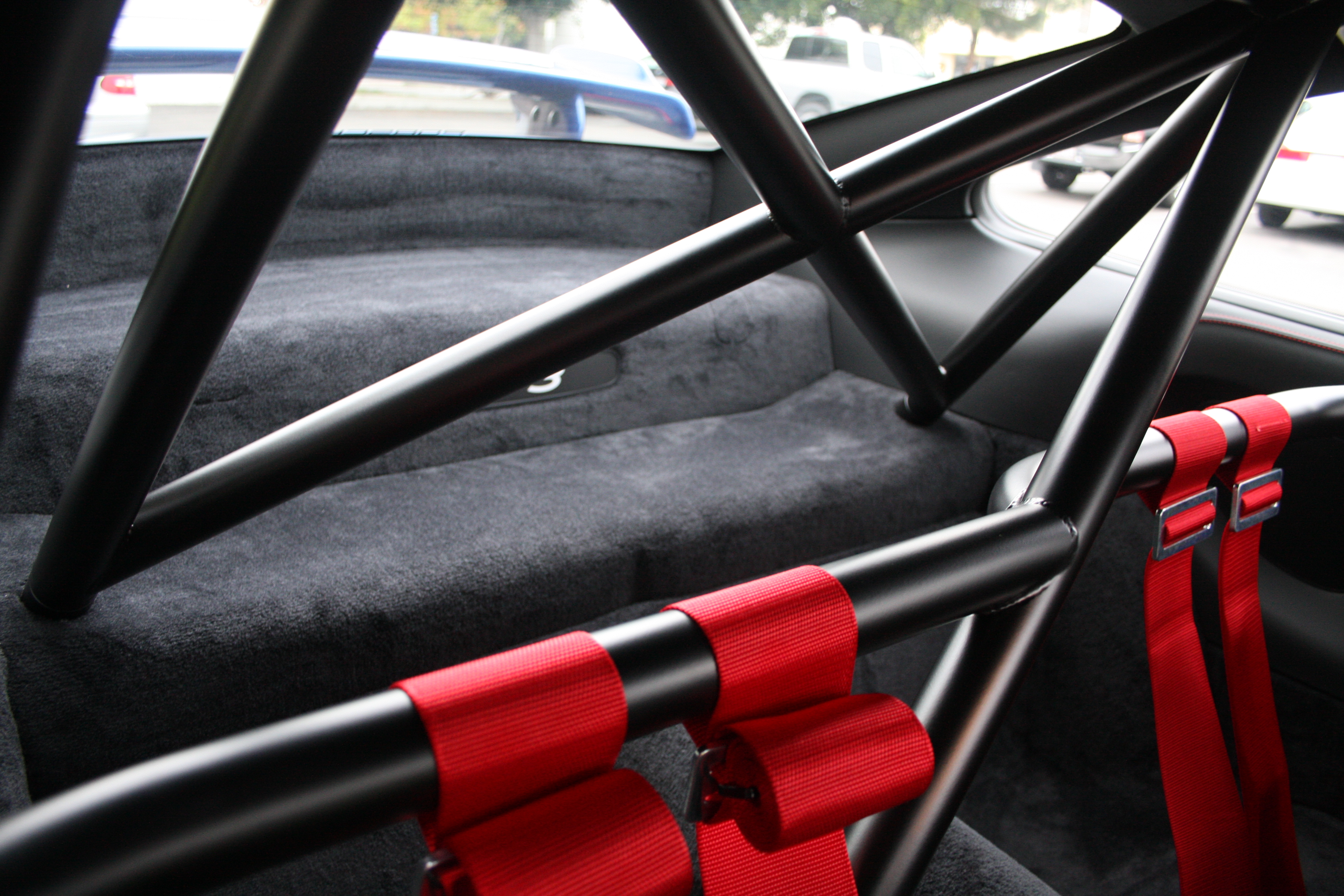

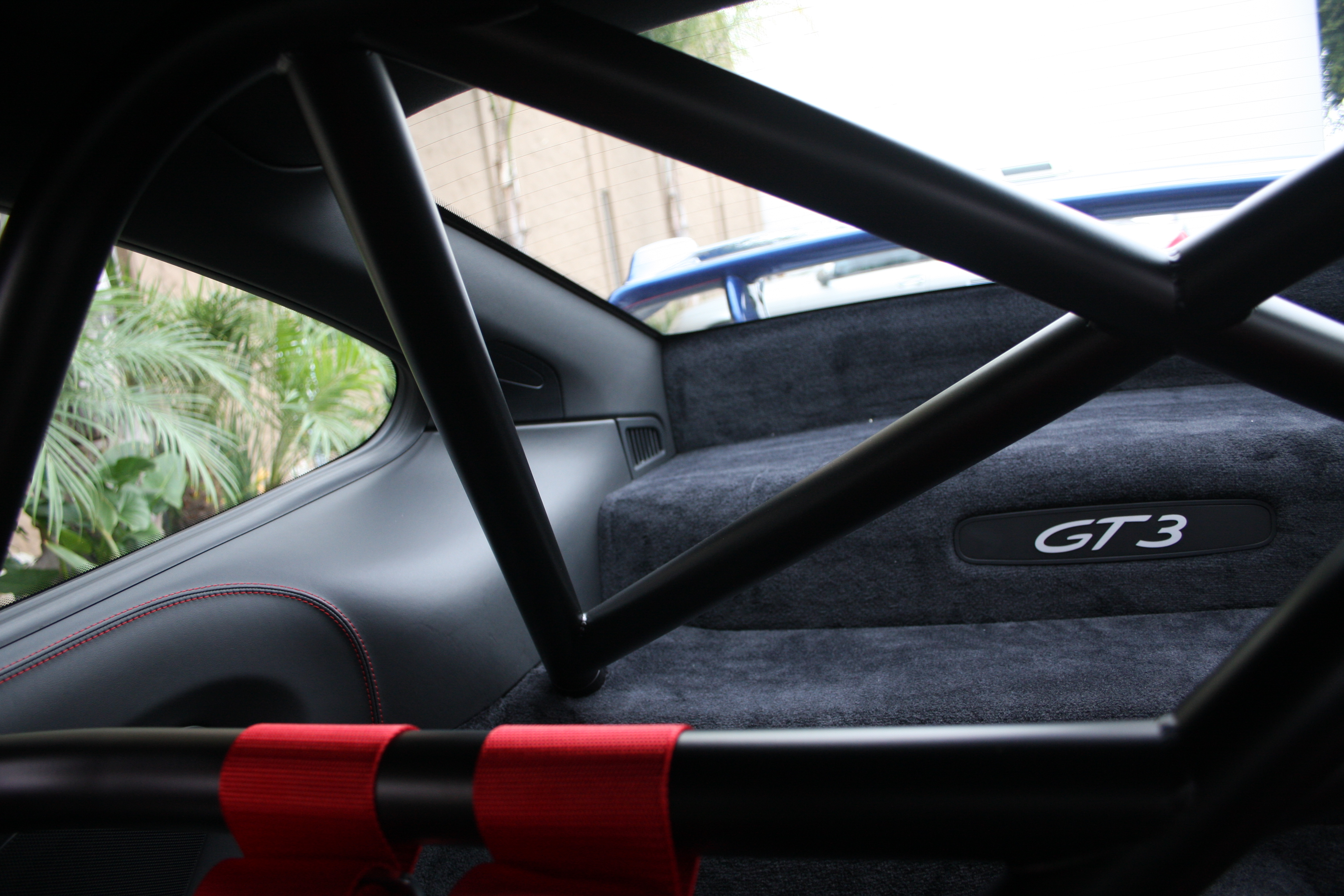

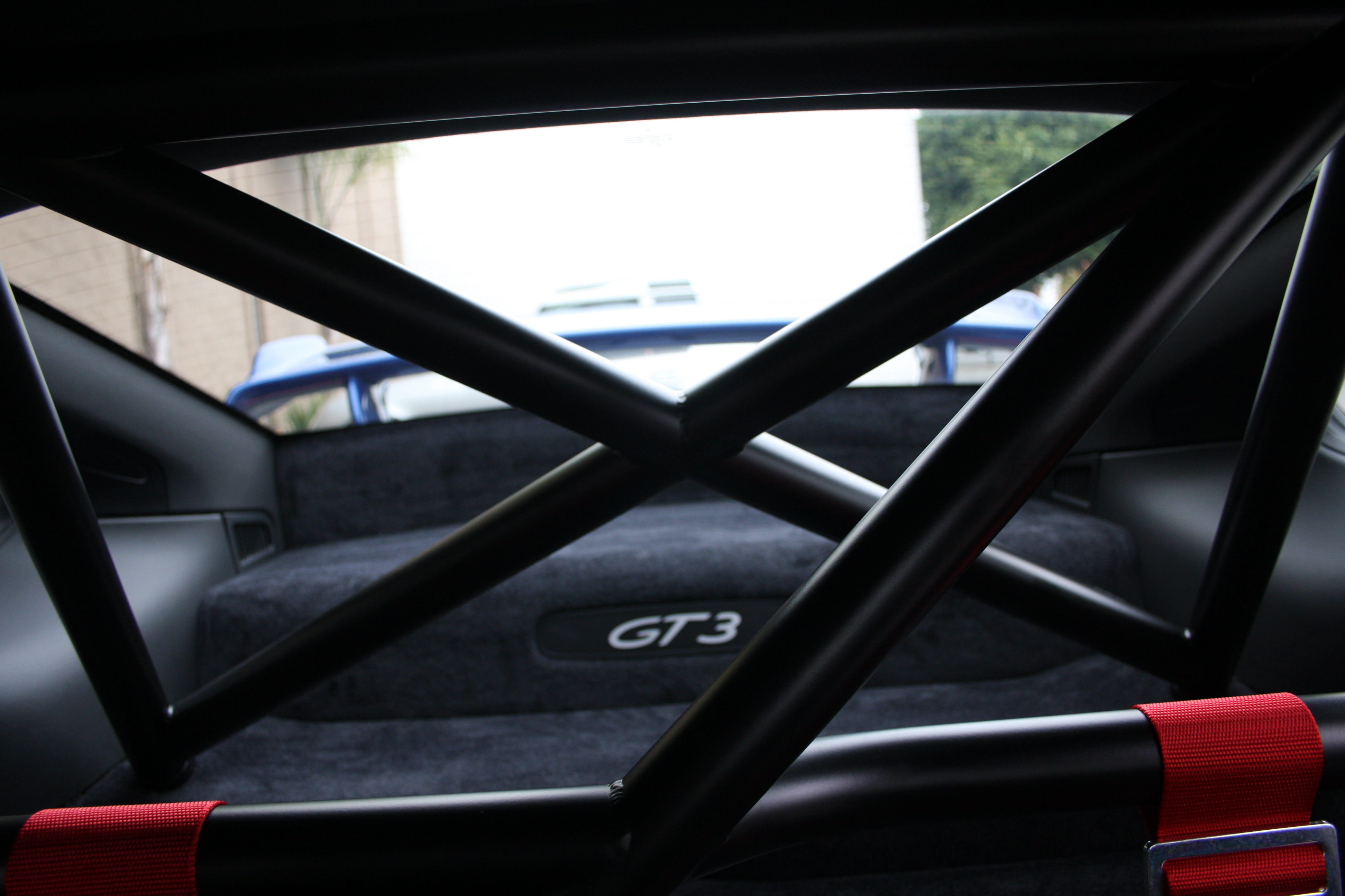

RSS Roll Bar and Harnesses: “RSS Competition 4 Point Roll Bar”
Part #931
• 1.75" (4130) chromoly tubing / .120 wall thickness / tig welded / heavy duty slip couplers
• Bolts through chassis with under-plates and mounts to rear shock towers
• Flawless fit to interior profile while retaining full function of most seats
• Available in a variety of powder coated colors or unfinished for custom color matching
• Note: Modifications need to be made on models with Bose rear subwoofer

Sweet looking ride. Having had the prototype of that roll bar in the "Gumbo", its the bomb. It's built like a brick $#!t house and offers some serious protection.
