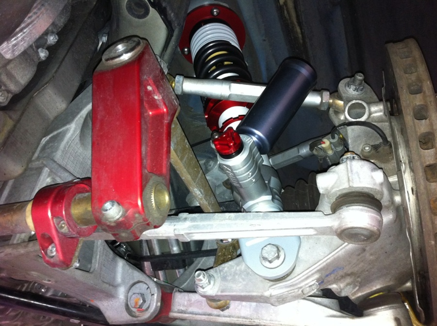

Originally Posted by firefisher
Mach01 stated he used the same size tires. On rennlist, different tire size may be a contributing factor along with slicks. It seems the slicks can cause particles to clog the ABS system sensors. The control system works from speed sensors at each wheel. These sensors can become deadened by brake dust and or tire particles causing them to fail to read the speed correctly or communicate the data correctly.
__________________
Those sensors are inside the carriers and unaffected by clag/dust/particles etc. Sensor lives where the black wire is coming out to the left of the brake rotor.
Ice mode results from a ABS software bug or accelerometer data spike outside of programming parameters (deceleration rate or whatever).
Triggered by different coefficient of friction and initial deceleration rate caused by slicks/oversizing of tires.
