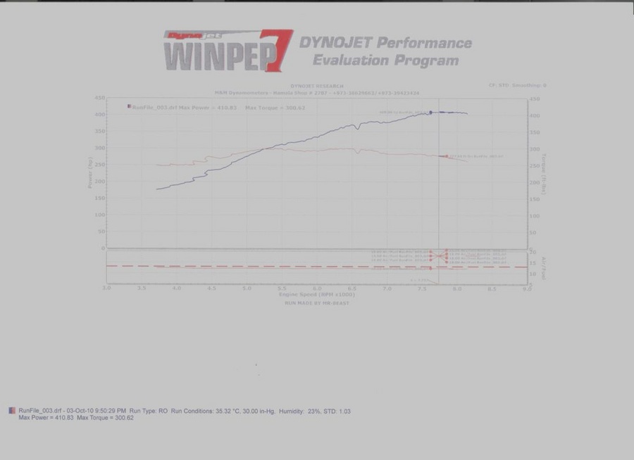

i was wondering whats the small hp and tq dip at around 6700rpm? i see you have a similar dip in your dyno sheet. i also noticed that your a/f is almost 14 where i am running 11.8 - 12.1 max
another run without car cooling down......

The 6700 rpm dip seems to be a characteristic all GT3 motors have. Even the 997.1 GT3 had them, I believe.
Not sure on the A/F... I was going to say, its probably due to the tune and high octane gas, but it looks like it was the same even when stock... I'll try to find out. Just added the condition of my dyno runs, in the last page.
It would be interesting to see your runs in SAE Vs the STD you posted....
This was the first dyno run done in my car (stock), in STD/93 gas, back when it only had a couple hundred miles:

ill have to go back to the dyno and print a new sheet with SAE correction, i called the dyno owner and verbally he told me that its 404-405whp SAE with 0 smoothing.
