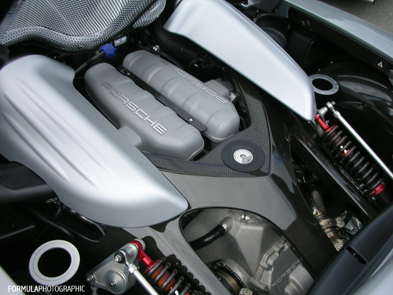

Had the CGT in for an oil change and battery replacement this week...Porsche of Nashville were fantastic to deal with !
I have attached a pic below of a CGT engine bay...on the bottom left you will note an air intake duct with an aluminum ring on it...obviously a matching one on the right too. These are held onto the piping end by an epoxy glue...on mine, the left was nearly completely off and the right was also loose.
These things flying around loose in the engine bay might be "problematic". Give them a tug and make sure they are on tight.

Had the same problem with my silver one. Both rings came loose. I think "lack of use" of the car will accelerate this problem. Easy fix but good to know. I was cleaning my engine bay and just touched the rings and they came off.
