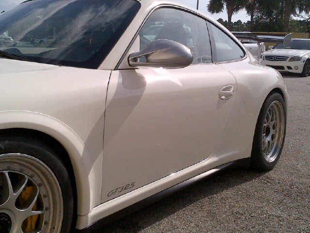

That's a nice wrap.

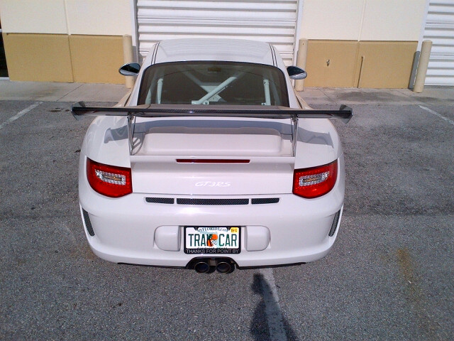

New and shiny. Different perspective.

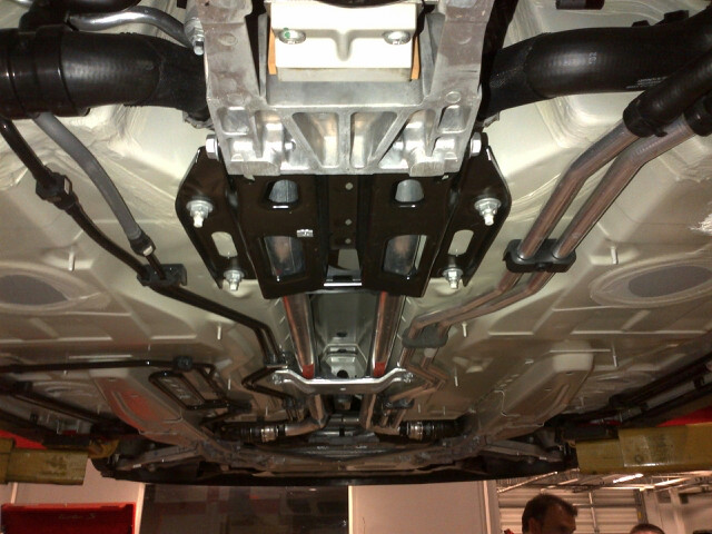

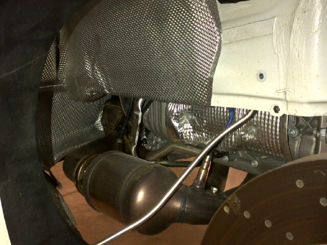

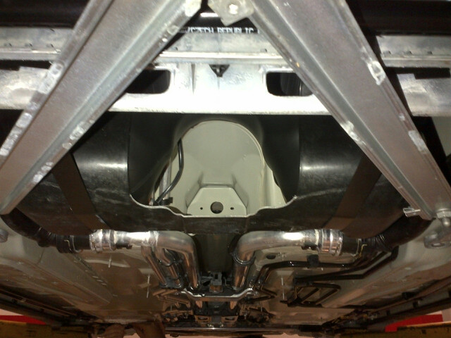

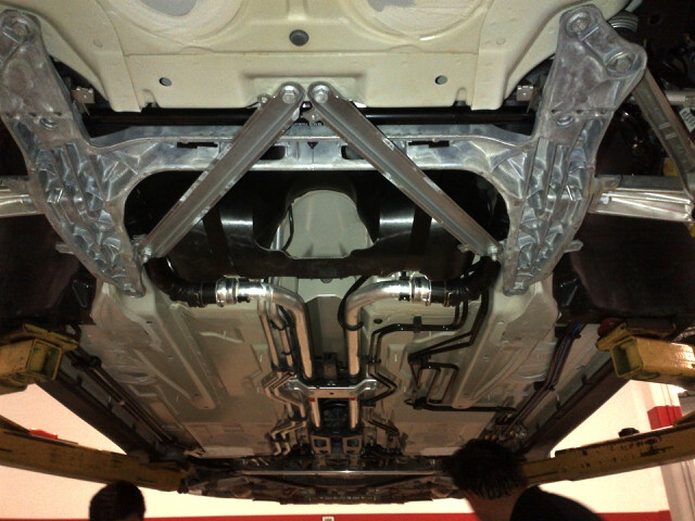

TRAKCAR can you plz explain the advantage of the side muffler delete over the center muffler bypass
Old Jun 27, 2012 | 09:06 AM
  #6347
TRAKCAR's Avatar
Joined: Dec 2010
Posts: 488
From: South Florida
TRAKCAR has a reputation beyond reputeTRAKCAR has a reputation beyond reputeTRAKCAR has a reputation beyond reputeTRAKCAR has a reputation beyond reputeTRAKCAR has a reputation beyond reputeTRAKCAR has a reputation beyond reputeTRAKCAR has a reputation beyond reputeTRAKCAR has a reputation beyond reputeTRAKCAR has a reputation beyond reputeTRAKCAR has a reputation beyond reputeTRAKCAR has a reputation beyond repute
It's lighter because you remove 30lbs and it is quieter then most center exhasut upgrades. Some tracks have very low Db sound restrictions and removing 30lbs off the rear you notice on the track only.
Mind you, for on the street I would still prefer the best sounding ever Sharky bypass. This I had before and I permanently unplugged it.
Side muffler delete does not sound as nice and you lose the function of the flaps that route the exhasut through the side mufflers (Obviously) but I had my Sharky permament unplugged so you don't have that artificial open and close sound of the flaps anyway.
If you leave it plugged in, you can quiet it down enough for most tracks with a center exhaust, but not all.

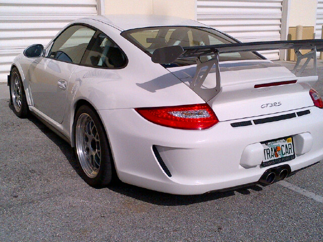

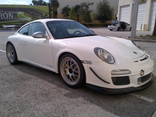

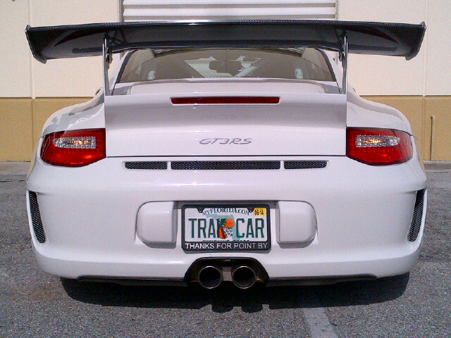

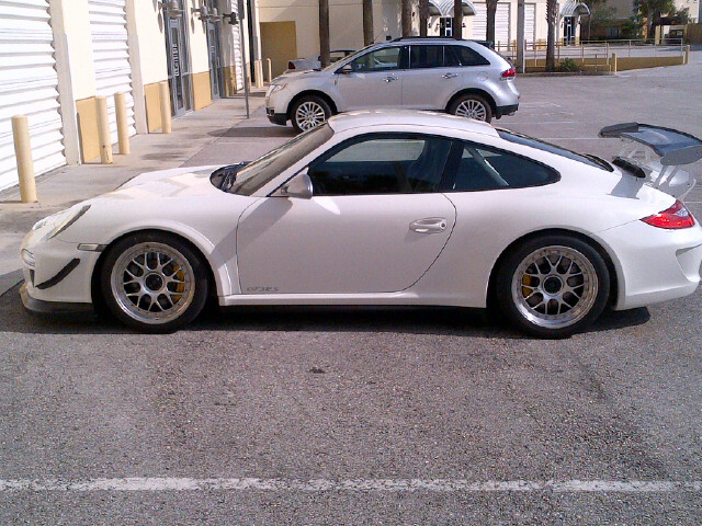

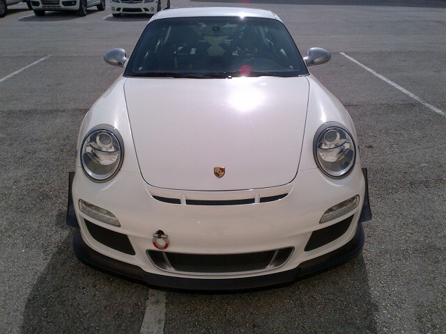

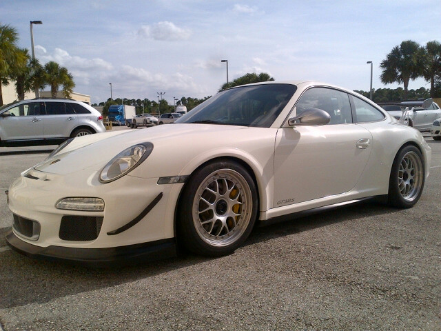

OK, pics:
Before: Porsche 911 GT3 RS Registry -- VIN ...3811 and the car came with a red roll bar.
After:

Those BBS wheels make it look just like a cup car

Thanks Peter, one more ques is the car louder unplugged than with sports mode on Or same?
And your car looks superb!

Thanks Mike. It's the "looking for sponsorship" look LOL.
