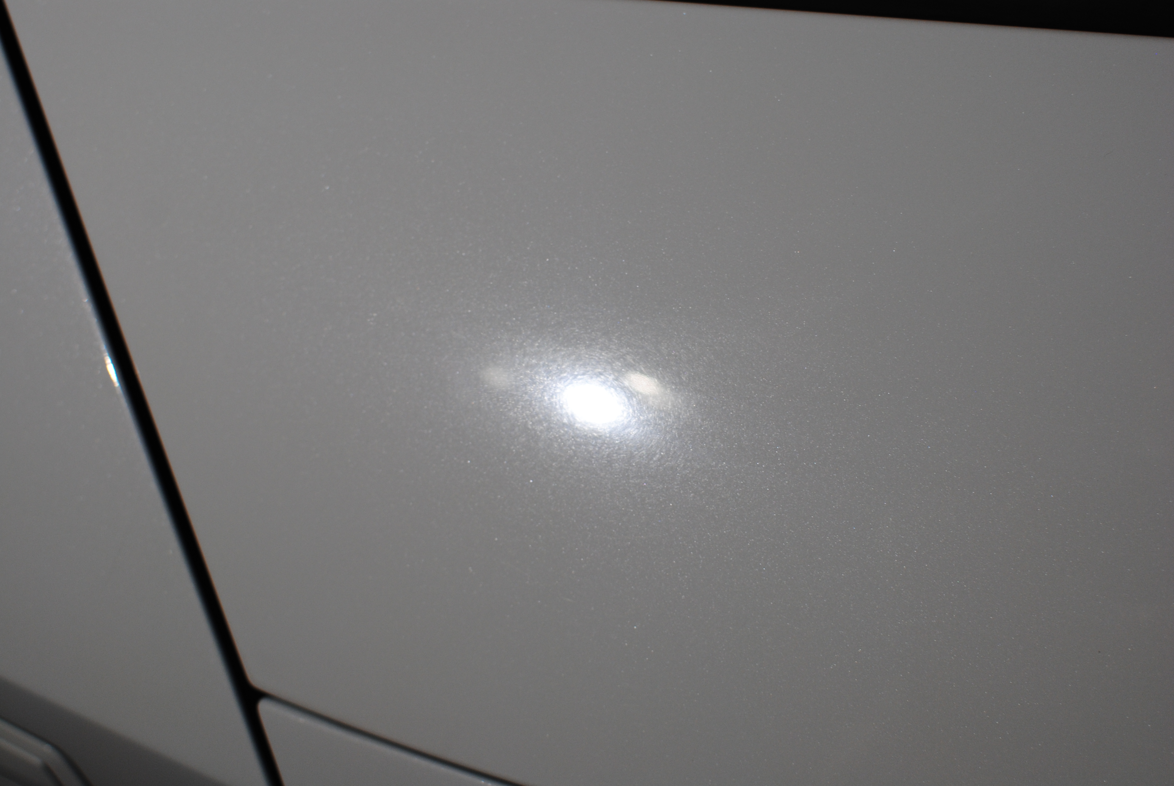

Clearing up the defects.
Whole panel now corrected of the sanding defects and polished down, beautiful flake now can show through.

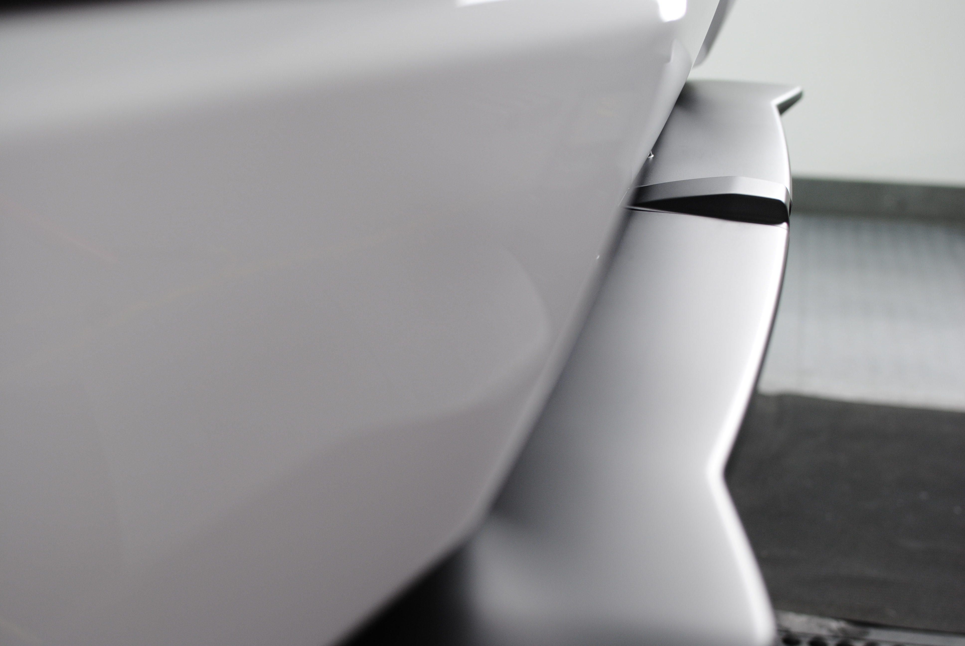

Matte painted rear diffuser cleaned up of streaks & staining.
