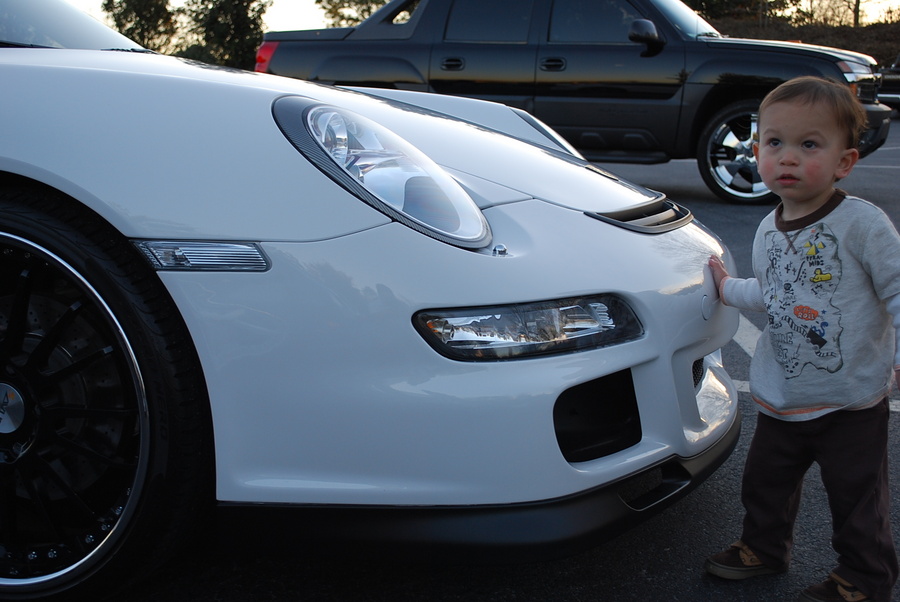

This little guy helped me clean my car but the wheels still need some work.
I have a polished lip on my wheels and I need to clean them. What products/methods would you suggest besides just soap and water. Also, is it safe to use a toothbrush to get into the crevices where the spokes meet the lip? TIA

No toothbrush......please!! The nylon bristles will actually scratch the soft polished wheels.
You need to use a soft wheel brush like the zymol or swissvax brush to first clean the wheels. Try to use a safe pH balanced wheel cleaner like P21S Wheel Cleaner, Zymol Wheel Cleaner, or Swissvax Wheel Cleaner.
Depending on how bad they are, you can do an initial polish with Menzerna Super Finish, 106FA. It's a polish designed for paint, but I use it on chrome and polished metals to clean and bring back the lustre.
Once you've polished the wheels, use Zymol Metall to further bring out the shine. This is what I do on all the higher-end details.
You can also do the steps mentioned above to clean tail pipes that are chrome or polished. Just subtitute P21S Total Auto Wash for the wheel cleaners mentioned above.
Hope this helps.
