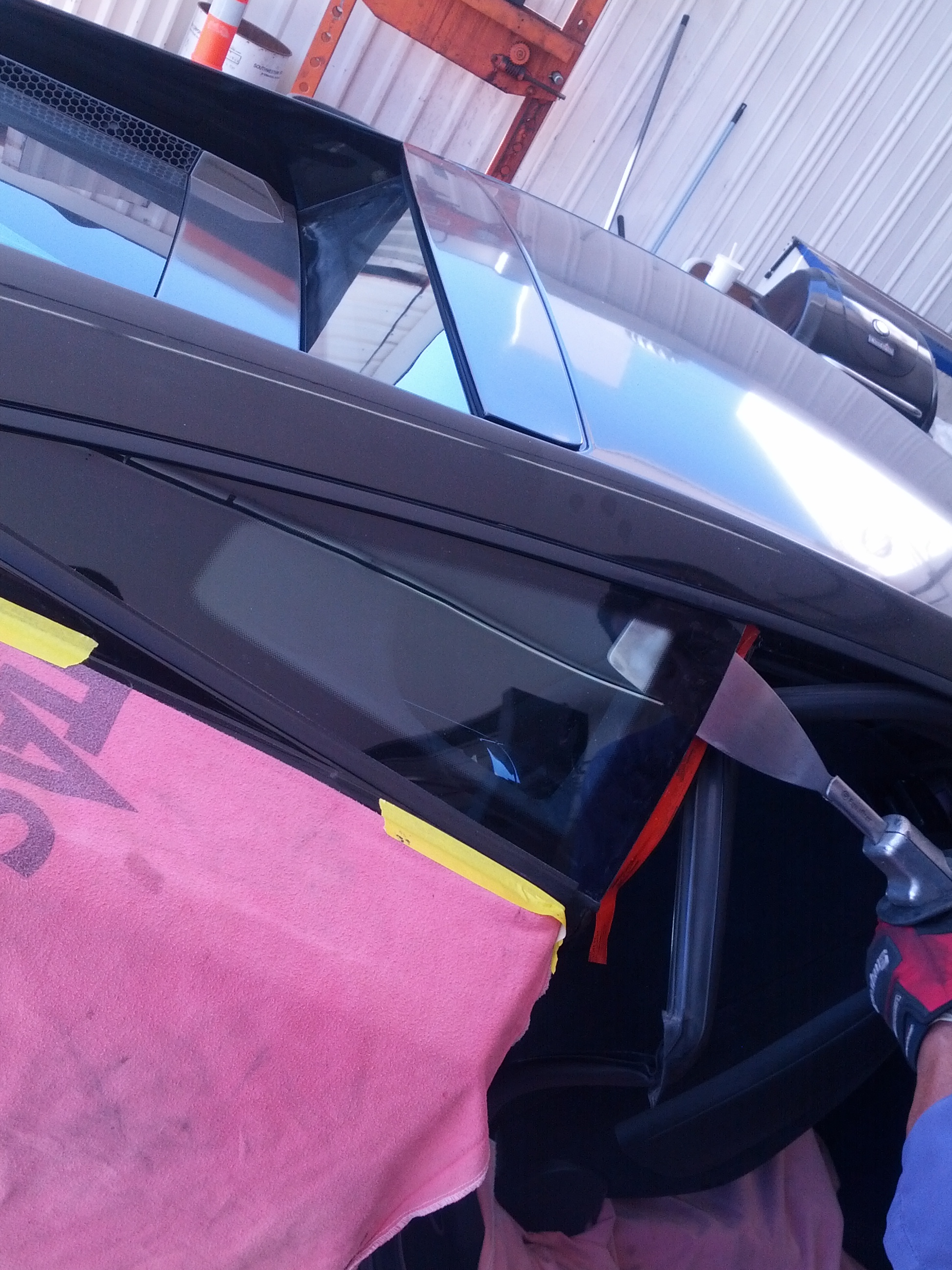

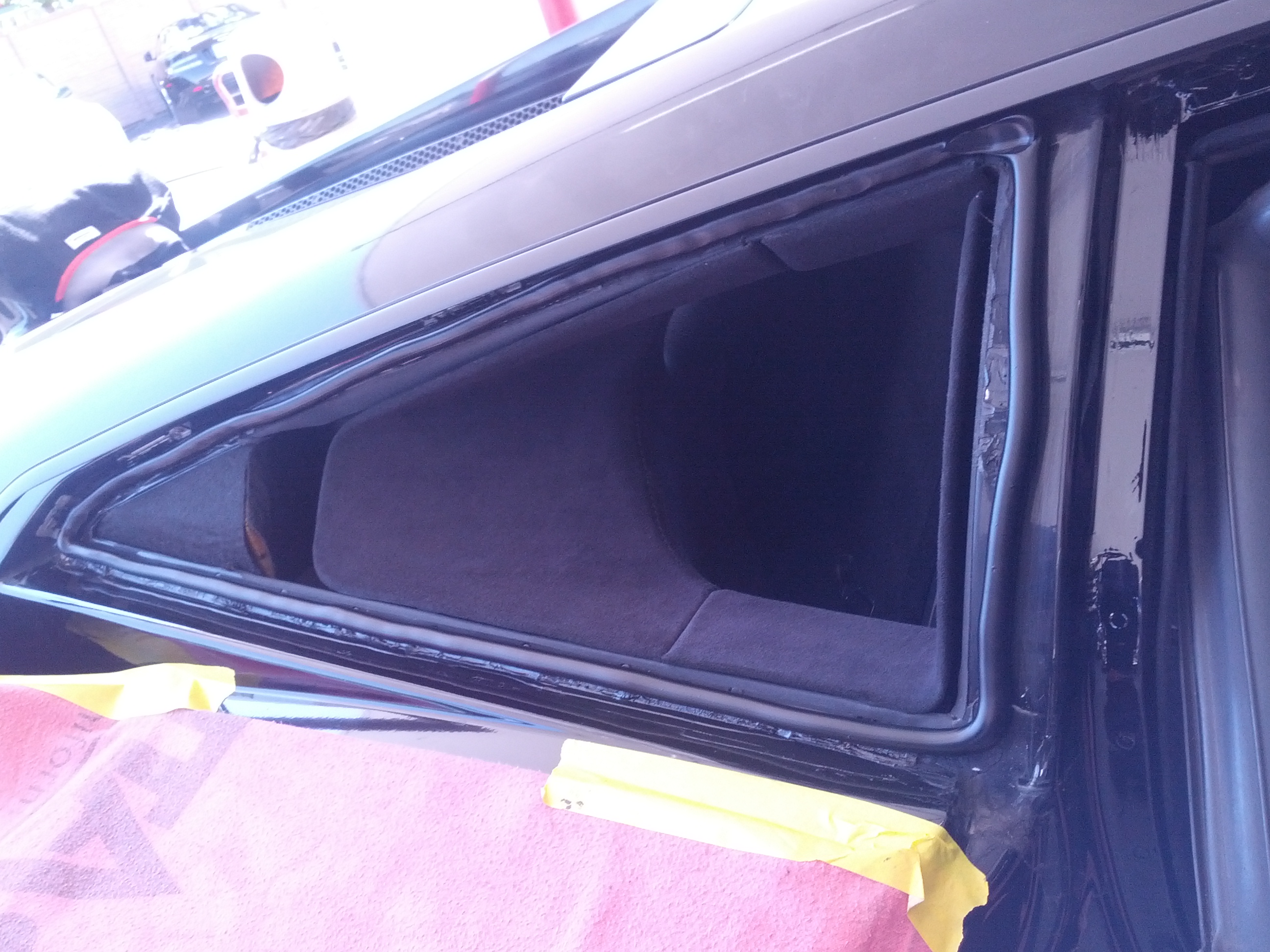

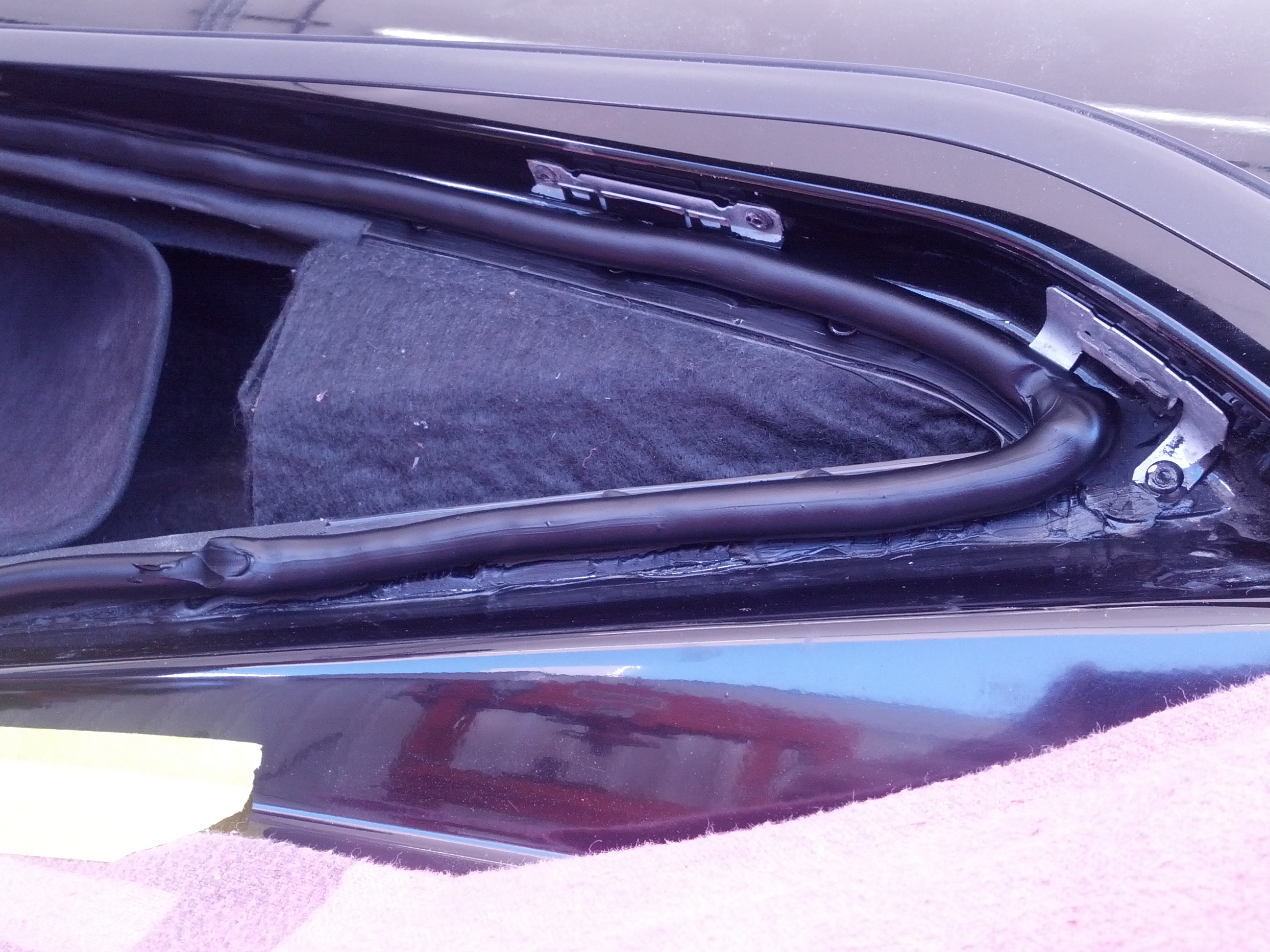

Since I was extra anxious about this repair job, I watched it
in person. As a result I have a ton of pictures. A few of them
are attached; if you find yourself in need of more (because
you face this same repair), then drop me a line.
