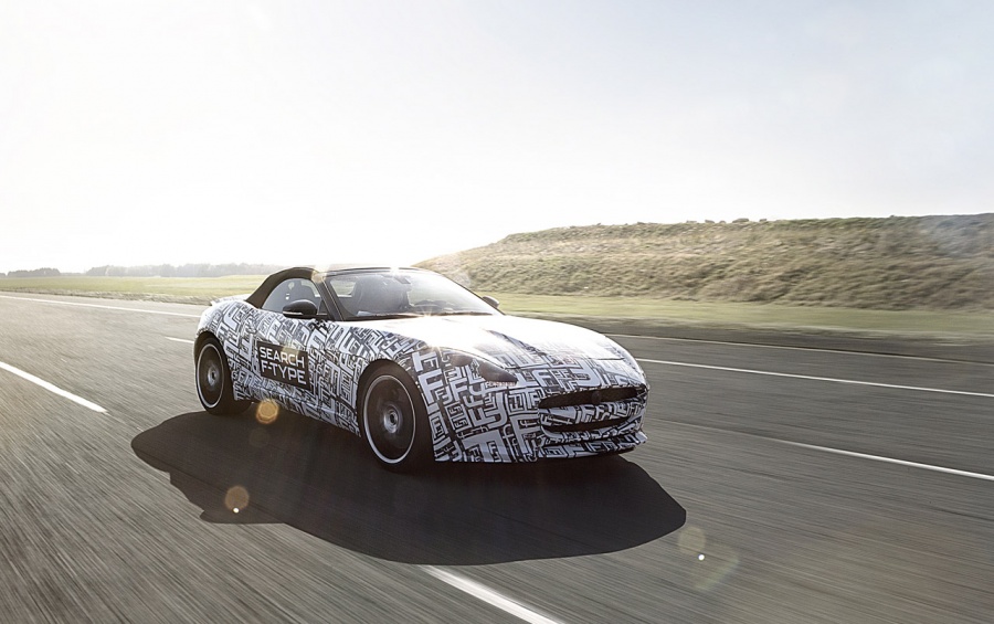

JAGUAR ANNOUNCES FUTURE POWERTRAINS
AT-A-GLANCE
• Jaguar will bring to market globally two new forced-induction engines; a Supercharged 3.0L V6, and a Turbocharged 2.0L in-line four cylinder
• These engines will be offered as choices on a number of Jaguar models in the future
• The Supercharged 3.0L V6 draws on key technology used in the Jaguar 5-liter V8. This engine will be available in two states of tune: 380hp and 340hp
• The Turbocharged 2.0L I-4 produces 240hp
• The 380hp version of the Supercharged 3.0L V6 will be exclusively offered as one of the powerplants in the forthcoming Jaguar F-TYPE roadster
• Both engines will deliver their power through eight-speed automatic transmissions
• The V6 will be available with Jaguar's Intelligent Stop-Start system
Introduction
As Jaguar expands its product offerings in key global markets, it is introducing two additional engines; a new Supercharged 3.0-liter V6, and a Turbocharged 2.0-liter I4, which will be offered as choices on a number of models.
The first announced utilization of the 380hp Supercharged 3.0L V6 will be the all-new Jaguar F-TYPE two seat roadster, coming in 2013. The Jaguar F-TYPE will focus uncompromisingly on delivering a rewarding drive experience.
