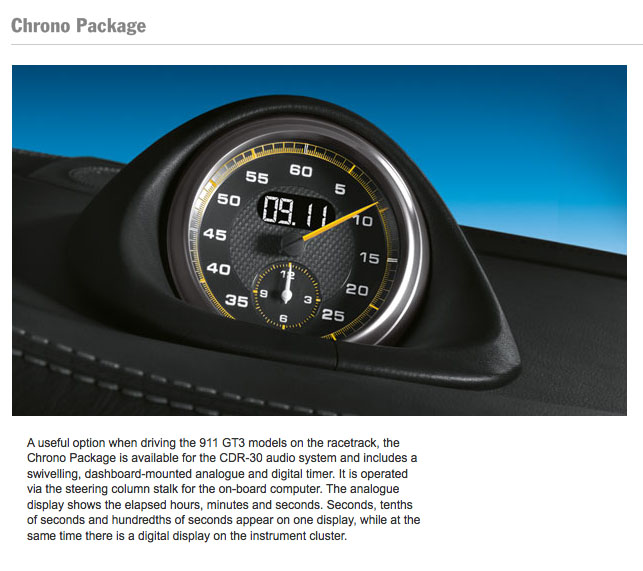

SPORTS CHRONO Plus
Hi Bags,
Any 9X7 vehicle can be ordered w/ Sport Chrono Package or Sport Chrono Package Plus...the latter meaning you have a PCM that allows for personal memory functions and the performance display. So if your concern is the actual performance of your car...you will not lose the performance capabilities of Sport Chrono Package, as the performance settings are controlled by pressing the Sport button.
With the PCM removed, you'll lose some personal memory functions that can be adjusted directly from the PCM (ie interior light settings & climate control) and the performance display for recording lap times for your Sports Chrono Package Plus.
I've attached a couple of pics from Porsche's site to clarify the SC Package &
SC Package Plus to help make sense of all of this. Would of sent a link but it's some kind of java script pop up window.

Loi T
Thanks so much for the info. You have given me what I was looking for. Being a 997.1 there isnt much fancy integration with the center display. They will not let me send you a PM since I have not posted enough so I have sent you a email.
Thanks again
