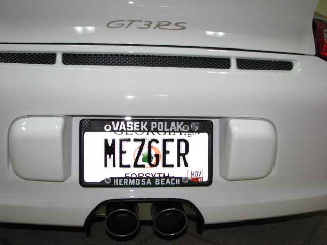

Originally Posted by brnsrgn
Correct the 3.8 is the new engine
I have an 09 3.6 TT, classic metzger split block
See below
