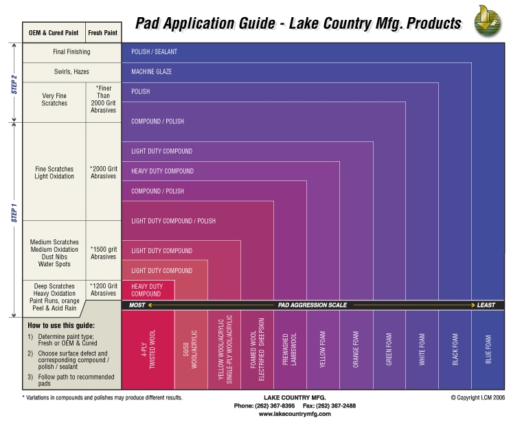

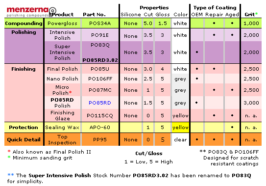

Originally Posted by kcturbo
I have been trying to get Moe to post some instructions for the #3 kit that some us us purchased. I have asked him via email, PM, and a request in this thread. Unfortunately all to no avail. Many of you here speak highly of him, but I am dissapointed in his lack of response. Anyone have any suggestions?
Moe's a busy guy, but believe me when I say that he's one of the best. Anyhow, to help you out:
1) Read through the Flex manual so you figure out what it's like to use.
2) Lake Country color-codes their pads. I've attached their application guide to this post. Basically, the orange pad is a light cutting pad whereas the white is a polishing pad. The chart breaks down where their "prime" point is. Since you have Menzerna SIP & Nano (106ff), you can match the SIP to the orange and the 106ff to the white. I'm really simplifying things here, but during a multi-step correction, you work your way down from most aggressive to least aggressive.
3) I've attached the Menzerna product chart for you to refer to.
There's a few good videos & articles in the detailing forum about polishing in general; look around and read them. Also, post a thread with photographs of your car & its defects to get some feedback on what way to tackle it. Should make things a LOT easier for you to get started.
Great resource Tom....Thanks.
