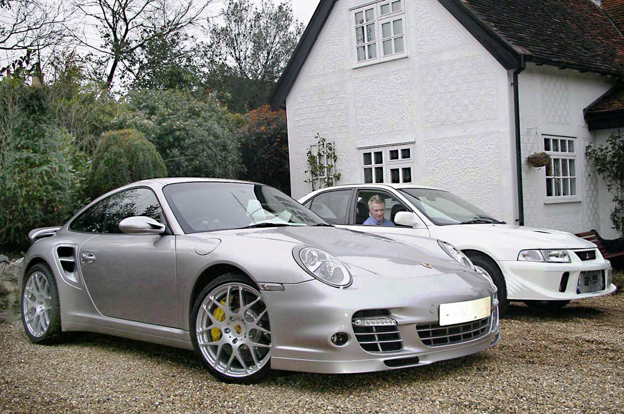

Car looks great!

What wheels are those?
Old Apr 3, 2008 | 04:14 AM
Alex_997TurboRSC's Avatar
Posts: 670

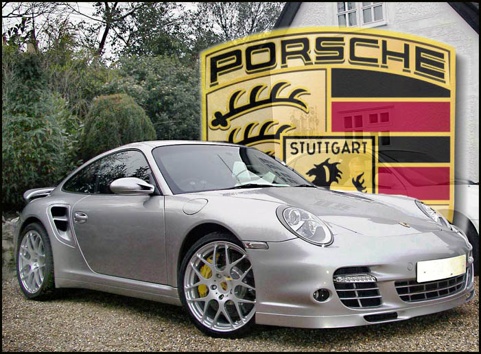

HRE P40's 19" in powdered silver
Hey DJ, thanks for covering up my unsightly brother!!
