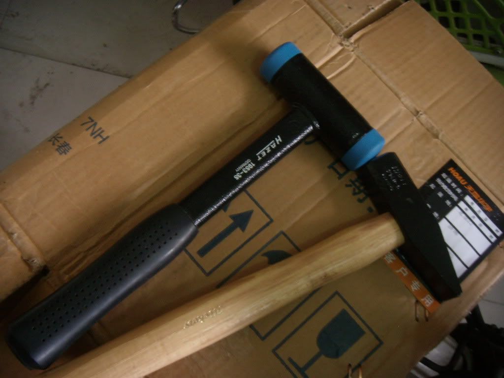

you need to order Porsche's OEM Running Light Removal tool
997 256 3568 001
Old May 25, 2010 | 03:19 PM
bbywu's Avatar
Posts: 254
From: Somewhere cold in Wisconsin
bbywu has a reputation beyond reputebbywu has a reputation beyond reputebbywu has a reputation beyond reputebbywu has a reputation beyond reputebbywu has a reputation beyond reputebbywu has a reputation beyond reputebbywu has a reputation beyond reputebbywu has a reputation beyond reputebbywu has a reputation beyond reputebbywu has a reputation beyond reputebbywu has a reputation beyond repute
Porsche uses Hazet tools...do the job right.

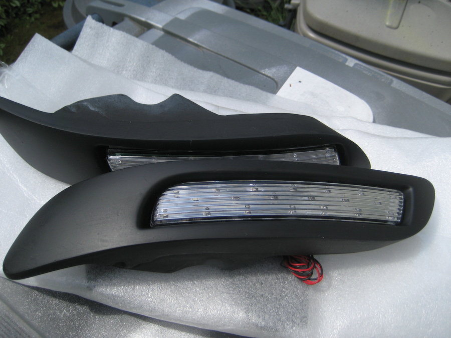

Sucess!!!!!
I got the 997 lights out with a credit card! Thanks so much SCHWABE and bbywu you smart asses really help me out
I Got the Running lights out in 30 seconds each
Just turned my fog light /head light dial to the fog light setting and saw the little light that came on ,2 wires ,wired it in no problem
will post pics tomorrow .NO BUMPER REMOVAL NEEDED this was easy
LED'S are a random order look with about 30 or so little lights .
IT LOOKS AMAZING !! Thanks again 997 threaders ,you guys rock
OH AND NO HAMMER NEEDED !!!
