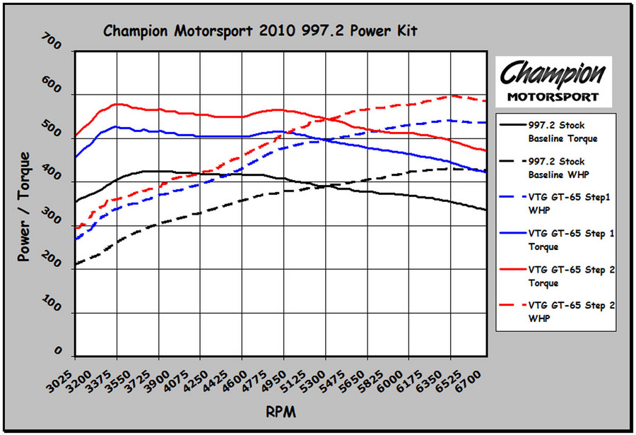

As you can see from the Graph that I posted, we made some very sizable gains in performance. Our baseline numbers on our 500 mile break in car came in at 431 peak WHP, and 425 ft-bs of torque. We are confused how
our numbers are so dramatically lower than other tuners have posted, as we all seem to be using Mustang 4 Wheel Chassis Dyno's, but we feel that these numbers are correct and inline with what Porsche publishes of the
standard car in regard to crankshaft measured power output. Basically, we do not feel that the car is over-rated from the manufacturer; it is just that great of a car..
In reference to the graph, what we plan to offer is a Step 1 Kit for PDK owners which will output 542 whp and 527 ft-lbs torque, and for Manual transmission car owners we will offer a Step 2 Kit producing 598 whp, and
579 ft-lbs of torque (clutch upgrade required and available). This is well into the 700hp range on pump fuel, without modifications to engine internals.

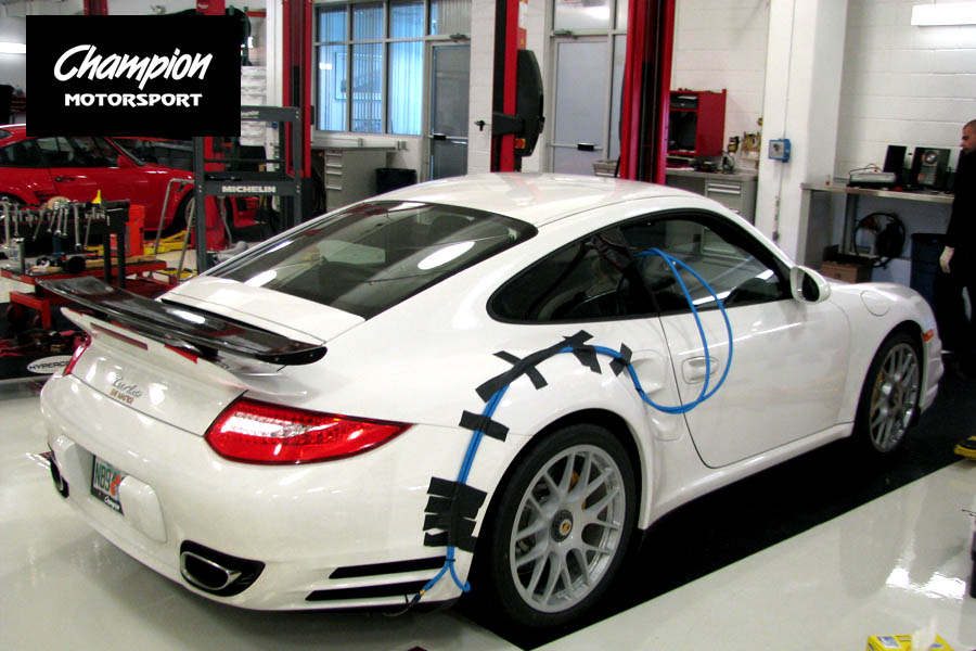

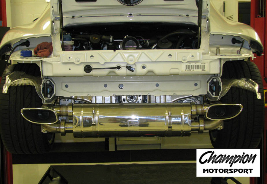

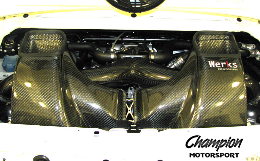

Photos of Development Car

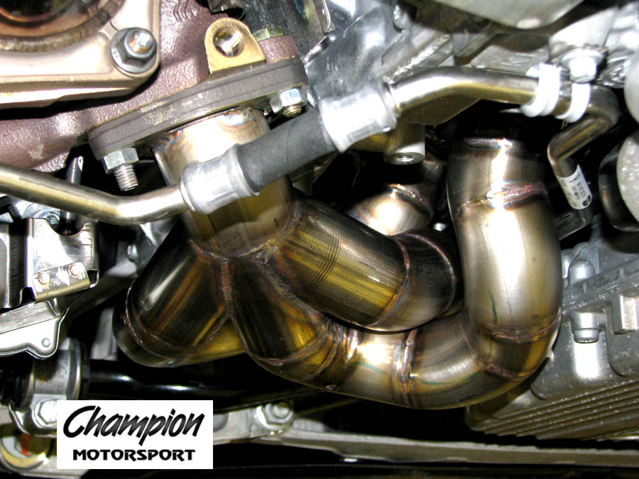

Manifold (header) development
