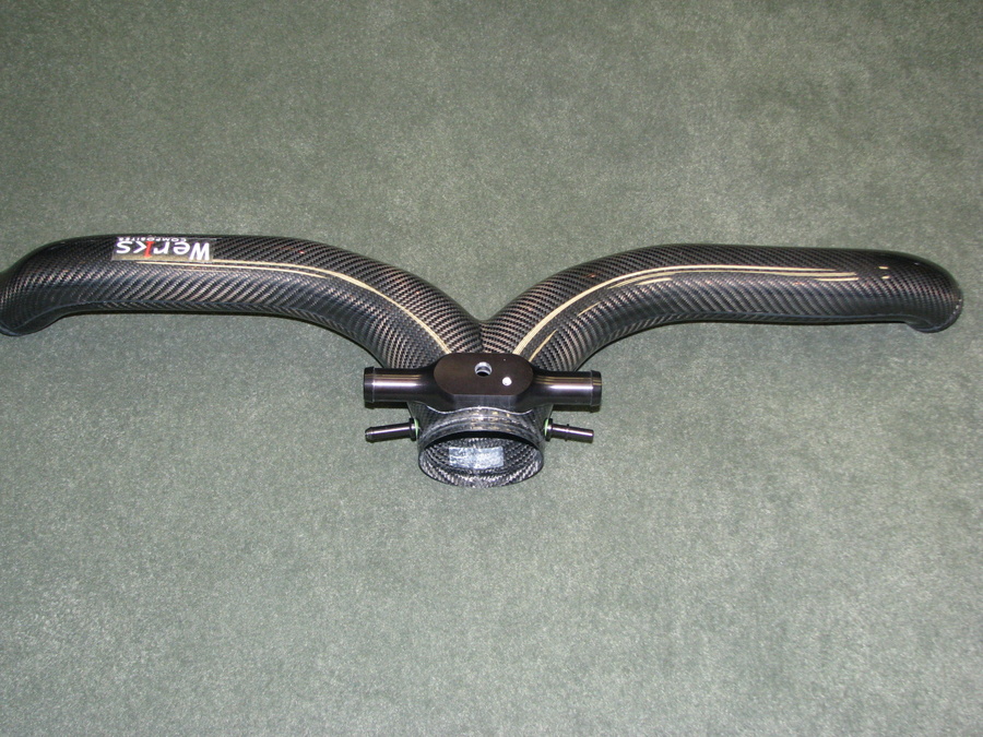

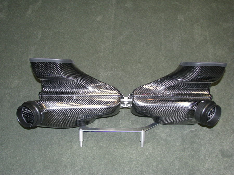

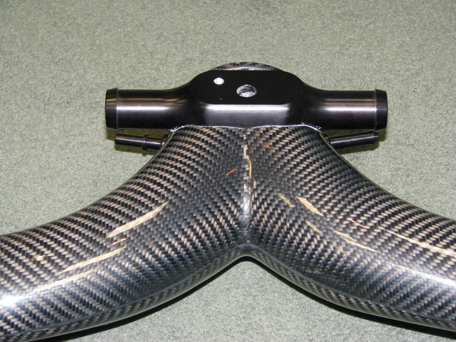

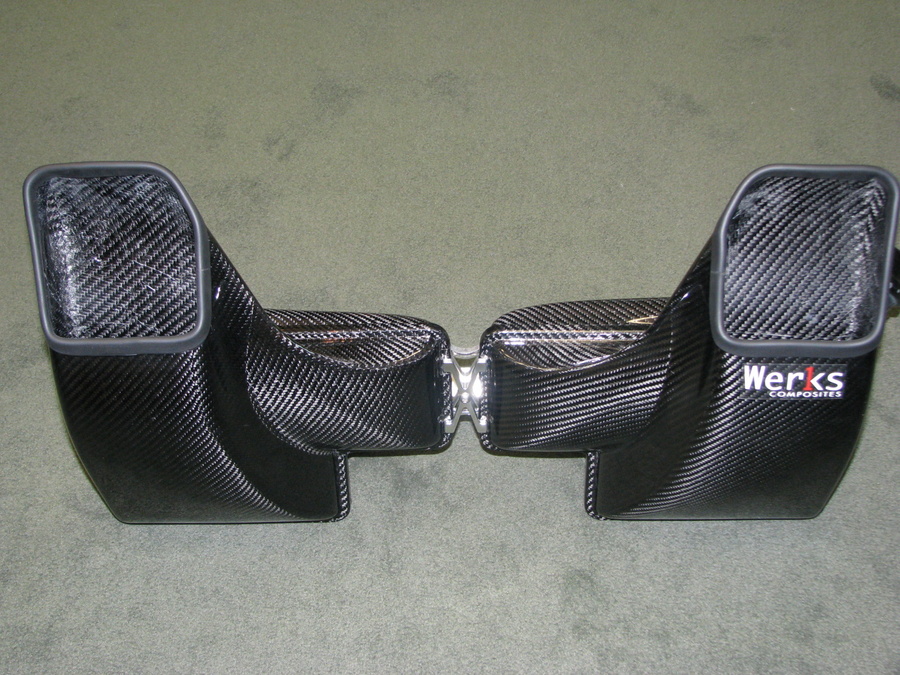

A few photos of the Werks1 Y-Pipe and Air Box for the 2010 997.2 TT.
The boys in the Carbon shop have been very busy.. These are not prototypes, these are production parts, going out the shipping door today. I managed to intercept these before they were boxed just to get photos of them!!
Thanks
