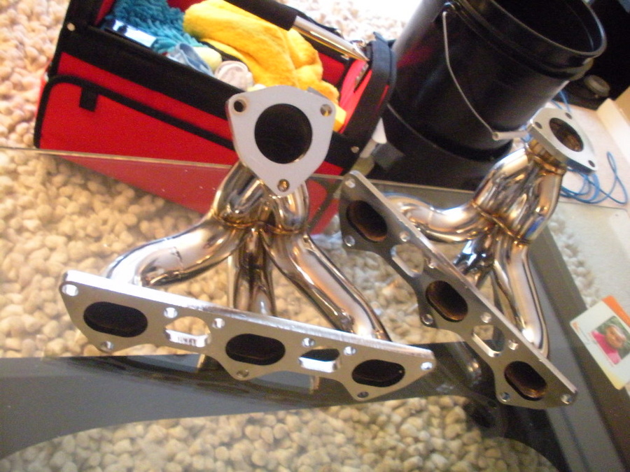

here are my headers just got em in.

Neenja, what kind are those?

there evoms I bought them half price by some guy on 6speed. I'm going evoms ECU,stage 2 clutch, bbi pulley/aluminum flywheel soon, so I figure headers would complete the package.
sorry to say, cheap China product.

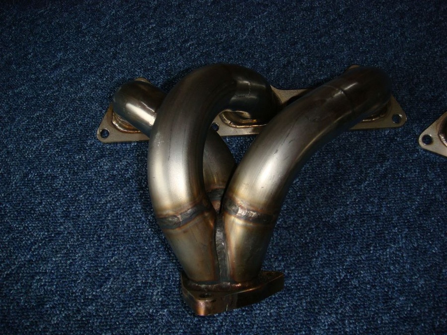

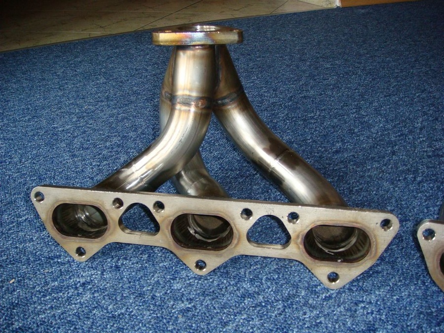

I was running with those made by German small company, 20 sets per year for one tuning company. I never have seen better quality, did I noticed the gain on the dyno? don't think so. Maybe performance headers are better for cool down the egt, they hanging lover then stock ones.
