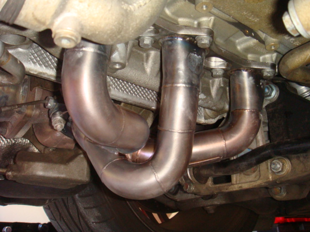

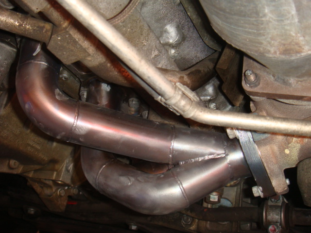

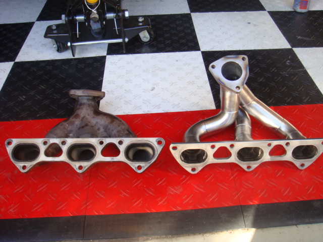

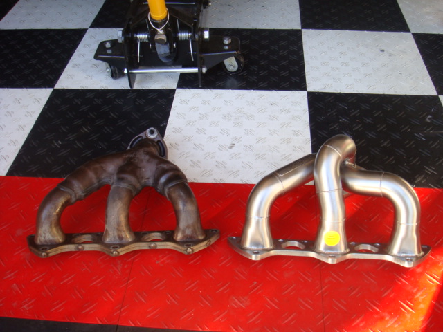

For guys looking for headers for their 997 TT, this is the result of weeks of research. (no affiliation to any brand whatsoever).

Ummm....those headers look longer than the stock ones....that does not equate to better performance from what I know. But they are shiny.
All aftermarket headers are longer and I think thats the whole purpose: to cool down the air a bit more, on the other hand a larger diameter is not good thats true.
